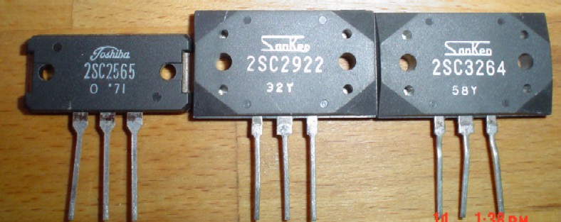

Only ones producing ringemitters were Toshiba and Sanken, production of high power ringemitter transistors started before Pioneer started production of the M25 in '79.
Later production Toshiba ringemitters had the identical MT200 casing and color as Sanken devices.

the matter is, if I get a broken M25 and need to replace output RETs, is there a possibility to get those or use Toshibas or Sankens ?
The ringemitter devices used in the M25 and A27 integrated amplifier were TO3 models.
Fat chance that you can find those, MT200 Sanken's will have to do.
Means redrilling the sinks with the MT200 pattern.

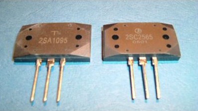

Pioneer used the big casing Sanken multi-emitter devices in the later M series power amplifiers.

These amplifiers have collectors value, and you would probably need 2 of the A-27 amplifiers to have enough output devices to repair an M25.
Fixing an M25 with modern Sanken devices will not keep the amplifier original, but a lot easier and big Sankens are very rugged.
