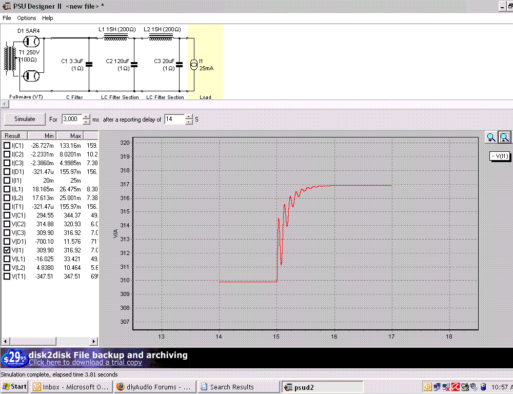

I have actually simulated with PSUD quite a bit. And, honestly, my real-world experiments do not necessarily sync with it.
First, my final stage in SY's model should actually be H=7.5H and C=40uF, since the L/R are in parallel. The Hs should be halved, and the Cs should be doubled.
As far as modelling, my performance with my INITAL PSU design looks quite decent in PSU:
5AR4 -> 3.3uF -> 15H (60R) ->20uF -> 7.5R (30R) -> 20uF

Anyways, the CLCLC with a 20uF middle cap shows dramatically lower ringing during a step change, a better voltage response on PSUD2, but a heck of a lot worse performance in real-life: dramatically more woofer movement. I actually REDUCED the woofer movement by increasing the middle C, which is non-intuitive if you model in PSUD2.
And, attempts to smooth out the ringing in PSUD2 by increasing the 3rd C have little to no effect on the actual woofer movement.
Hence my confusion on how to solve this problem. PSUD2 doesn't seem to relate to my situation.
