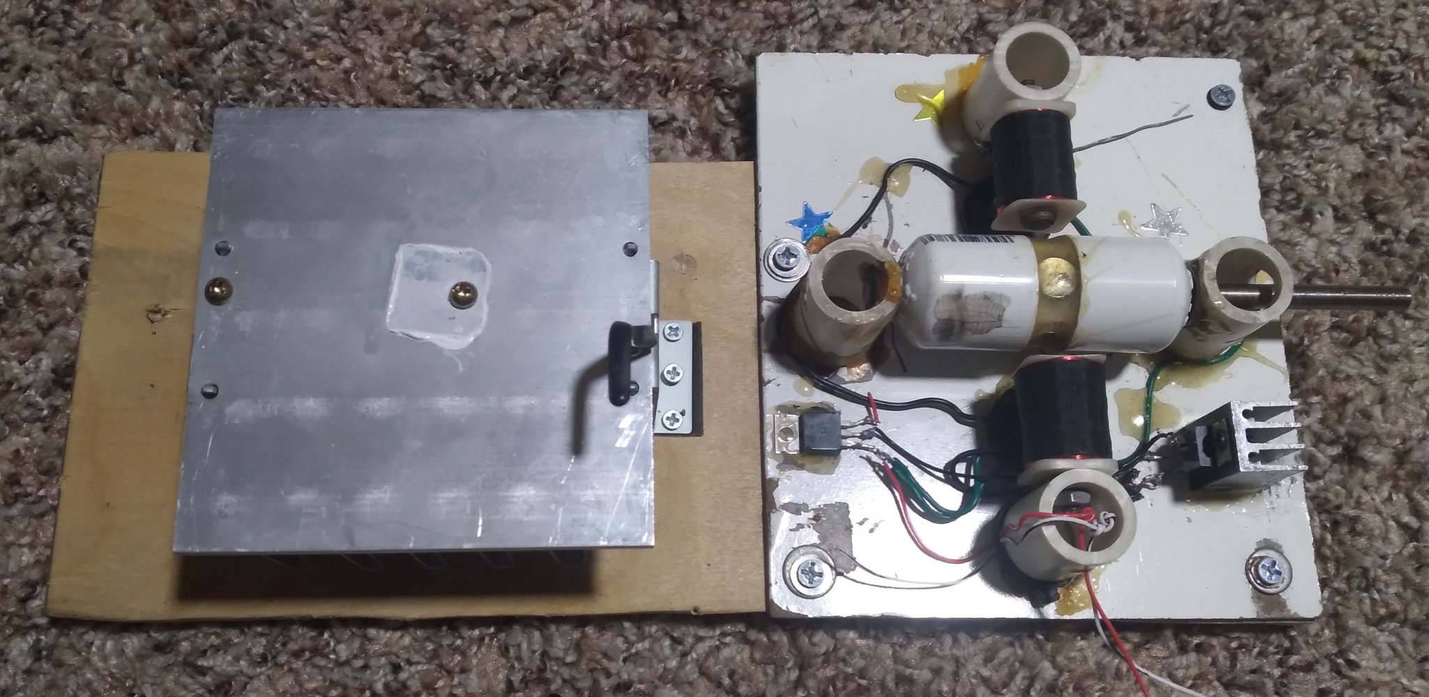

I have had the following motor kit for quite a few years now.
https://simplemotor.com/shop/motor-kits/kit-6/
I modded it to use an actual shaft, bearings and early on I learned the magnets tended to fly off the rotor at real high speeds so I used some neodymium magnets and epoxied them in place to where the epoxy is flush with the ends of the rotor.
Was a pain to properly balance the rotor so that it doesn't vibrate when running fast.

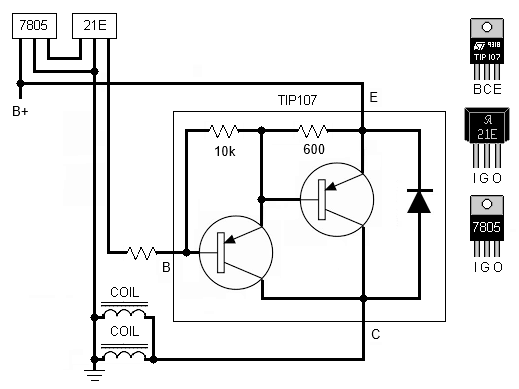

I used two 12 volt coils instead of the single coil and I used a 7805 to regulate the voltage to the hall effect sensor.
Here's the schematic.
Here's the motor.
The motor will increase speed until about 23Vdc and above that the waveform at the coil starts to have a higher duty cycle which tends to not allow any real speed increase.
Torque is not that great either, but it's fun to experiment with.
Currently I need to replace the hall sensor and transistor for it to operate. I could simply replace the parts with like parts, but there might be parts better suited for this application.

Four things I have questions about.
1. Is there a better hall effect sensor than the 21E for this application?
2. Is there a better transistor than the TIP-107 for this application? Perhaps a power MOSFET?
3. Is the 12 volt coil ok or would a 6 volt coil be better and would the coil type I used be best or is there a better type?
4. Is it better to have the coils in series or parallel?

The most fundamental things need to come first. You do not seem to have a diode for clamping the turn-off flyback voltage which would repeatedly avalanche the poor transistor, leading to its premature demise ...

The TIP-107 has a built in diode.

Wrong place for the diode my dear friend !! The diode needs to shunt the inductive load.
I tried a diode across the coil, but it just slowed the motor down.
It's ran several years the way it currently is though.
At one point I tried a neon bulb across the coil thinking it would light up when the transistor turns off and it never did so I removed it. I suppose that's due to the diode in the transistor keeping the voltage from going real high when the transistor turns off.
That is what is termed as 'avalanching' wherein a high blocking voltage (>VCEmax) causes a (commutation) collector current to flow ...
You may not see the neon bulb glow as the commutation would occur only for a short period of time ..At one point I tried a neon bulb across the coil thinking it would light up when the transistor turns off and it never did
Also using a scope to view the waveform at the transistor collector, I never saw a high voltage spike. Just saw a square wave which increased its duty cycle as the voltage to the motor increased and the motor started to run faster.

Are you suggesting that the two coils are coupled like in a flyback transformer ? Even so, the coupling can never be perfect and there has to be some leakage inductance and stored energy ...
Well then, all the best.. BTW, how many MHz is your scope ?
Why ? Did you place the diode with the wrong polarity ?I tried a diode across the coil, but it just slowed the motor down.
The one I used was at least 100MHz.
I placed the diode in the right polarity across the coil.
Think it has to do with how the diode affects the magnetic field collapsing.
I figured if the neon bulb didn't light up when placed across the coil then there wasn't any high voltage spikes to worry about.
I referenced a flyback circuit because it too switches a coil on and off, however a closer match for the circuit type is a PC fan which has a brushless DC motor.
Might be best to stick with the TIP-107 and just use a larger heatsink.

So revisiting the circuit I redid it to show the typical way with B+ and ground.
Here's the way I think the circuit might be improved.
After reading up on th hall sensor it pulls its output more negative.
So the previous modification won't work.
This is what I think will work. The schematic also shows the TIP-107 how it actually is.
Not sure what the resistor on the base should be though. The hall sensor has a built in regulator, but I am not sure what the output voltage is. I'll need to order the sensor then test it powered and hold a magnet to it just to see its output voltage. Once I find that I need to use a voltage divider calculator with the 10k base resistor, the sensor output voltage and the 1.4 volt base emitter drop to figure the necessary resistance for the base resistor.

Here's the motor with a larger heatsink.
I'll wire it up as it was originally so I can get the hall sensor in the best spot for optimum motor speed.
I'll then change it over to where the coils are in the collector and a resistor is in series with the base and see if that makes the motor work better.

Got it all wired up. Decided to leave it as originally wired given it works good that way.
The position of the hall sensor in relation to the magnets determines how well the motor runs.
The way the hall sensor is placed the motor will run on as low as 3.2Vdc at about 50mA running at 546 RPM with the motor driving nothing.
At 30Vdc the motor is still wanting to go faster, but I am limited by the 412mA maximum current the power supply can do. The motor at 30Vdc runs at 18,210 RPM with the motor driving nothing.
The RPM measurements are based on the formula (Hz x 60 x 2) / number of poles = no-load RPM
The number of poles is 4 given there are 4 magnets.

Here's a short video of the moor driving a fan blade running on 12Vdc. The blade has a very light pitch as the motor isn't very strong.
