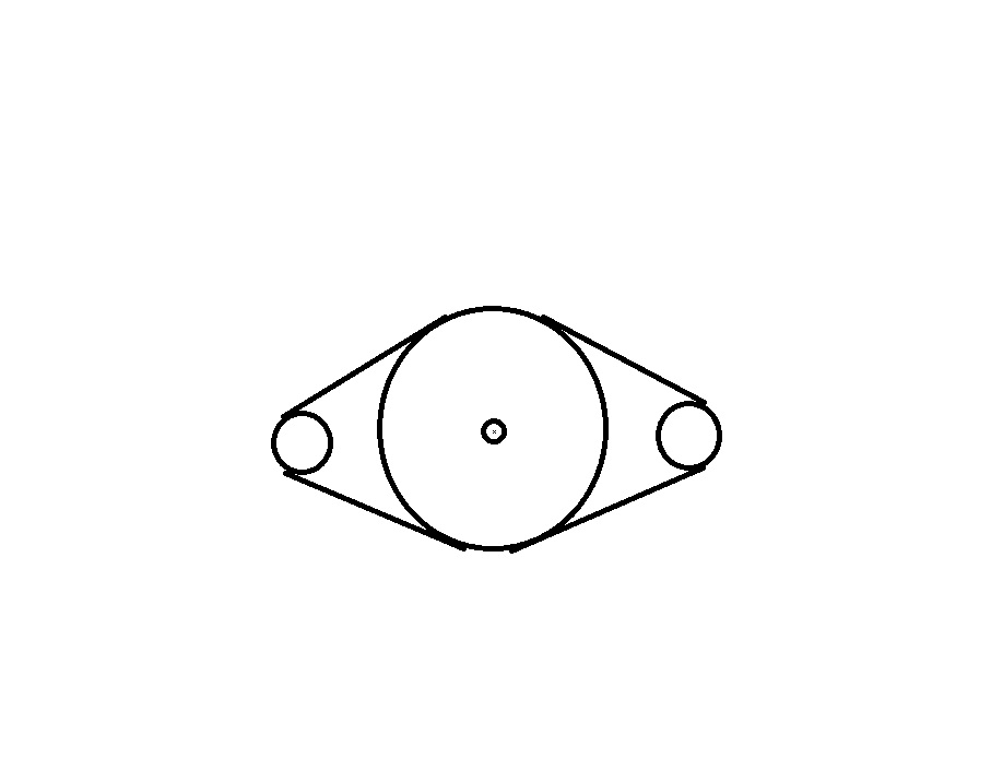

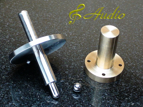

I didn't think the bearing housing and spindle were anywhere near long enough to offer decent sideways support
I'm trying to understand what you mean by "sideways support", and I can only assume you mean the way the belt pulls around the side of the platter toward the motor. If the bearing is a slip fit, how could it be a problem?
I was going to either have two motors (not likely) or use something like a "fly wheel" so the belt touches both side equally when rotating the platter.
See attachment. Not drawn to scale. 😉
In either case, a new bearing is easier to turn on a lathe than a platter.

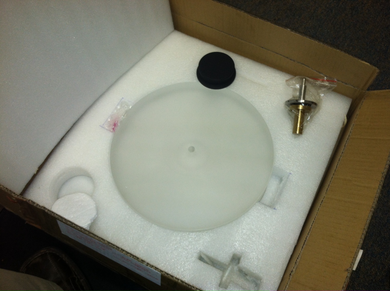

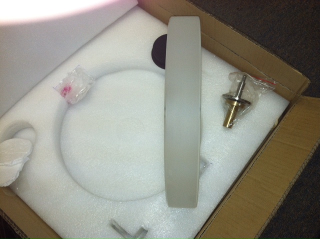

The platter arrived in the mail today. Well packed. Looks very nice.
I am told the platter is concentric to 1/1000th. The bearing is bigger and heavier than I thought it would be.
I picked up their 700g record weight. Also very nice.
Now for the hard part...😉

most of the plater is above the centre point of the bearing
I noticed that, but it's fine for what it is. The bearing plate goes in about 1/8 the depth of the platter. I would have liked to seen it go 1/2 way, like the Choir platter. That platter is $1000 more. For that money, I would just buy a VPI Traveler. This is fine for a DIY build.
Once spinning, it just keeps going. It's not warps and I'm happy about that fact. 🙂
