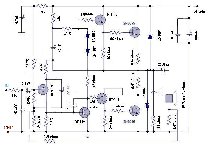

This basically a schematic of a simple (typical) Class AB amplifier design that uses current feedback instead of voltage feedback via the .47ohm resistor in series with the output load to ground and the 470ohm resistor going back to the input transistor.
It appears that the motional feedback section had not been implemented yet.

That's not the Philips MF design, just someone's imitation using a current-sensing resistor vs Philips MF sensor...

My Motional Feed Back Amplifier making sound like MOTORBIKE like THA.... tha... please help me
"Motorboating" is caused by spurious feedback from ouput to input. Clean up your layout and connection wiring, assuming the circuit is otherwise correct.
