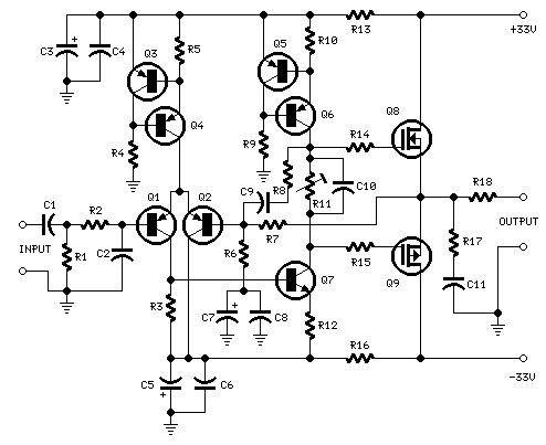

hello i built the 25W Mosfet amp of "red circuits" ... and i have some problems...
the amplifier works fine with 35ma of quiescent current, but when i set the quiescent current at 100mA the output transistos blows
i tried with IRF530 & IRF9530, and with IRF540 & IRF9540 and they blow...
with 35ma of quiescent current the amp works, you can play music at max volume, but the crossover distortion is horrible at low volume.
when i set the quiescent current at 100ma only the output transistors blow with a low input singal.
if someone can help me...
my ps is a toroid 300VA, and the output volage unweight is +39 and - 38.9.
the voltages weight (With 2 x LM3886 with 8ohm load each) is +/-36.5
I think that the problem is in the output transistors...

this is the schematic...

.....or maybe you don't have the transistors on a heat sink? or no heat sink grease or other heat conductive substance like sil-pad.

With vertical Mosfets, you need a biasing arrangement with a transistor (Vbe ) or diodes , in direct thermal connection with the heatsink and you must use source resistors.
For your simple biasing circuit ,you must use ,as Alex have already told you, lateral ones.
Only lateral mosfets have negative temperature coefficient at about 100 mA.

Ivan, I agree with tube dude about needing thermal compensation. Even one diode in series with R11 and mounted on the output heatsink might work. You didn't say whether the bias on the outputs ran away or stayed at 100mA. How long does it take at 100mA bias for the outputs to blow? If they blow immediately it might be oscillation. You might need to change the value of C9 to stop it if this is the problem. I had this problem with my amp when I built it. If I increased the bias above a certain level it would oscillate. If I didn't have a light bulb in series with the transformer primary I am pretty sure I would have lost the outputs too.
It will probably help to use source resistors on the outputs for improved bias stability also.

Hi ...
i set the bias current with the input shorted and everything seems ok, ... the transistors blow with a small input sing ...
with 35ma the amp works very very weel, exept for the distortion at low volume...

Ivan, that sounds like oscillation to me. If it will idle at 100mA's steady for a period of time until you apply a signal your bias is stable. The distortion you hear at lower bias levels is probably caused by oscillation not crossover distortion. Try changing the value of the FB cap.

The schematic is not suitable for vertical/hex/trench MOSFETs, only for laterals as is specified in the (often copied by the 'broken telephone method') original.
Actually, a Vgs multiplier (similar to the standard Vbe but done with a MOSFET) is the most natural way to do this. An IRF510/610/520 etc is just fine for that, even a 530 will do.
No you dont, unless you use several pairs of MOSFETs in parallel, and even then you might get away with not using them if they are carefully matched. Unlike BJTs, even vertical MOSFETs have fairly low gm so source resistors are not needed for thermal stability when you have a thermally coupled bias generator. Especially if you use a Vgs multiplier to bias them - then they are not desirable at all, as it will overcompensate. In fact, even certain types of output BJTs don't need source resistors when a single pair is used (but thermal coupling must be exemplary).
Exactly. They also have a much lower gm (simplified: gain), which has consequences when chosing bias current vs propensity t oscilate, in such simple designs. Still, with MOSFETs in general, layout is crucial.
As said above, not necessary. in fact, may be detrimental if the resistors are inductive. Putting 1 ohm in the sources will signifficantly lower gm and will 'blunt' the effect of wrong temperature co-efficient, but the result will still not be close to a lateral MOSFET and the problem, though attenuated will remain, for the price of signifficantly increased loss of power.
