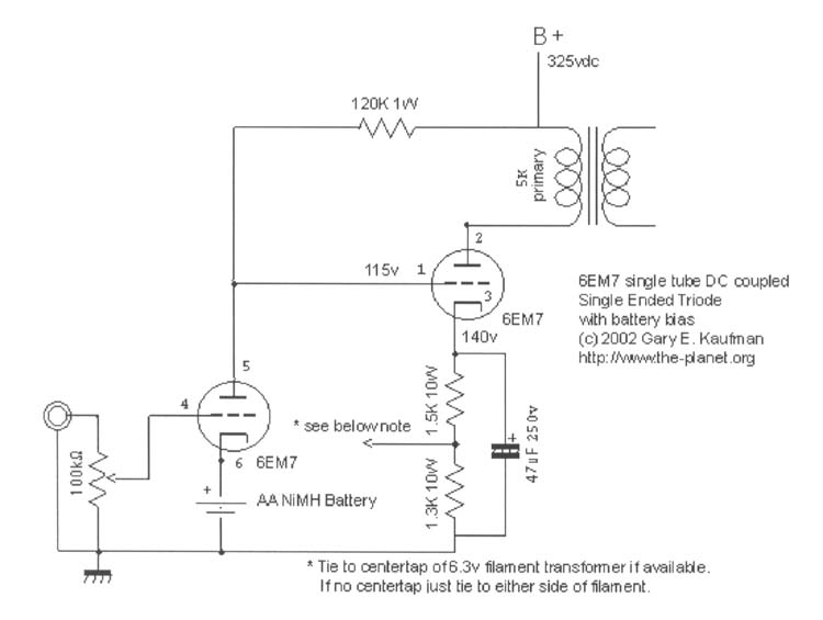

How about Gary Kaufman's 6EM7 SET. Simple, cheap, one tube (envelope) per channel and probably very nice sounding as the 6EM7 is a peach.
Or even simpler (set it and forget it), use a resistor in place of a battery.
I don't have a ready schematic but ... *digs through schematics folder* ah what the heck. I'll cut it for 'ya:
Tim
