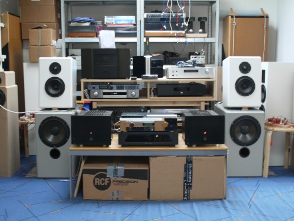

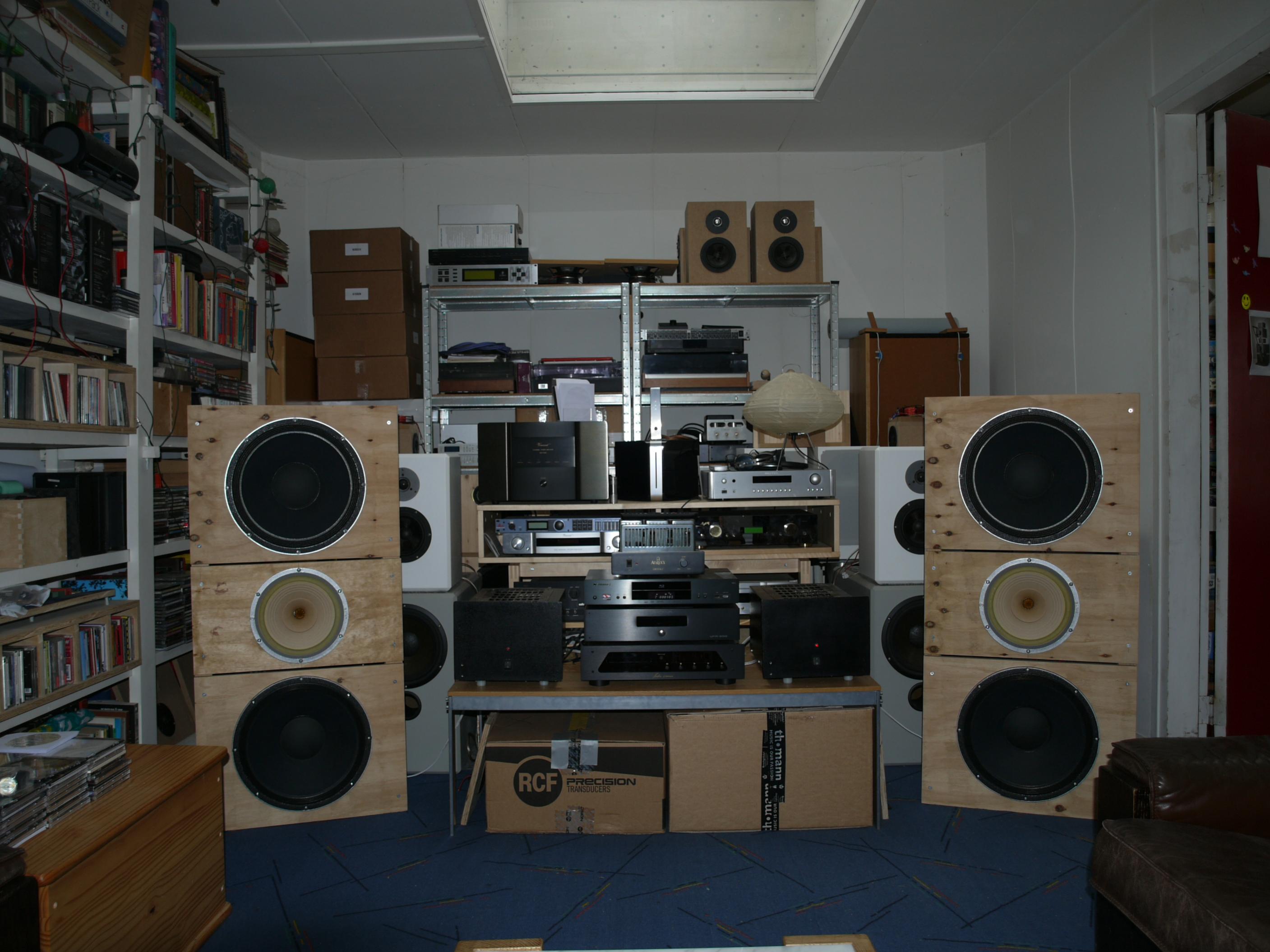

The Crystal 10 by Lii Audio belongs in my top 3 !!
I have them now running for several weeks and last 2 days I spend comparing them with another set.
Been listening to 2 sets last week.

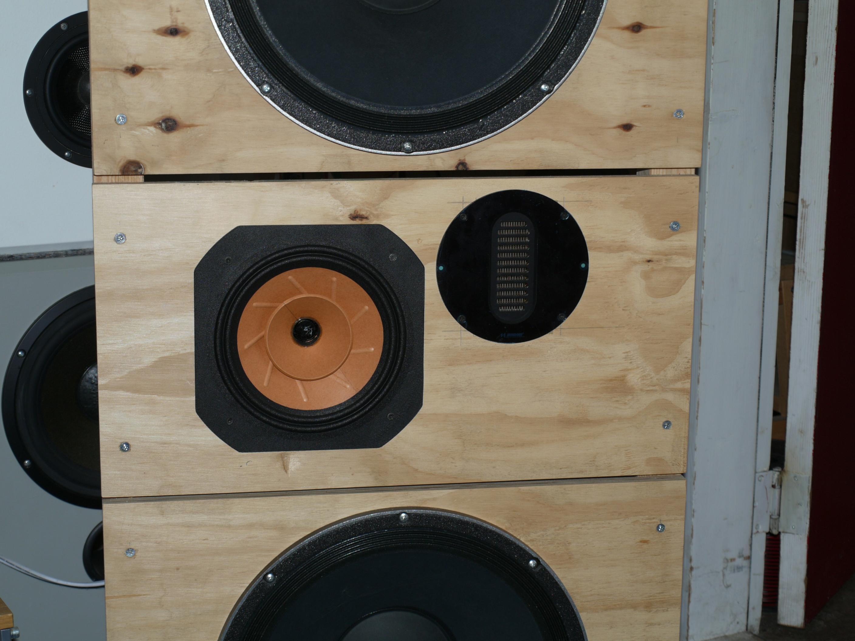

3 way with Morel Supreme tweet , Carboncone mid and Eton 11 inch. This set is very happy with my Zappulse amps 🙂
Second set is Lii Audio Crystal 10 in a TQWP with a contour.
Running with a Musical Fidellity A120 amp.
Wel : there is NO winner here !!
If you think the Cristal 10 is expensive ?
When looking from this side : it's very cheap !!
For next week : my PAP Neo 15 set with Aurel Bryan 8 and Mundorf AMT ?
Have fun you all out there.
For my Leonidas XO for PAP , I used many Fr drivers. This one was a complete possitive surprise 🙂

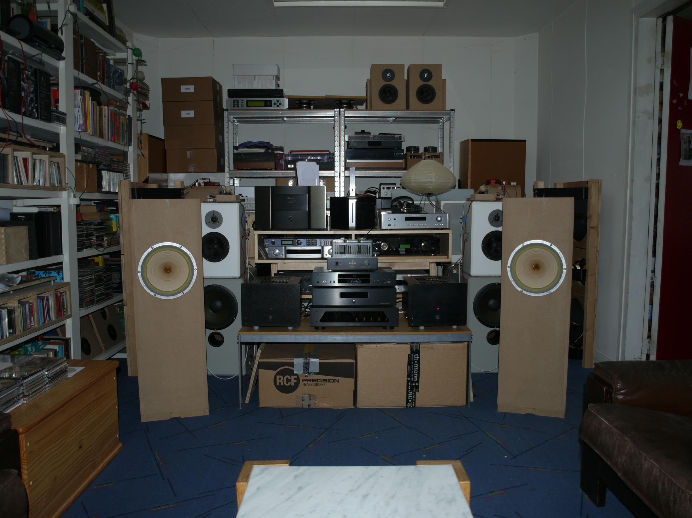

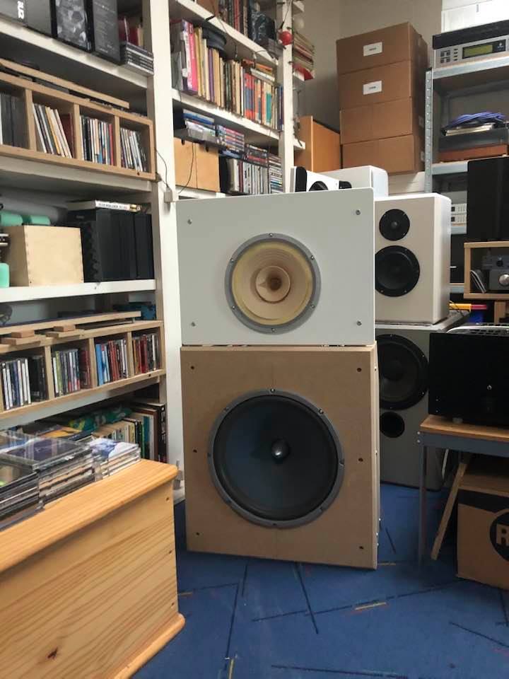

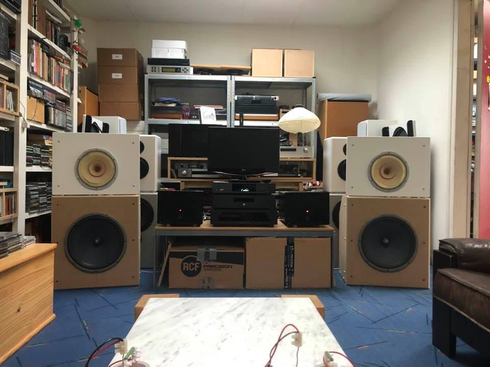

At this very moment my Crystal 10's are in the Liionidas Open Baffle.
If not , I would have invited you over to listen to the TQWP design.
