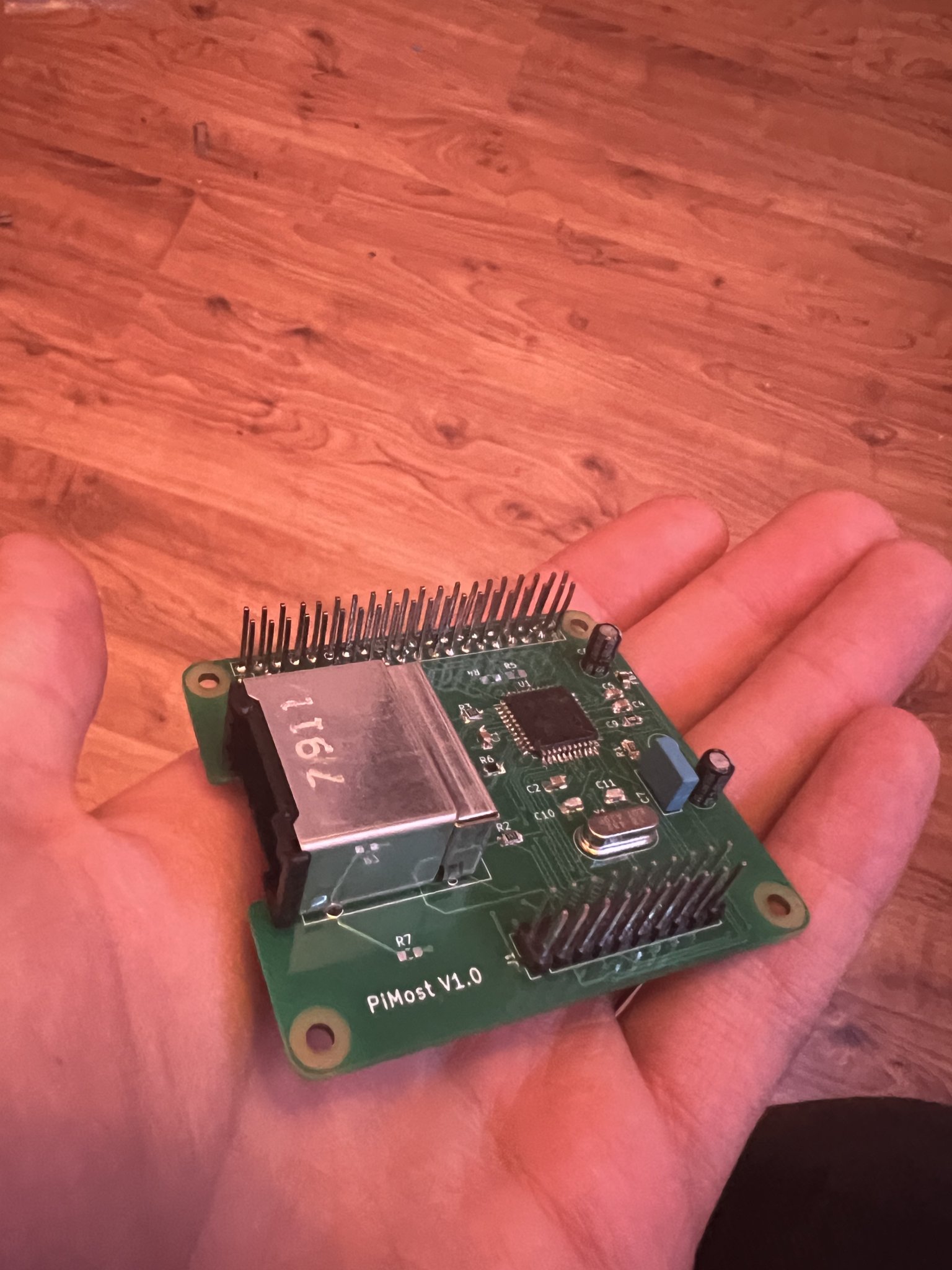

It started with a hacked up breadboard with a repurposed os8104 and MOST transceiver, then moved to a v1 of a custom PCB.
This one was very much experiment, but it worked, so I started writing the multi layer drivers for it (all written in nodeJs at this point)
Using the breakout header at the bottom I managed to get audio injection working using i2s from the pi. The beauty of this is it doesn’t use the awful clocks on the pi, but rather the clock source comes from the MOST network, running at 48khz on the jlr brand.

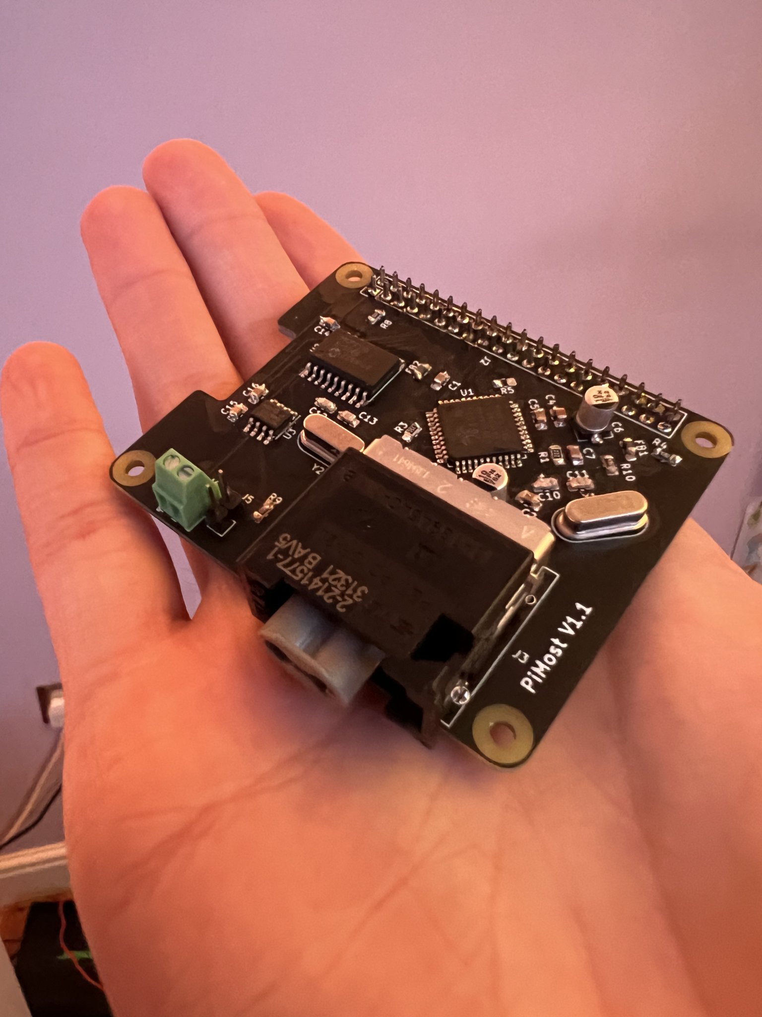

This then gave birth to v1.1
Which now has the header removed and traces run to the i2s GPIOs, it also has a can channel running too.
Currently implementing the standard fblocks for cd player, amfm tuner etc. Quick example video below if it integrating the OEM cd player
