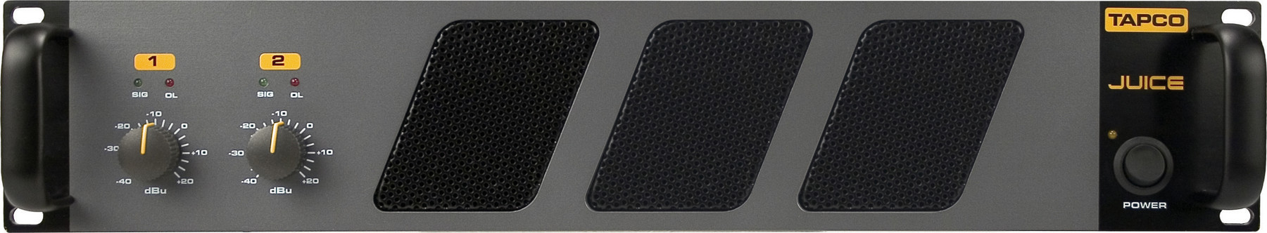

The EP2500 is 450W/8R 20hz~20Khz and about USD$350, The Tapco J2500 is 575W/8R 20hz~20Khz and about USD$400.
