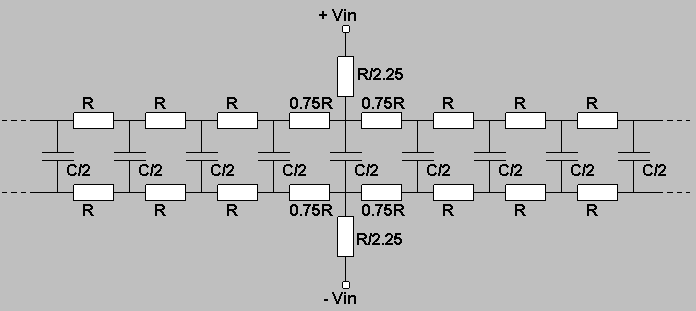

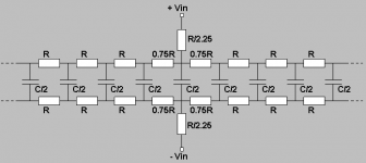

The load that an ESL panel would provide to this amplifier is right in line with these devices.
There are two main types of ESL panels and the loads differ. In an unsectioned panel, the front and back stators create a capacitor with air as a dilectric. A 12"x48" panel would have a capacitance of about 500pF. The intrinsic SPL response of this type of panel has a 10dB/decade upward slope.
To counteract this, a feed resistor is used to create a low-pass RC filter. Typically this resistor is placed on the primary of the transformer, but in this case there would be no transformer so the feed resistor would be in the range of a few hundred K to a couple of M Ohms.
For a segmented ESL, the panel is divided into many vertical sections, with these sections separated by resistors to form a large RC ladder (see diagram below, from user bolserst). By having the highest frequencies on just the thinnest center section, horizontal dispersion is much improved. Again, there is a feed resistor, but is is of a much lower value. In my case, the R is about 350K and the C is about 70pF, making the feed resistor about 150K.
With a +/- 3000V supply and 150K of feed resistance, we are looking at about 20mA drive current required. Based on EVULs post, this is in line with what these devices can handle if paralleled.

Against an amplifier for dynamic speakers, where the loading speaker is rather irrelevant, the requirements for a DD-ESL amp vary widely.
Basically it depends on the ESL panels efficiency and type of construction.
Fullrangers are inherently low efficiency and as such can be ruled out, as voltage and power requirements are way too much.
Leaves us with hybrid panels, which could be divided into electrically segmented and non-segmented. Both of which may be driven directly to decent SPLs with amps of >2kV supply lines.
The non-segmented panel though confronts the amp with such high capacitances that the current and power demand towards the upper audio bandwidth become rather non-practical.
The electrically segmented hybrid panel seems the only one left where a direct drive amp could actually make some sense.
Depending on the segmentation it may require just 1/10 of the current and power to drive a same-sized non-segmented panel.
It remains questionable though if there is any benefit against a decent transformer driven panel.
