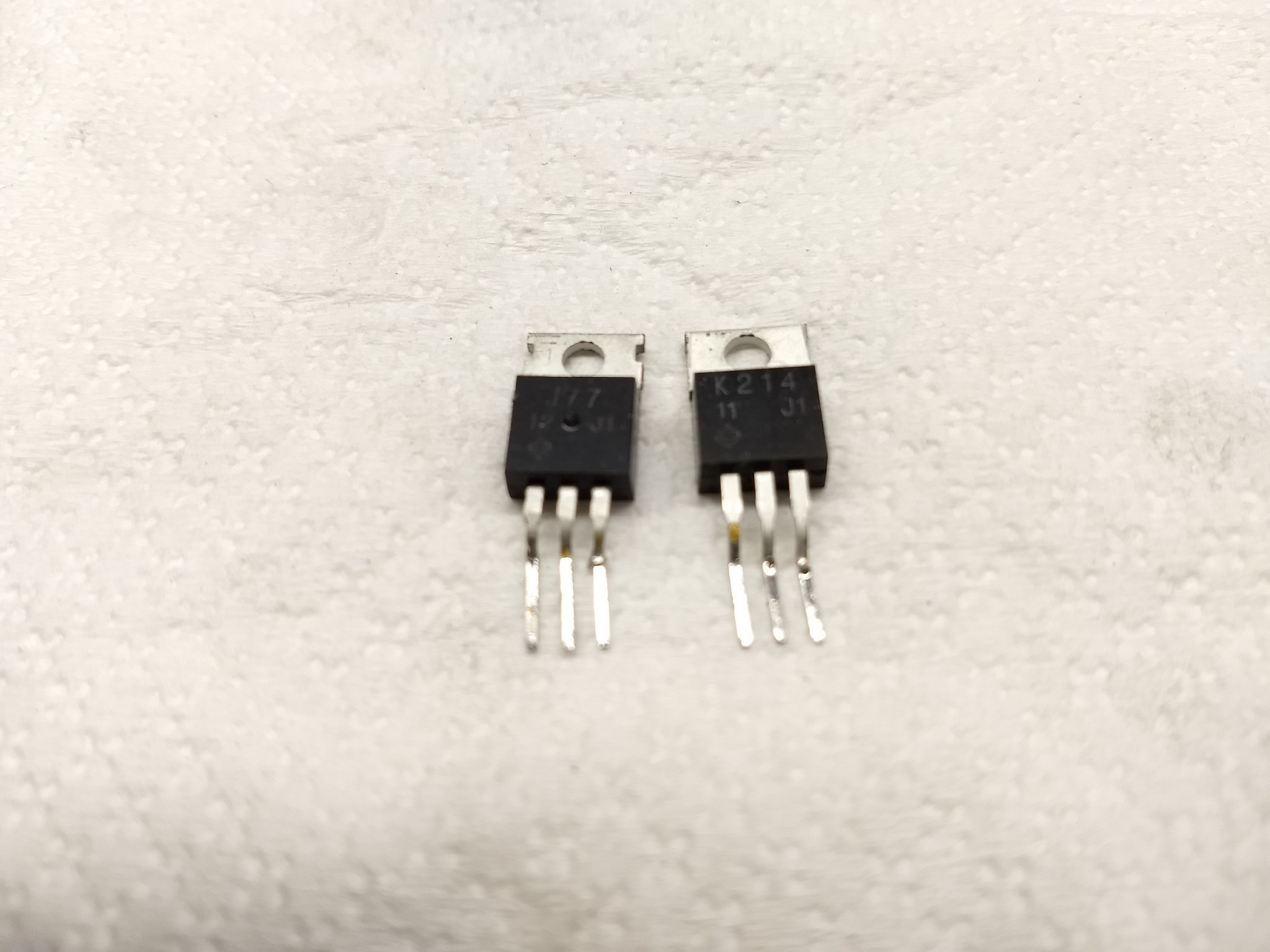

I have an a/d/s amplifier that I'm working on. It was a bit of a Frankenstein from several previous techs repair attempts. I've finally isolated my major issue, and it is that sometime in the past someone replaced the 2SJ77/2SK214 mosfet complimentary pairs with what appear to be counterfeit parts. The 2SJ77/2SK214 mosfets have a lead order of Gate Source Drain. These counterfeit transistors are all the more common GDS lead order.
The originals pairs are now long obsoleted and I'm looking for some possible substitutes. The tabs are not needed, so the package does not necessarily have to be to-220. They are sandwiched between the board and the heat sink though, so the package would have to be of similar thickness.

GDS is usuall vertical mosfets.
GSD is usually lateral mosfet.
It will probably work ok with verticals but lack of source resistors wont make it react to heat so good unless it has a proper Vbe multiplier.

The amp wasn't converted to verticals, it has correctly labled parts in it, but those parts test out to have the VGS lead order and are the whole reason that the amp came to me for repair. I assume one of the previous techs went the eBay route and ended up with counterfeit relabled vertical fets.

Exactly, that's my point as to why I assume they are counterfeit. These parts are labeled j77/k214 but the center lead is most assuredly a drain lead, not source.

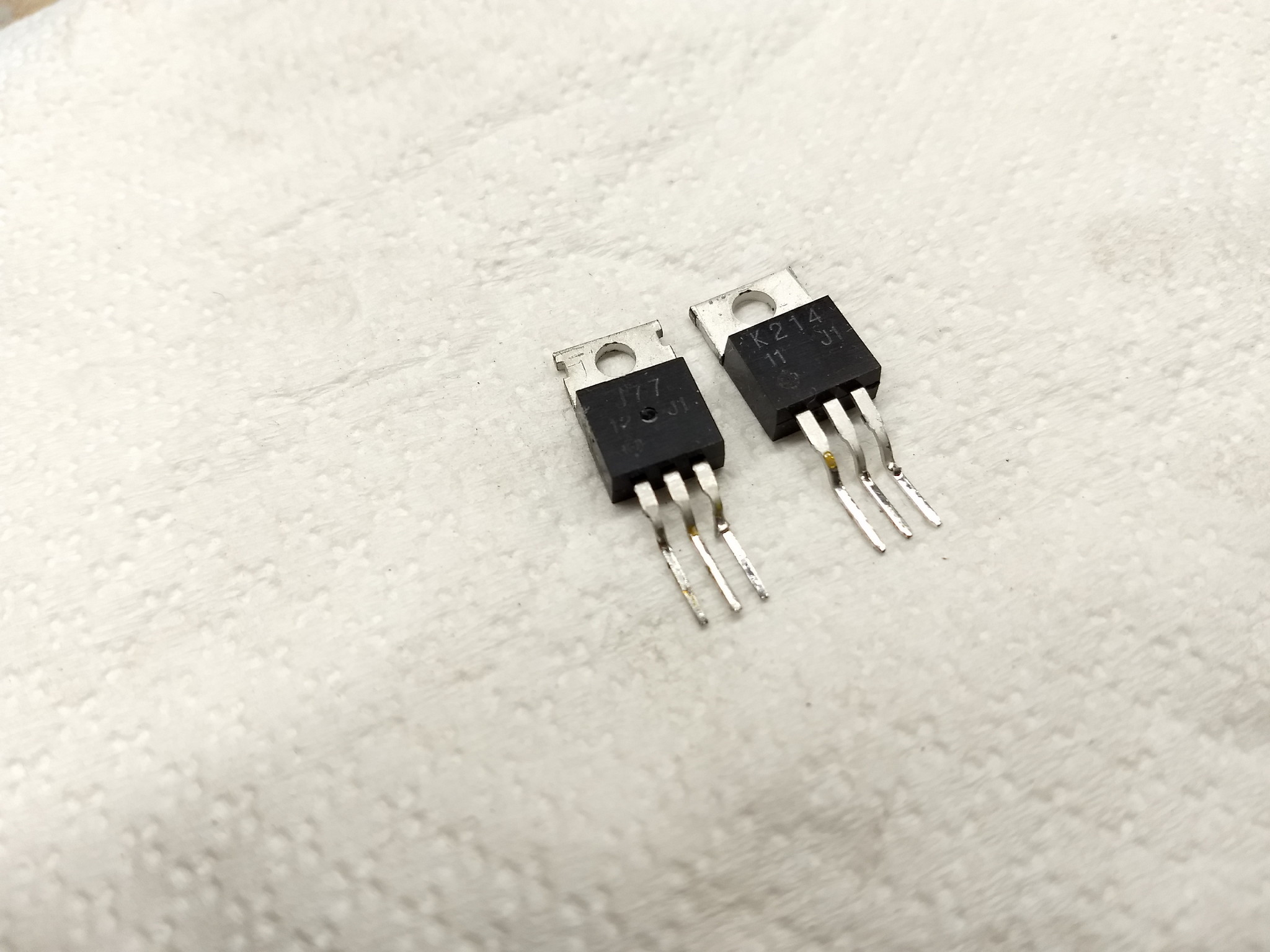

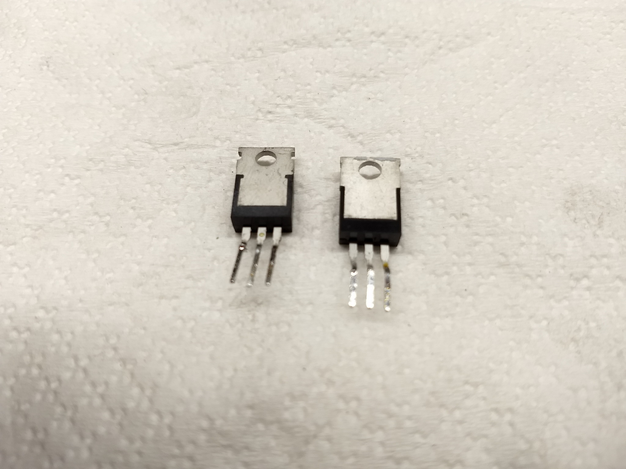

Could you post a picture please?
Not what the official datasheet says, so consider them useless fakes.Exactly, that's my point as to why I assume they are counterfeit. These parts are labeled j77/k214 but the center lead is most assuredly a drain lead, not source.
Of what would you like a picture? The fets or the amplifier in general?
Of the FETs please, I doubt that they are fake.
Thank you.
Here you go. They are kind of tough to photograph. I'm curious why you think they aren't fakes with just the discussion so far. I can't see why the lead order would differ from the datasheet except if they were fakes...
Thank you for taking the effort. You see, I was curious and doubtful, but now I am certain: they are clearly fake.
It was no big trouble. It was more difficult to remember to take the pictures while I was in the shop. I have 10 pair coming from China. They look a lot more respectable than these, but I fully expect them to be fakes as well. I somehow doubt that there were 10 pair of these in a Shenzhen market stall just waiting for me to buy them... I'll post more pictures of them once they are here...
