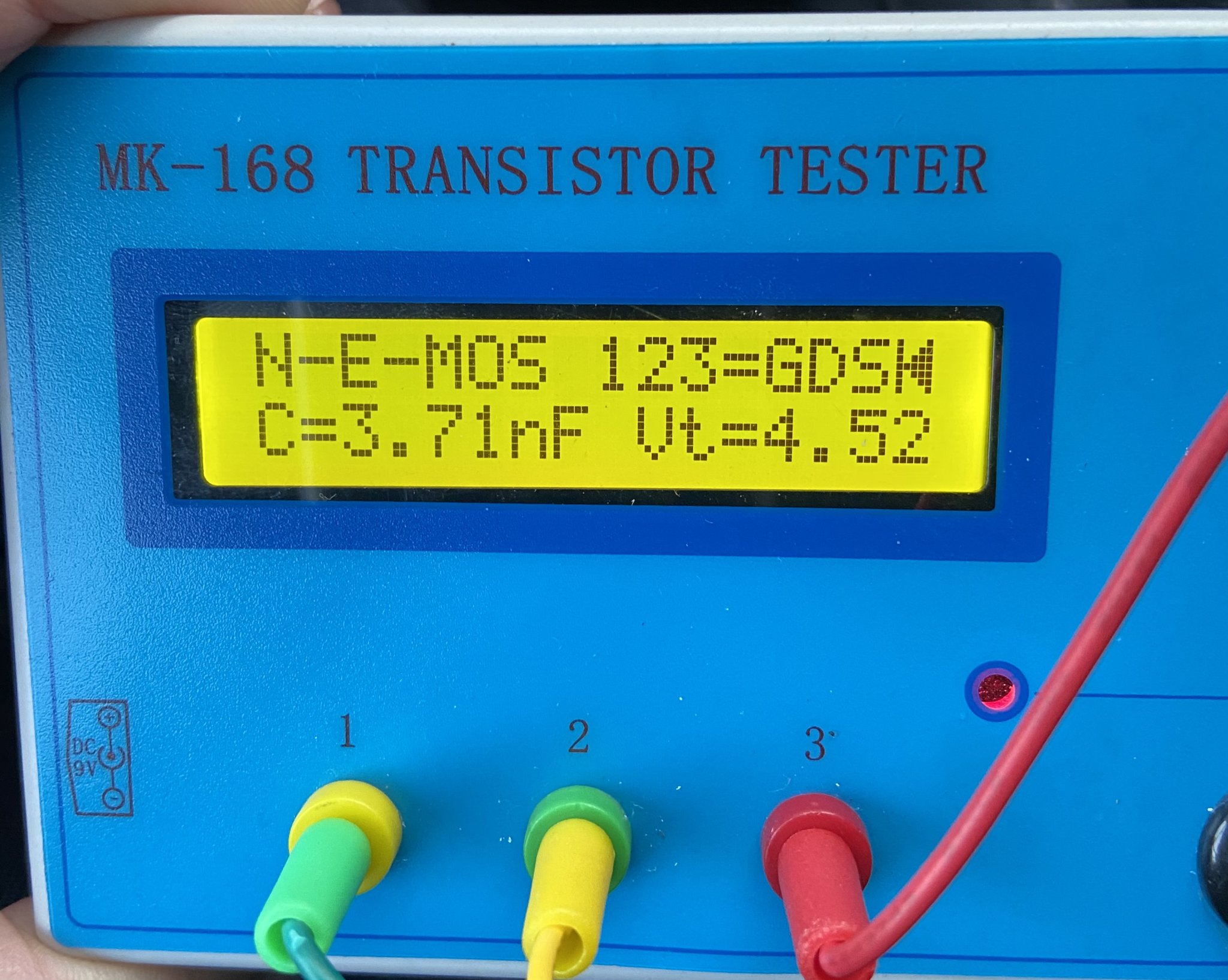

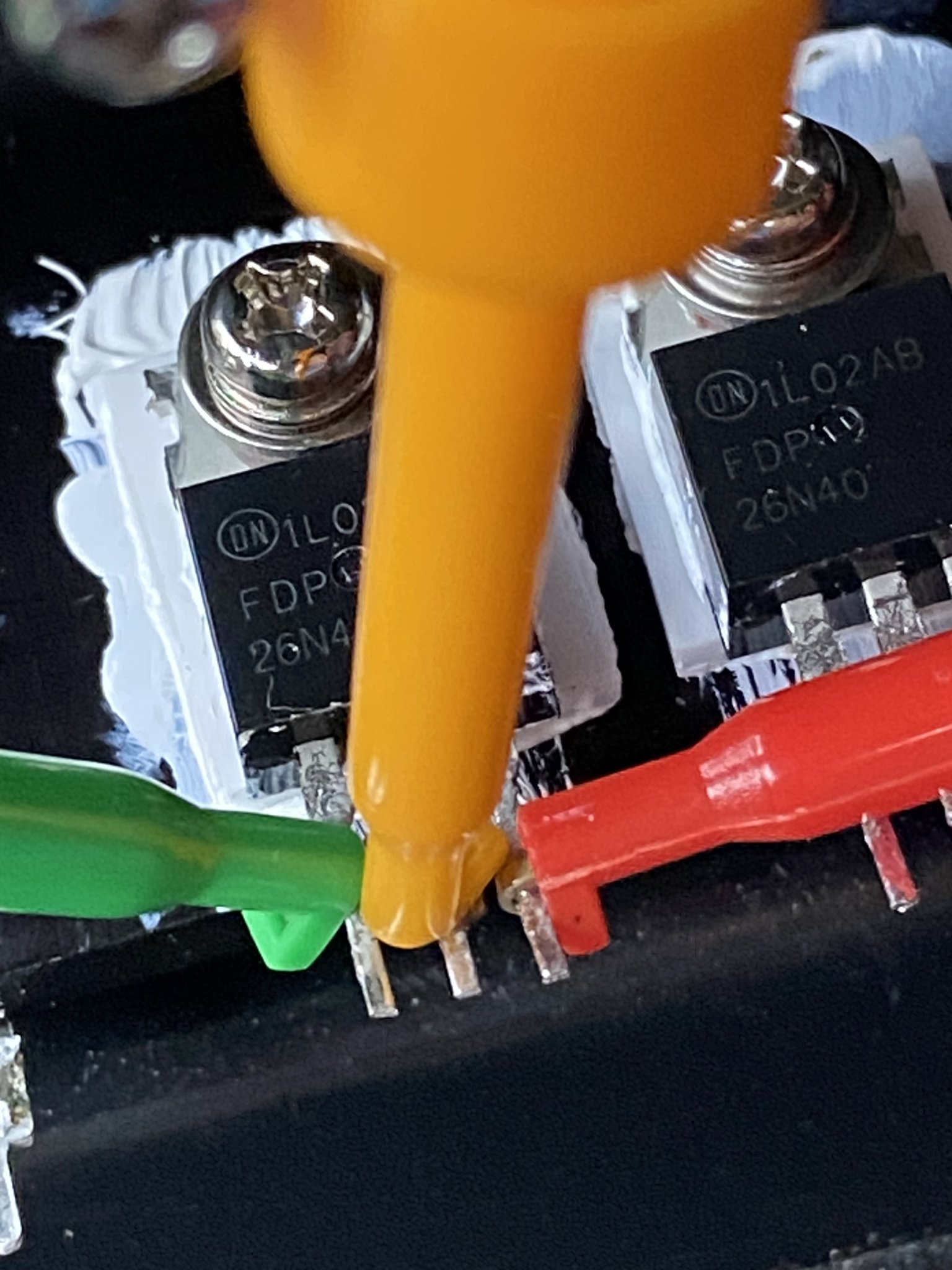

I don't know why I didn't think of using my parts tester instead of my DMM (duh!), but here are pics. The pinout is as same in the data sheet for the the other brand of 26N40. Tester says it an N enhance mosfet.
But why, when I use my DMM, do I get no reading with negative dmm probe on source and positive probe on drain even after I "charge" the gate with the positive probe? I only get the .5v reading with positive probe on source and negative on drain. And no matter what I do, I can't seem to discharge the fet?

Sounds like a leaky gate, caused probably by static damage. Once the gate oxide is damaged the device can deteriorate or fail completely. Its absolutely essential to observe anti-static precautions with discrete MOSFETs, many have no built-in protection so just touching it can destroy it.
Big power MOSFETs have larger source-drain leakage than small MOSFETs when off - check the datasheet for what's expected - if the leakage is larger, its definitely been zapped, but the expected leakage can be surprizingly high (not like a CMOS gate), so it may be just fine - check the numbers...
So.
I place + to gate while touching - to drain. Release both.
Place + to source and touch - to drain. I get .33v reading.
If I leave + on source and briefly touch - to gate, then place - back to drain, I see .5v reading.
I'd add you will need to short the gate to source for the R check from S/D. The device tester is saying it is enhancement mode, so with 0V G/S, S/D should be moderately high resistance. Spec sheet should give the range. And as Mark says, great care with MOS devices. This is a power device, so a little more robust, but still, keep leads shorted if possible and wear a grounded static wristband when handling. And anti-static mats of course. For a device that can handle hundreds of volts and substantial current, they are surprisingly fragile.
