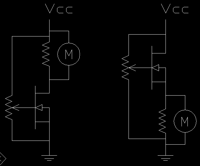

Using the tried and true method as described by nelson pass for matching Mosfets as shown on the left. By using a regulated power supply, taking a mosfet from a batch, setting the pot to obtain a specific amount of current through the resistor and then swapping mosfets without changing any of the settings and noting the differences between the devices...Will the set up on the right give the same results all else being equal? I have a specific reason I want to use the setup at right vs the set up at left.

The righthand diagram measures the Id OK.
How do you measure and/or set Vgs? You have added an extra voltage drop that ruins/subtracts from the voltage set by the pot.

jackinnj - My intent was merely to have the mosfet ON time be consistent. or i should say more consistent then trying to do it my hand. The so called Pulse could be any duration as long as it is the same for all of the mosfets. I had intended there to be a relay in series with each mosfet and the MCU would cycle each relay on/off in sequence. all of the relays would then be connected to a common resistor of which the Vdrop would be measured across by the MCU.
One relay cycles on, the drop measured, relay cycles off and then repeat going down the line. that way. all of the gates in the block of DUT's are all on and at the same voltage and just the relay in series with the mosfet cycles on/off.
I'm sure there are many ways to do this. I was trying to think of a simple, easy way to automate it a bit without getting to complicated or expensive.
