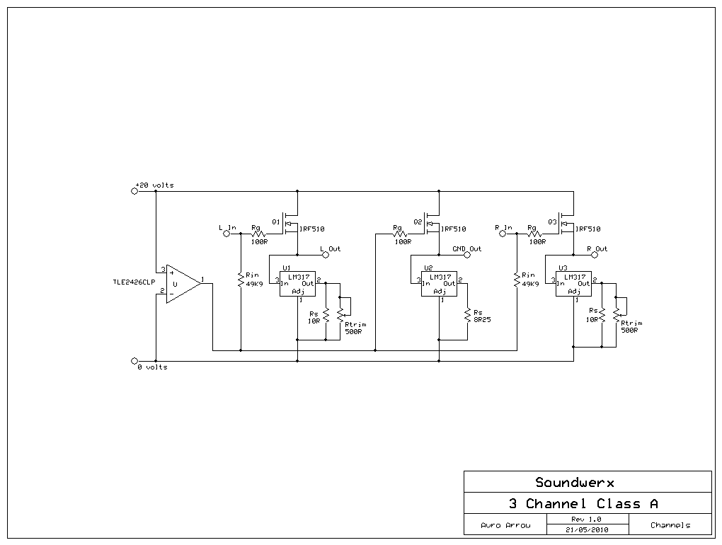

Here is something I built. Works great!
You can eliminate the virtual ground and use output caps if you wish.
That's a very cool circuit. I'm not a fan of virtual grounds, but using the voltage regulators as CCS's is very clever. (I know it's nothing new.)
I've heard that you can use a voltage regulator as an audio amplifier. I never tried it, but I can see how it would work. I don't know if it would work very well or not.
This circuit could easily be built by a novice on a perfboard.

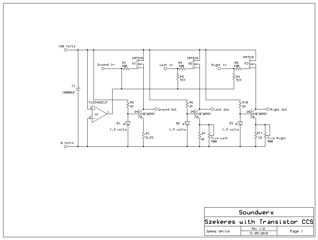

I also designed one with a transistor CCS as well.
I have not built this one.
I matched my MOSFETs, and with the timmers,
you can adjust the output offset to almost zero.
After it warms up (a few minutes), offset drifts very little.
Mine was built on perfboard and an old AMD Athlon heat
sink. With an 18 volt supply, it only ran warm.
Offset was under 10mV at startup and settles to less
than 5mV when warmed up.
That's a very nice, basic circuit. Is the transistor CCS better than the voltage regulator one, or not?
