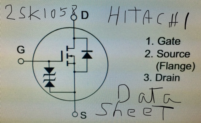

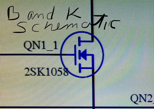

Help finding 2SK1058 replacement for B&K Avr 307.
Hello guys! I am new to this forum and i need help replacing 2 lateral n channel mosfet model # 2sk1058 for my B&K avr 307 receiver. I bought some units from ebay but got scammed they were fake! But at the same time i am confused because the Service manual schematic for the b&k avr 307 shows different symbols for the 2sk1058 and the data sheet from Hitachi/Renesas is different as well. I could really appreciate any help on finding a replacement match, Thank you very much.
