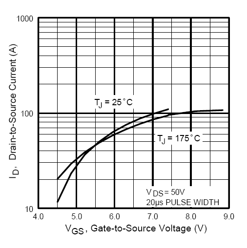

International Rectifier (IRFx...) and Vishay / Infineon parts are vertical enhancement MOSFETs designed to operate in the ohmic region and not in the pinchoff. These parts are easily identified by their high gm figures. The goal is to get the device to enhancement as soon as possible, with the smallest change in Vgs.
Also, MOSFETs are positive temperature coefficient (PTC) devices only with sufficient drain current and not immediately above the threshold, as we see in the picture below for IRF540N (example).
However, IR used to advertise their MOSFETs as being suitable for linear amplifiers in their own application note AN-948 (attached).

This AN-948 appears to have been created in 1996, back before this SOA issue was discussed. I remember Creek selling a range of vertical mosfet amplifiers back then, that suddenly stated getting a reputation for blowing up. This was likely due to the mosfets becoming vulnerable to SOA.International Rectifier (IRFx...) and Vishay / Infineon parts are vertical enhancement MOSFETs designed to operate in the ohmic region and not in the pinchoff. These parts are easily identified by their high gm figures. The goal is to get the device to enhancement as soon as possible, with the smallest change in Vgs.
Yes, AN-948 was discontinued, as IR possibly learnt their lesson. Some of their parts like IRF610/9610 etc. are still used however.
