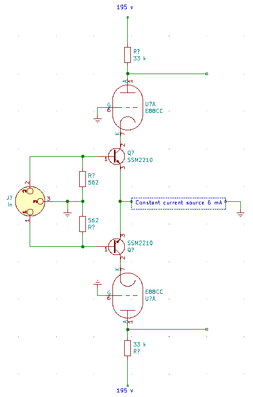

I would like to build a balanced RIAA amplifier capable of an MC cartridge with 0.2 mV output. I have been looking at Allen Wright's RTP amplifiers and Morgan Jones' balanced hybrid RIAA amplifier described in his book "Valve Amplifiers" fourth edition on pages 628-645. I like MJ's design since it is quite well described and draws a lot less power than AW's designs. However, MJ's RIAA stage is designed to give 4 Vrms output with 0.3 mVrms in to match balanced digital sources. I don't use any digital sources and my line stage is designed for 250 mVrms input. Therefore, I would like to reduce the gain.

The first stage is a cascode with a transistor and an E88CC tube in each leg. MJ writes that the gain can be changed to adjust for imbalance between the channels from the cartridge by adjusting the current in the first stage and gives the following equations:
A = gm * Rl
gm = 35 * Ic
3 mA is passed in each leg of the first stage. If my math is right, I would need to reduce the gain in the first stage with a factor of 10, which would reduce the current to 0.3 mA. Would this be feasible?
I could also reduce the gain by reducing the anode resistors Rl.
Reducing the gain of the second stage is also a possibility.
Can this RIAA amplifier be successfully tweaked to suit my requirements? If so, what would the best way be?

Without violating the copyright, I hope that I can show the initial stage (see below).
The stage consists of two cascodes with a tube and a transistor. From what I have read on cascodes with two tubes, if there is an unbypassed resistor, Rk, on cathode of the lower tube, the gain is reduced with a factor:
1/(1+gm*Rk)
I guess that this would also work when the lower element is a transistor. Adding 82 ohm resistors under the collectors would degenrate the transconductance and therefore the gain with a factor of 0.1, which would about the right total gain for me. The voltage drop over the resistors would be 0.25 V. This might not mess up the operating point of the transistors too much? 😕

If you add a potentiometer between the emitters and the CCS you can:
- increase linearity of the stage;
- reduce gain as you want;
- balance the stage.
Are you sure grids of the triodes are grounded and not referenced to an higher voltage?
I've widely used that kind of stage as phase splitter in PP amp, an I ended preferring a tube on the bottom and a ss device on top.

The linear way to reduce transconductance is to add series resistance to the emitters (also called degeneration). Each resistor adds to the reciprocal of transconductance. So:
Gm (total) = reciprocal of (the sum of added resistor plus reciprocal of transistor Gm).
Thanks Chris! This sounds like the way to go. 🙂
Is there any risk that the voltage drop of 0.25 V across the 82 ohm resistor will shift the operating point of the transistor too much? 😕
Thanks again Chris! Now, I know how to proceed. 🙂
