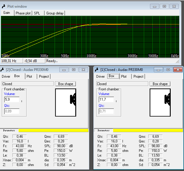

Anybody have any idea why Winisd calculates the volume for this speaker at .40 cubic feet but the optimum size shown by the product details at Parts Express is .26? And what would you recommend for this driver?

Don't pay too much attention at WinIsd default calculation. It should not be taken as an optimum volume, simply it's the volume that gives a qtc of 0,71.
Feel free to choose the Qtc that you like most, trying to avoid values above 1.
Qtc between 0.8 and 1 are fine for small woofers, and save a lot of space.

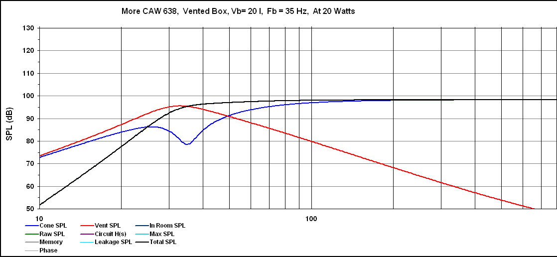

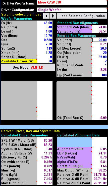

Morel looks to be better suited to a vented box if you care
about woofer performance unless you want it in a small space
like car interior.

ET338 tweeters. I'm thinking about using the caw's in seperate sealed boxes inside of the larger woofer box with side mounted 12" Dayton Audio LS12-44 , interior volume appx. 1.5 cubic feet (taking in the volume of the midwoofer boxes). Overall outer dimensions of 10" x 34" baffle and rear (have a 1 1/4 inch thick mahogany to use as baffles) x 16" depth. I figure I can tune the woofer box with damping material and fill to reach the recommended 1.3 for the Dayton.
Any comments? Anybody think this would work out OK?
