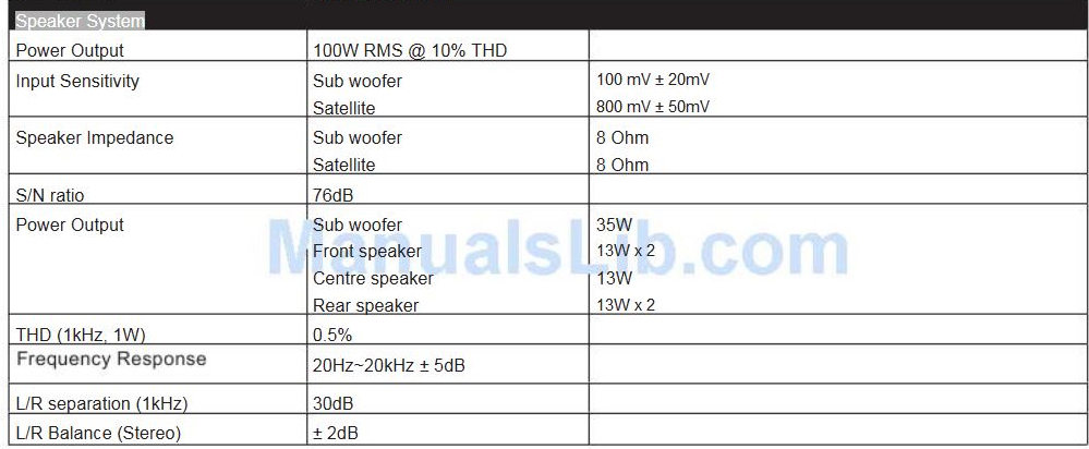

26VA claiming 100W audio could work if we assume a 12dB peak/average ratio. Which is entirely likely for speech/music.
I think those specs outline what you can do. Simple amplifier makes 13W in 8r. Bridge in 8r implies 52W but chip-limits make it 35W. Since you have many channels at these specs, you could rig four amps bridge into two 8r loads and hope for 35W+35W in speech/music peaks, altho much less on sustained test tones.
What continues to horrify me: The transformer was taken from a system making the attached claims.
Sometimes people lie by implication.
