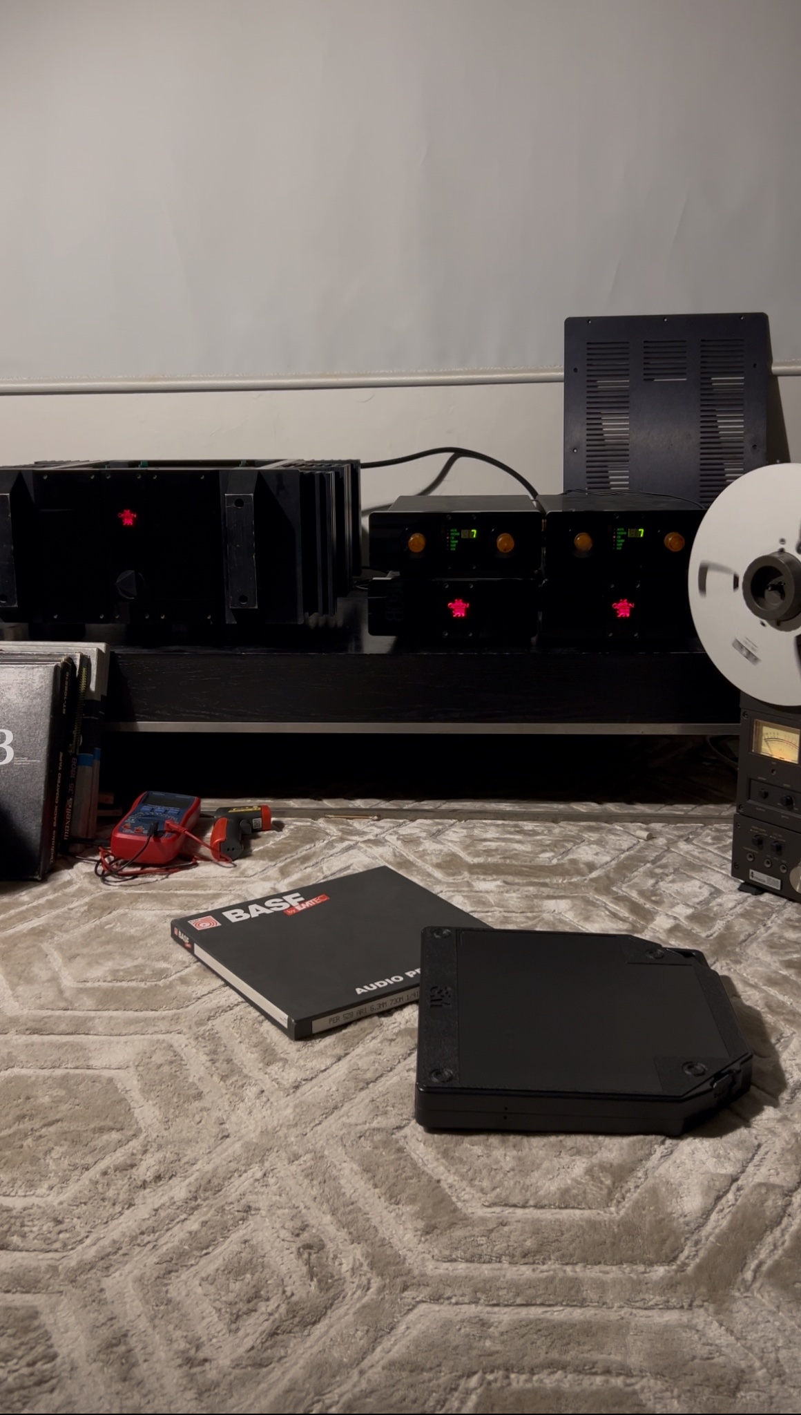

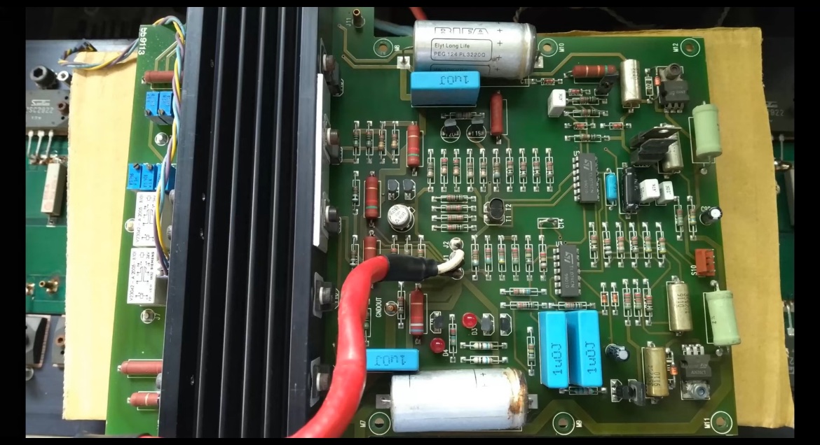

Greetings all,

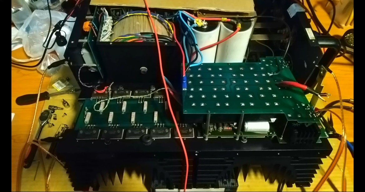

I would like to ask you for a favor, I am planning to get these amp and power amp recapped and I believe I can do it but a guidance from you would be appreciated.
Current status of both are working fine and temperatures are stable in the power amp with 100% class A.
I have experience in recapping Studer tape recorders and I have done few DIY projects. However this is a beast and I don’t want to miss out with it. However I am in Saudi Arabia and there are no good dealers that can do the job for me.
Also I can pay for guides from your experience or donate to the website and attach the evidence.
I have seen some pictures online of the machine and we can plan for recap.

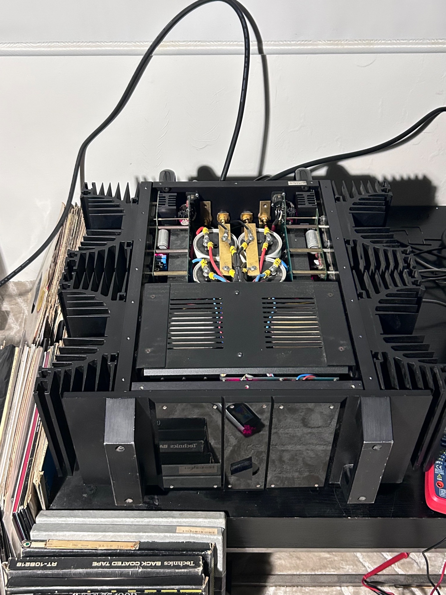

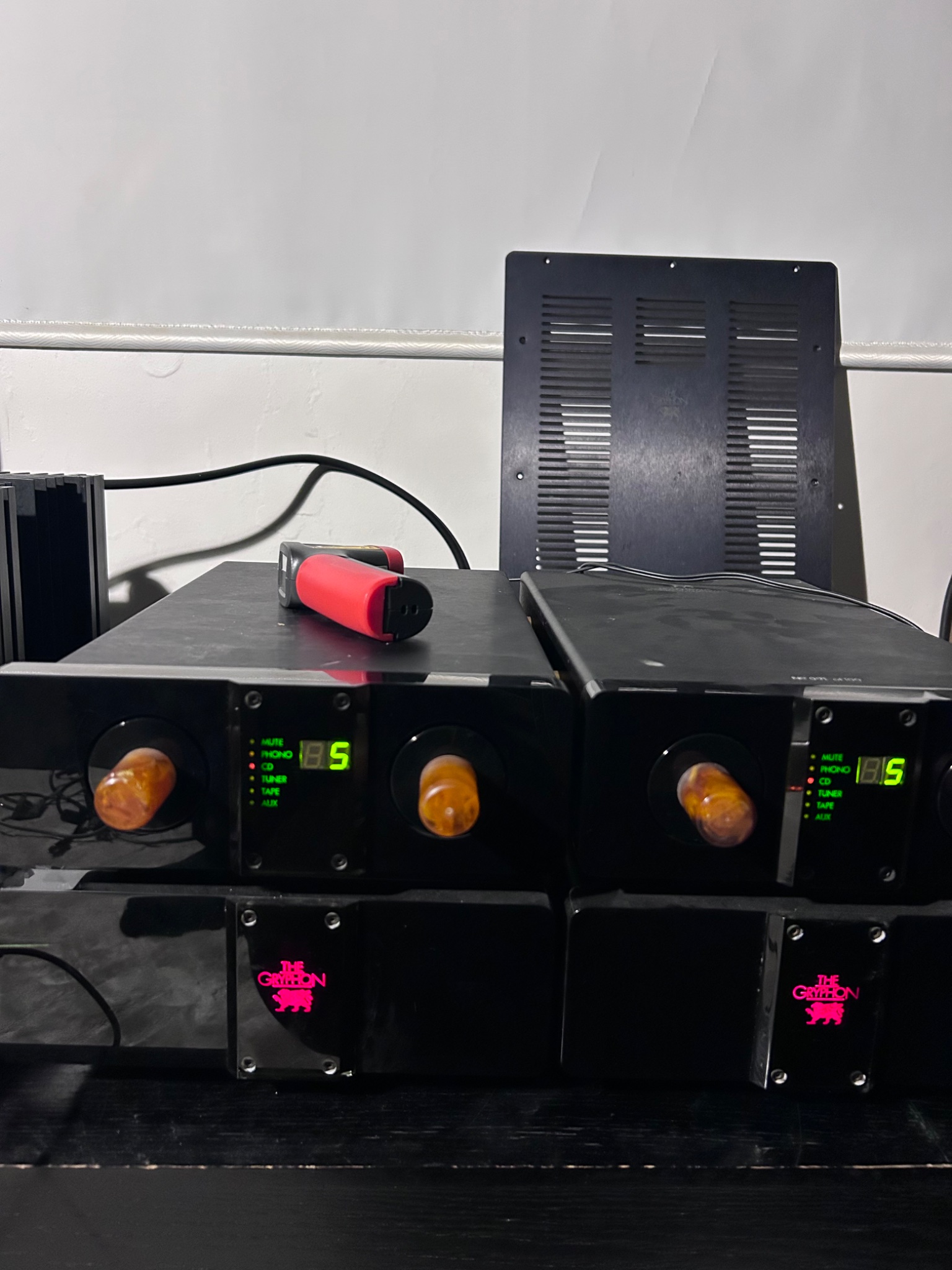

These are the photos of my gear.
If I receive a commitment from you I can start a new thread and start.

Hi Ramadhan96,
There are some capacitors known to be bad, some that ran hot and similar things. Aside from this, it is highly recommended that you do not just "recap" equipment. For example, some A-77 capacitors are almost always bad, yet in older equipment in different brands, the capacitors are fine. I was authorized warranty for Revox and worked on Studer along with many top brands.
So if the internal temperatures of your equipment were high (like many earlier Krell amplifiers), you may need to replace filter capacitors. Normal amplifier filter capacitors may be perfectly fine, you are further ahead not touching them. I receive equipment for repair that once worked fine, and after a recap they don't and I have to clean up the mess that was made. Most often I note the customer was charged for unnecessary work, and things that need to be done were not. Wasted money.
I'm guessing that if a good shop will not do the work for you, they have a good reason. Your pictures are so dark I can't make out what you have.

This is a fully Class A amplifier that runs very very hot and is 30+ years old. I am no expert but the question on recapping seems entirely reasonable.
But this is a "luxury" expensive audio component and someone smart should do the job.
And hey- post some pics of the inside! Top panel removed and bottem panel removed; caps may be easily accessible for all we know.

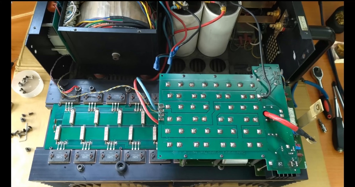

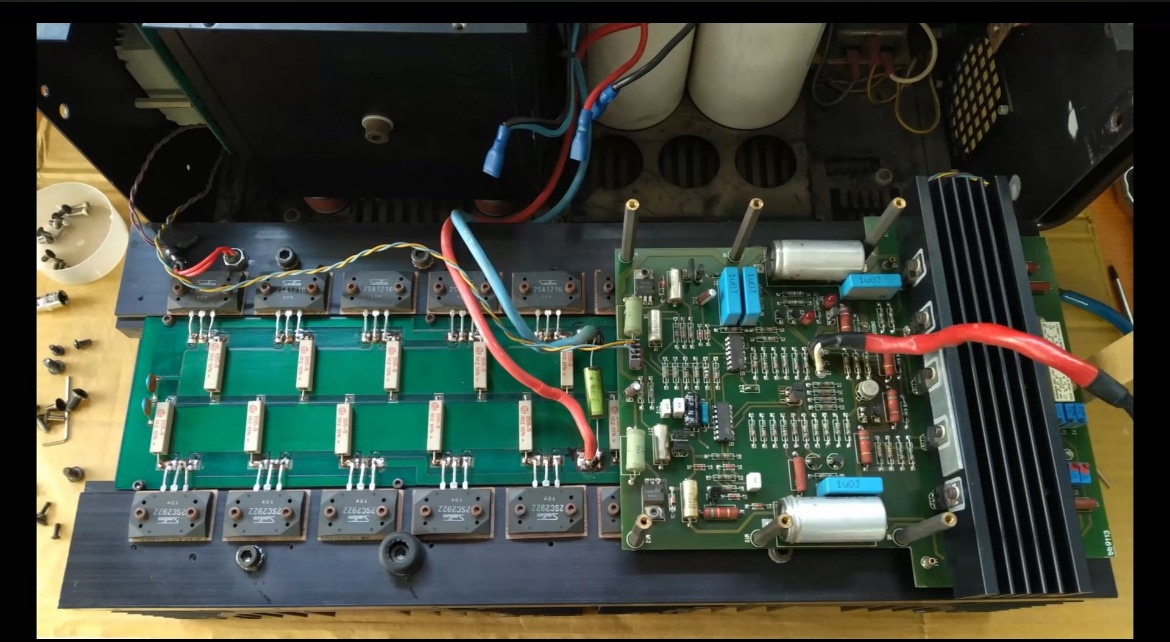

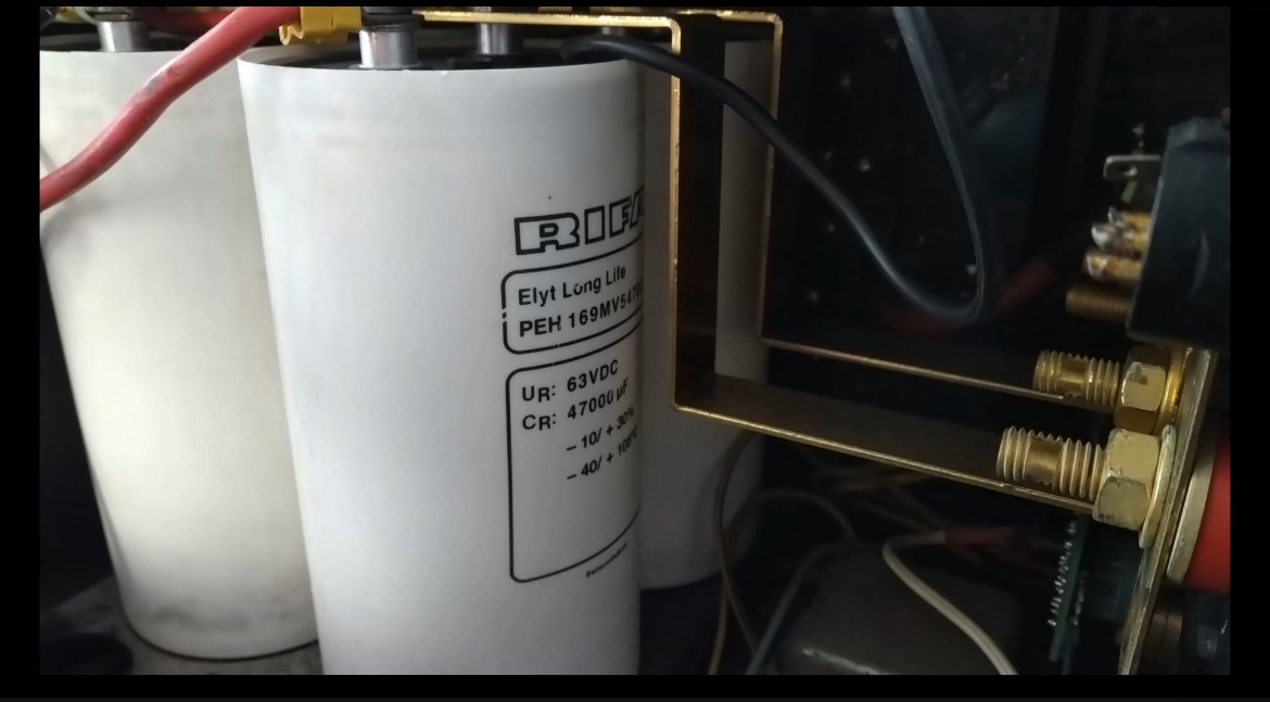

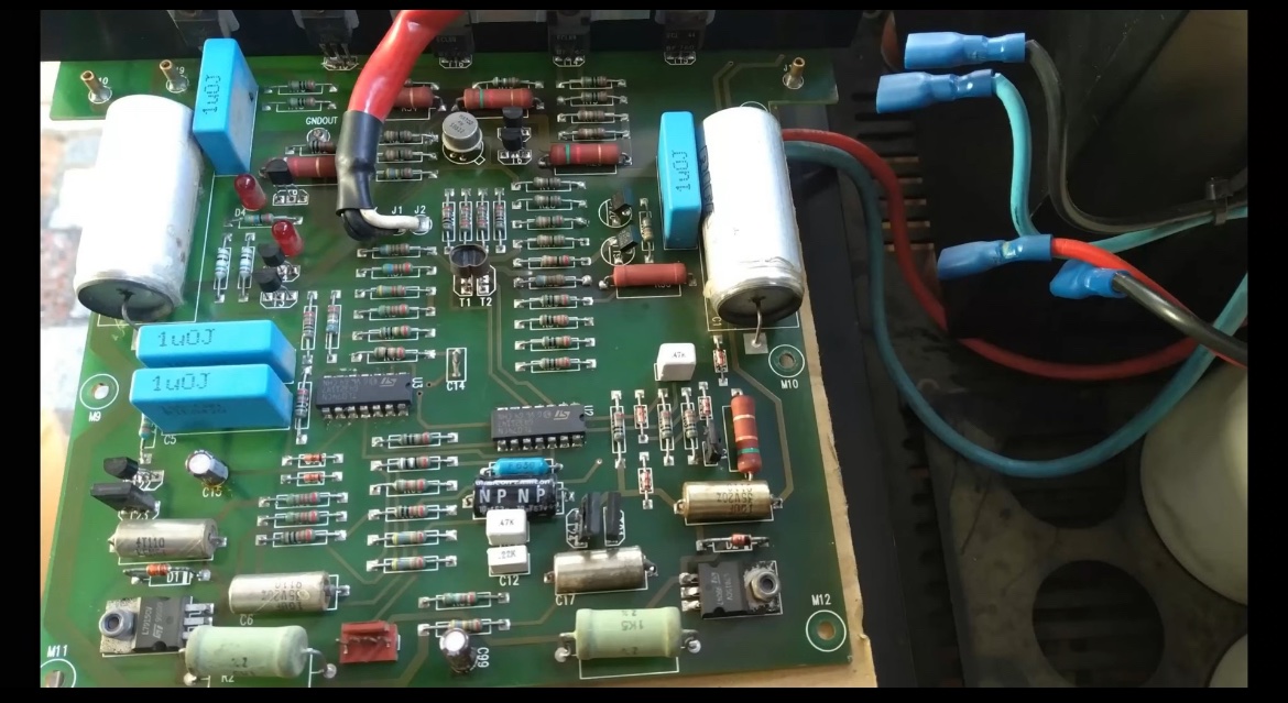

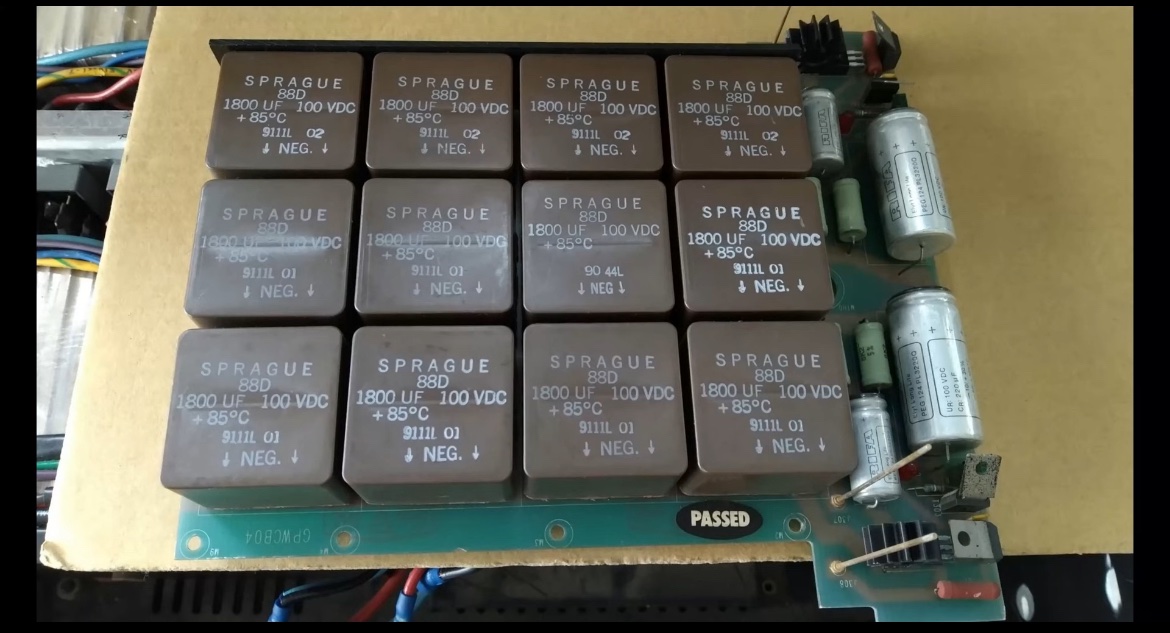

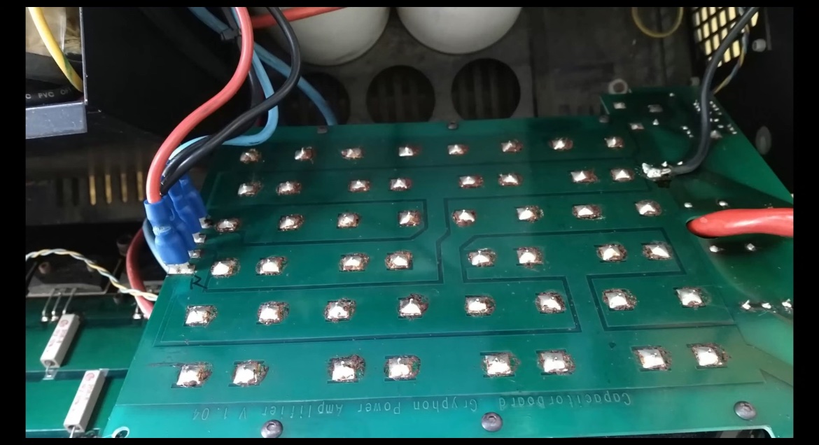

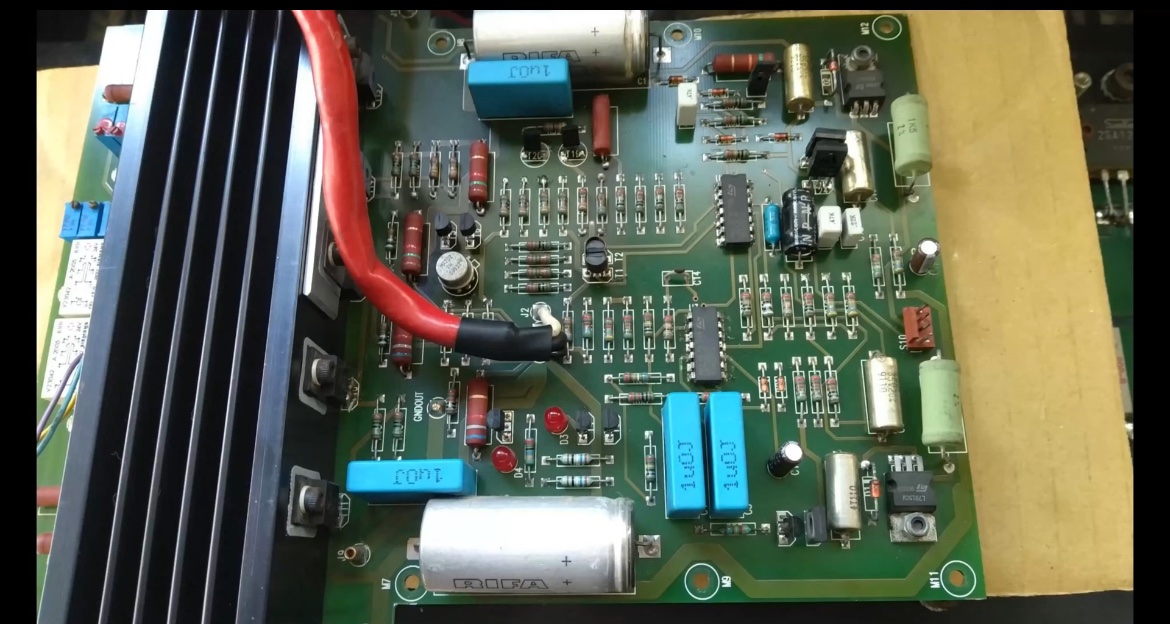

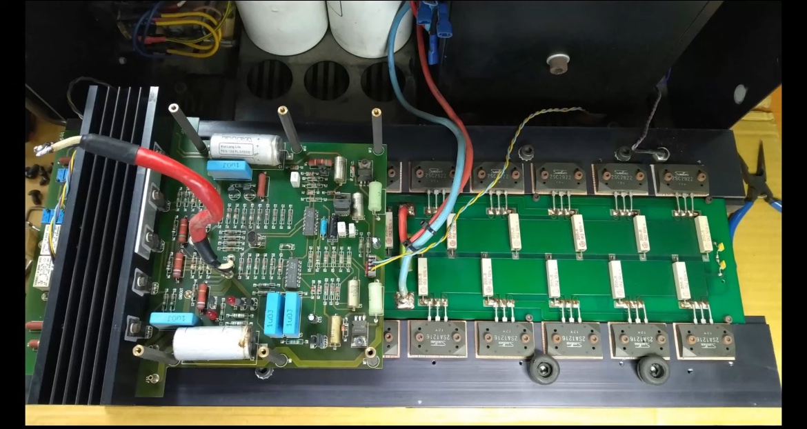

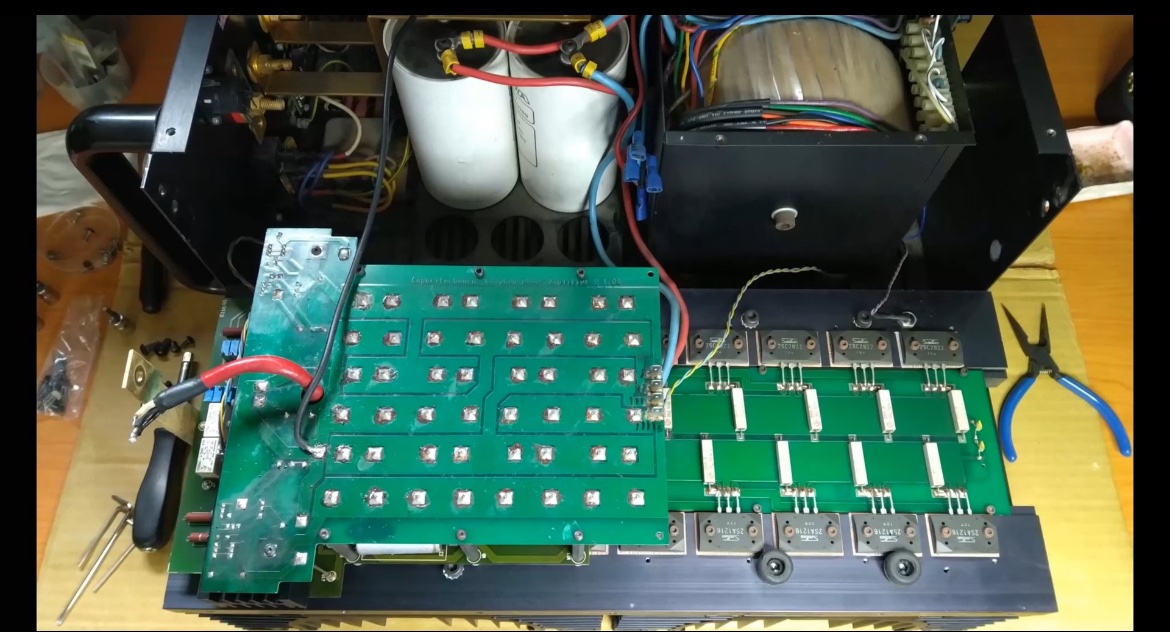

hello @anatech,
Appreciate your reply. What I have are LE preamp and Dm100 power amplifier. Here are other pictures.
All caps used high quality Rifas and few ROE.
Mains filter caps Rifas PEH169 long life caps and for the axial they are PRG 124 also very long life caps.
Caps in the power amp.
4 x 47000uf 63v PEH169
8 x 220uf 100v PEG124
4 x 47uf 100v PEG124
24x 1800uf 100v Sprague 88D special design see attached Datasheet
These what I counted from the pictures in the internet and I can see the same in my unit .
For the preamp
There are 150x 470uf 40v ROE backlite EK series I think, and these are known to fail but in my unit they did not seems too and there are no cracks and the power supply is constant.
For the preamp section
8 x 1000uf 25v PEG124
4 x 220uf 50v PEG124

Ah, you already took it apart - good luck.
I owned Gryphon DM100 and XT at the time, nearly 35 years ago.
First repair of the DM100 was in 2012 and it was not a cap. Someone
smart would probably agree not to exchange caps at random.

In post 4 I read "both are working fine", so for me no reason for a change.
Gryphon chose parts very carefully. You will have a problem to source spares
of similar quality.
of similar quality.
I agree with you there are no PEG nor PEH in the reputable market such as mouser with the same values. Also for the ROE no availability with the same ESR.

Yes, some parts pretty much have to be replaced with the same thing, or at least case style. I have seen shorted Rifa filter caps, but it really depends on how they have been used.
Keep the system well ventilated and cool if you can.
Now for service, a very competent service shop or person is sometimes better than factory service if they know exactly what they are doing. The factory has the advantage of being very familiar with the product and having proper replacement parts. It's more difficult for outside service, but I have seen external service do a much better job depending on the tech. I wish we could always say factory service was always better.
