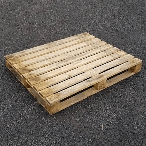

The fun part is that the garden cupboard sits on a pallet.
A UK pallet measures 1200 x 1000 x 130mm - a whopping 120 litres!
Of course I'm thinking SUBWOOFER!!
The 130mm height provides serious challenges but wouldn't it be an engineering coup to design something half decent?
OK, I'm up for some more fun! 😉

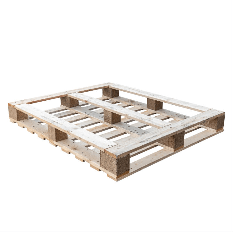

How do you envisage dealing with the gaps?
standard UK wooden pallet
P.S. On checking the arithmetic, I find that (1.2 x 1.0 x 0.13) m = 0.156 m^3 = 156 litres.
That's external. Internally it's between 125 & 130 litres, then I need to deduct for the drivers, bracing & ports.P.S. On checking the arithmetic, I find that (1.2 x 1.0 x 0.13) m = 0.156 m^3 = 156 litres
If I use 6mm MDF top and bottom it's 1200 x 1000 x 142mm.
Yes.Is your pallet a "block design" as shown in this inverted view?
