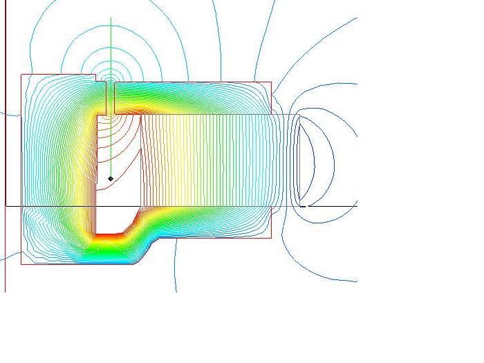

more field simulations: Seas L18 H1224 motor - WOW!

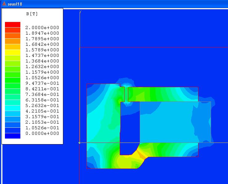

This is the nicest motor I have analyzed so far. I used 1008 steel and Ceramic 8 D in this simulation. Note that I get a maximum flux of 0.8 T in the gap. If the Seas data sheet (1.0 T) is accurate, this means they must be using even better iron and/or ferrite.

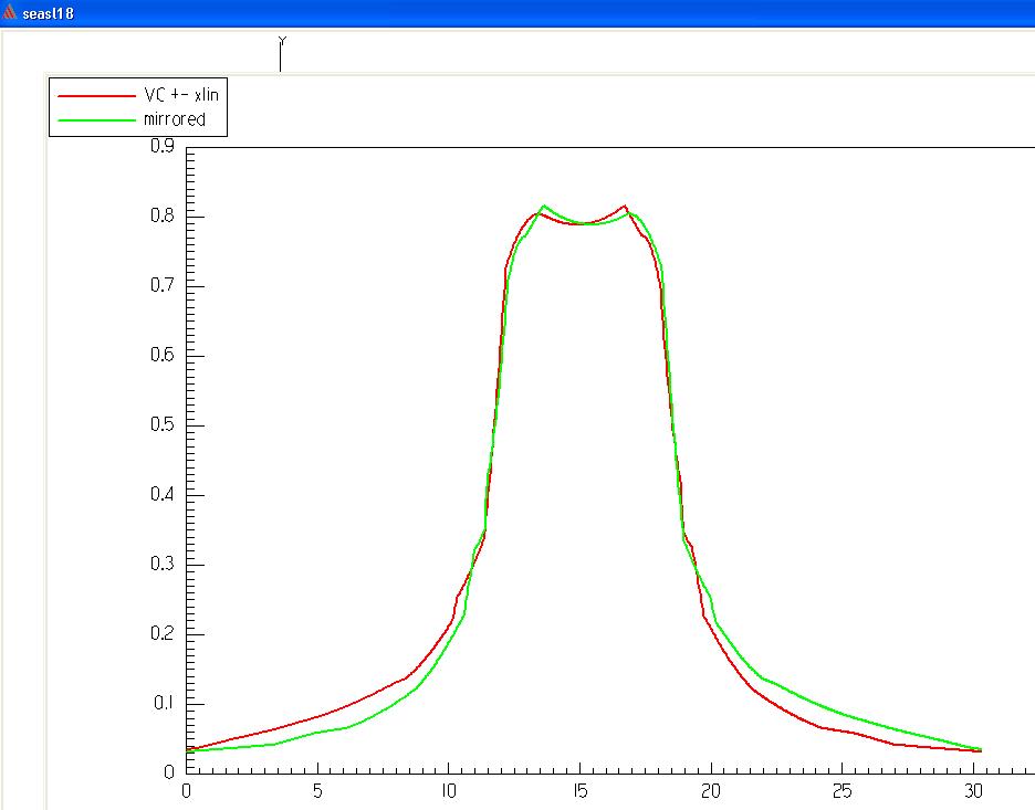

field symmetry
Notice the nicely steep and straight slopes and the good symmetry. This is even better than the heavily undercut Vifa M25 pole piece - what a difference a small extension can make.

flux lines
The coil in rest position extends from roughly 6 to 25 on the x-axis of above graph, with a nominal travel of +/- 6 mm.
There would seem to be a slight assymetry in the fringe field that the coil would pick up while moving. However, looking at the flux line plot, we can see that the lines of the upper fringe field are nicely normal to the z axis, wheres the line in the lower fringe field are tilted. As only the normal component counts, we can expect the force curve to be even more symmetrical. I will report as soon as I have figured out how to operate the §()$/@!!! calculator...

can I assume the magnet is the blue cylinder in the middle (your right looking at the pic)?
Why the deep dish in the backplate? it seems to cause a bottleneck approaching 1.6T.
Your general shape more resembles the days of alnico and other expensive magnets
Why are the commercial ferrite and ceramic shapes (large magnet volume) so different from yours (small magnet volume)?
This is a rotational symmetric plot, and the center axis is on the left hand side of the picture. The magnet is the light blue thing on the right.
I may not have gotten the goemetry of the dish exactly right, but I do expect a slight bottleneck there (actually, 1.6 T is just the knee of saturation of 1008 steel). The dish is there to give the VC extra space for excursion. The line in the third picuture is the VC +/- nominal linear travel, but mechanical xmax is another 10 mm.
