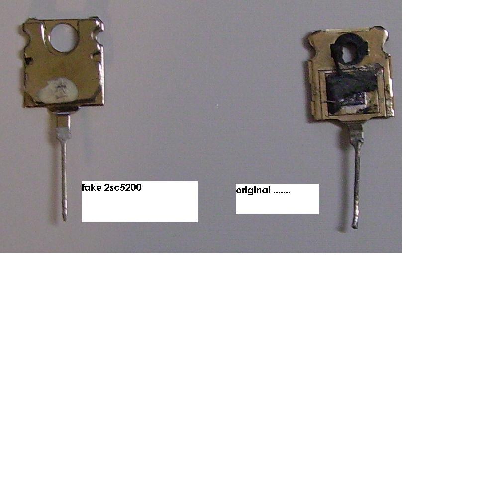

here is a picture of the 2SC 5200 transistors i try to use in a wonderfull sziklai ( god bless this guy !!!!!! ) i am producing the latest days ....
where i buy semis i usually go together with a hummer ..... i buy one transitor i walk out of the company hummer it then get back inside and explain them that they sell bull**** to people ....
then either i try with another type/brand of transistor or just scream to the guy as much is possible .....
so far i returned 12+12 MJ 15003-4 all short circuited as come out directly from my P68 MJ15003-4 version
and also tomorow i will return 8+8 2SA1943 -SC 5200

No need for a hammer: just test beta VS current and tell them politely that transistors they sell are way out of specs.

At least the supplier there respects and knows about these fake transistors, here they tell you you are a idiot that knows nothing about transistor manufacturing 😱 😱

I have an excess of FJL4215/FJL4315 which are the Fairchild equivalent of the 2SC5200/2SA1493. I can sell them for 20 sek ex moms / piece or a bit less if you want many. I have imported them from DigiKey who is an official distributor for Fairchild. I have also used them in repairs without problems.

- more fakes .....
