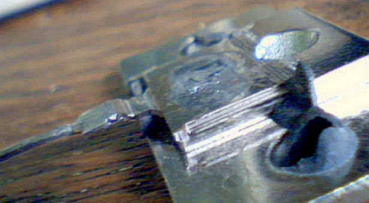

I'm pretty sure these are fakes based on the size of the die. It's pretty telling.
Compare to the photo of real ones on Rod Elliot's website.
The description on eBay said they were manufacturing surplus, and as someone who works for manufacturer, I know we unload our surplus supplies for 10% value when we change our products. So the story is always plausible. I think not this time though.

These transistors look genuine due to the manufacturing style, I bet they are actually made by On-Semi, but they are definitely *not* MJ21194, I think that they are some other lower power model REBRANDED.
I have MJ15003 and MJ15004 marked like tajs and mine are also fake! 🙁
I tested it with acetone and printing came off like it was washed with water! 😡
I never new you could pop the tops off TO-3 transistors, what is the easiest way to get the tops off?
Motorola used to make a driver transistor for McIntosh that I think was essentially the die from a 40W MJE150xx in a TO-3 case.
Since that does look like a real Motorola coin-header under the die, I wonder if they got some of the surplus McIntosh parts and re-marked them?

Eva said:These transistors look genuine due to the manufacturing style, I bet they are actually made by On-Semi, but they are definitely *not* MJ21194, I think that they are some other lower power model REBRANDED.
I think you are absolutely right. Probably 2N3055 (or thereabouts), as the die size is the virtually same.
I wouldn't put any stock in the printing. Printing methods change all the time. Unless someone knows exactly what the printing was supposed to look like on that week, it's not a good indicator.
As for the cap, no they don't come off easy. You can cut them off with a hack saw, or like I did, you can squeeze the edges of the can with a 'vise-grips' until the bond eventually breaks enough to tear it off. As can be seen from the bent mount flanges, considerable torture was required.

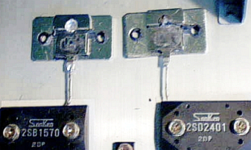

The Face of a Seemingly Good Sanken
Some time ago I recycled a heatsink and along with it two pairs of Sanken darlington 2401/1570 from a 90s-era Kenwood or Denon amplifier (just don't recall what it was). The amp did not work and I did not try to find out why.
The npn and pnp devices looked a little different in the sharpness of the printing, and a slight difference in the cut of the case corners. The differences don't show that well in the pics. I recalled that these could be indicators of fakes. I wondered if fakes could have been going into name-brands back then.
I opened up a pair. If the software lets me I will post some pics, maybe in a reply to my own message. Anyway these do appear to be genuine. The big pads and the overall sound-looking construction seem convincing.
The metal back plate was straight when I started, and became slightly bent from my pounding them open - it took a little work, these are stout.

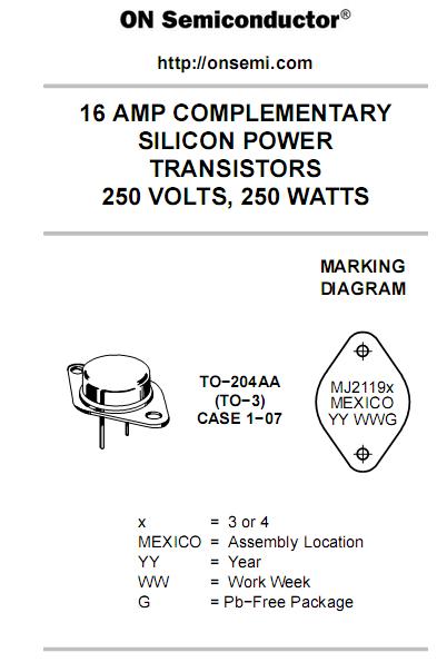

I have 50 MJ21194s DIRECTLY purchased from On Semi about 2 years ago, and they look EXACTLY like those posted in Post#1. My On-Semi datasheet from 2001 also indicates different case markings. For those transistors that I have, the markings also come off if you wipe it with a strong solvent, so I am afraid that it is no solid proof until someone would take the trouble & expense of actually opening up a genuine MJ21194 and see what the die size is.
With improved die bonding techniques, it is technically feasible to use a small die to achieve the same thermal resistance. The thermal bottleneck is usually the case, where you need a large area to contact the heatsink with thermal compound plus insulator. Hence TO3. But TO247 has a much smaller area than TO3 and yet it is thermally equally good. This is because the area in a TO3 case far away from the die itself actually contribute little to the thermal conduction.

"so I am afraid that it is no solid proof until someone would take the trouble & expense of actually opening up a genuine MJ21194 and see what the die size is."
Which was linked to at ESP in the very first post, the die on the MJ21193 is HUGE.
Last night I also cut open an MJ15004 of approximately the same date code, and its die was also HUGE. MJ15004 has a lower SOAR, lower power handling, so the real MJ21194 die will likely be even bigger.
I have a real MJ21194 here, even an extra one, but it's like ripping a $5 bill in half, so I don't yet see a good reason to cut it open. The Rod Elliot photo in post #1 tells everything.
But again, I agree that markings and printing quality don't offer much proof of anything. The die size and EB/CB capacitance are more convincing parameters.
