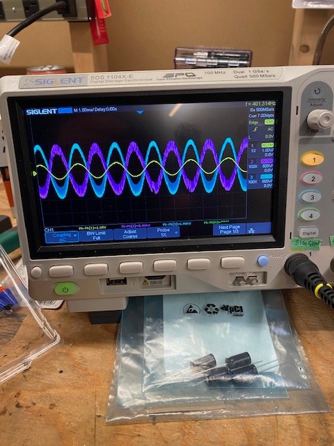

I have had these for just over a year and they sit for weeks or months as I get inspired or not. When initially rebuilt (see my other threads) the dc voltages were all within reason. However, I soon discovered that both amps suffered from what was to be oscillation manifested by white type hash noise on the program material and sometimes wildly going off and driving operating current up and blowing fuses.
Over that time , lots of hair pulling, ferrite beads wire routing and the like proved to have no effect. I am pretty competent around tube electronics but I have a healthy respect for these as trials take longer as safety is paramount for me.
In the end I have zeroed in on the power transformers in both these units as being faulty - perhaps modulating and beating through the different windings and causing the oscillation. Both units came to me in operable condition with blown apart tubes in one and popped caps and rectifiers in the other. These ran away at some point.

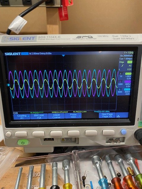

I had new transformers wound with a bit of experimentation to arrive at the final design. One for both heater supplies and preamp board 60v and one for the high voltage. I am going to do further experimentation but right now the new transformers totally clean up the oscillation.
The yellow trace is input and purple and pink traces are at the +3200 and mid point --- see before and after.

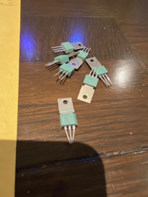

In my quest to isolate the source of oscillations I managed to track down a quantity of original spec Toshiba PNP S1376 driver transistors directly from Japan that were part of the original boards back in the day. I can confirm that the substitute Central Semiconductor CEN-U57 works as well - its available from Mouser and Digikey for the moment and has original pin out ECB as well.
