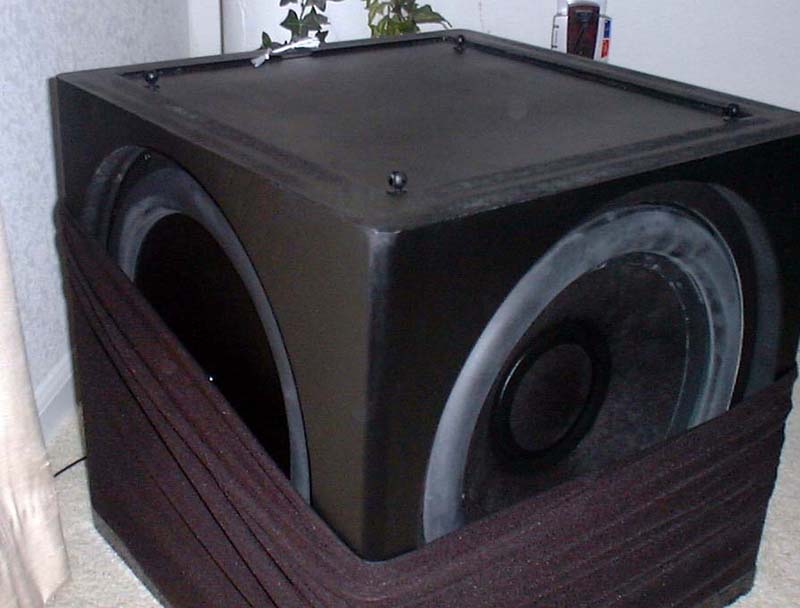

ok, so here is the deal. first off, im crazy. currently i have a deftech sub (its a special order piece), its 1800 watts, 1x 14" active , 2x passive radiators. goes down to 12hz, and will do 110dB+ at 20hz. but its not enough. sure, ive broken things already, and set off people's car alarms, but i still want more.

direct from definitive technologies. it retails for $1700. i was wrong about frequency response though, it hits 11hz, not 12 🙂
its only problem is that its built more solid than my house. it treats my house like its cardboard... (its as 16.5" cube, at 111 pounds)

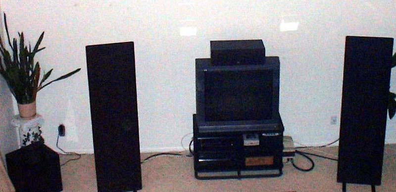

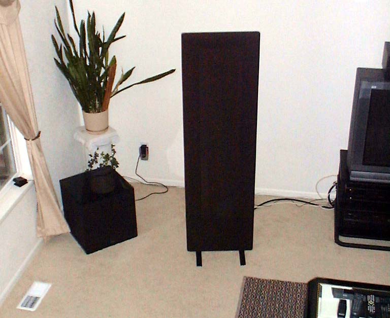

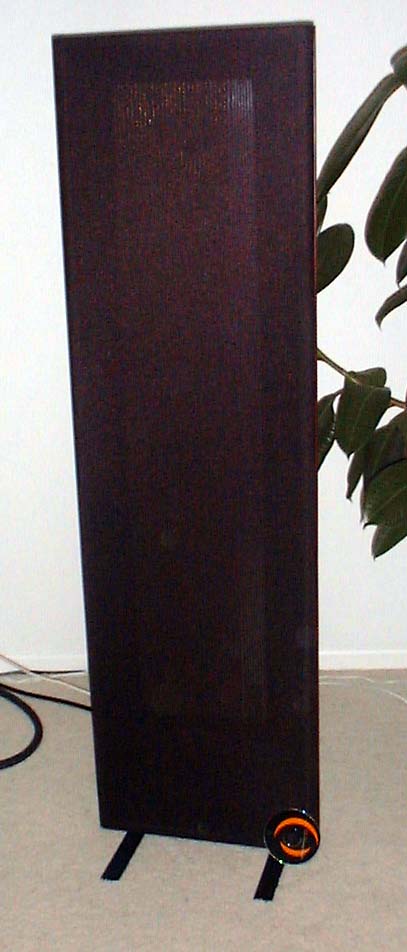

sure, let me get some pictures. i have a digital, but its crap, so you might have to use your imagination. its a very modest system, but it sounds good. my weakest link is definately my amplification/preamp. im using a yamaha receiver right now (which surprisingly works well), but it will be replaced with a rotel or B&K pre/pro, and the alephs in my icon. all in due time, im just a poor college student!
here is the system rundown:
sources:
kenwood sirius satellite radio
NEC SCSI cd transport
Denon DVD-2200 dvd/dvda/sacd/cd
amplification/processing:
yamaha rx-v1300 (110x6)
3-channel gainclone (still in progress)
fosgate audionics M60 (60w monoblock for transducers)
speakers:
fronts: magnepan 1.6QR
rears: psb image 4T (soon to be maggie MG12's)
center: psb image 8c
4x bass transducers in floor boards
definitive technology supercube reference
cables:
synergistic research mark II speaker cable (fronts)
audioquest cv4 (rears and center)
synergistic research audio 2000 interconnects for SACD/DVDA
audioquest YIQ-1 component cable
audioquest VSD-1 composite cables
virtual dynamics basic power cord
signal power power cable
tara labs space and time bi-wire (fronts)
