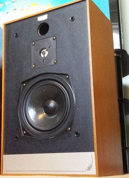

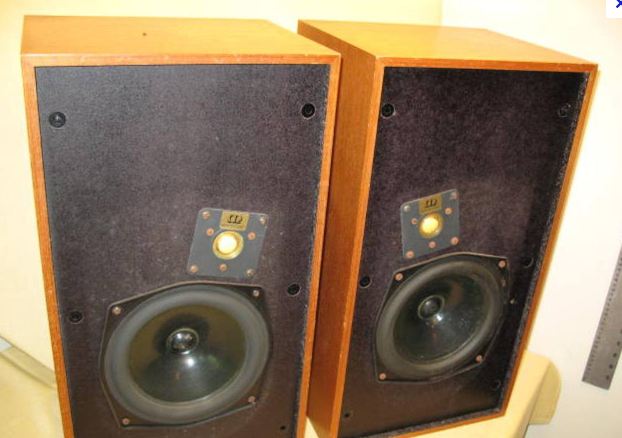

Hi all, I've had a pair of Pageants since 1981 and always liked the openness and easy driving of the speakers, however, the bass was always papery and after owning some Spendor A6 speakers and some Q acoustics concept 20's, I feel the cabinet design could use an update.
I've been hoarding DSB208 units and spare Pageants sourced on Ebay and want to build a much dampened set of cabinets for them based on the new style of narrow and long instead of wide (as was favoured in the seventies).
I would also like to replace the tweeters if appropriate to improve on the sound, and perhaps the XO but the speakers are very much based around the DSB208 bass/mid unit.

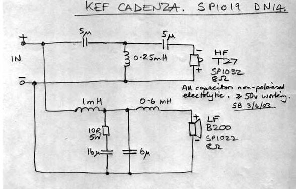

Crossovers are two a penny really. There are probably half a dozen ways to build a two-way, the best of which is the old BBC ideas IMO:
Rogers Loudspeakers › LS5/9
It's based on impedance correction and passive bafflestep giving an easy amplifier load:
mh-audio.nl - Home
You then need to build something:

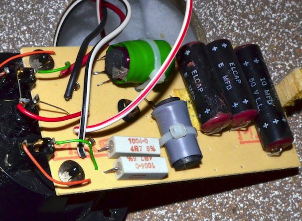

What you seem to have is a 7-8" paper bass, probably about 0.9mH inductance, and the famous old polycarbonate Isophon KK10-8 tweeter.
I think you must start by tracing the crossover circuit to have any idea what you are doing. Most people give up at this point, IME. 😀
