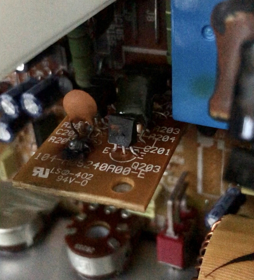

How are you guys doing? The sub emitting strange noise when on. I opened it and found one resistor and transistor is burned on the daughter board. I’ve search and could not find the schematic diagram online. Any ideas?

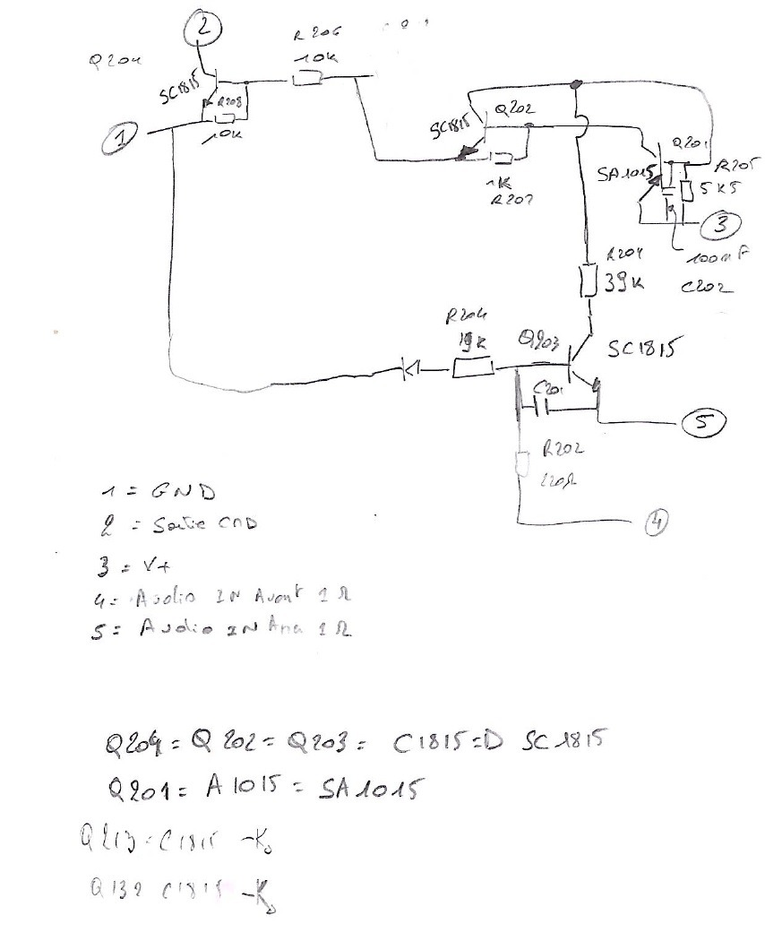

howdy, it may use the same board as a Mordaunt Short 909 which uses the same 12" driver. Apparently its the same board as an EV sx180. I have attached a link to the schematics at bottom but if you need any pics of mine, let me know. I just picked up one of these Mordaunt Short subs from a garbage tip shop for $10. Opened it up, masssive burn marks underneath apparently from transformer running non-stop... Im hoping to get mine up and running...
