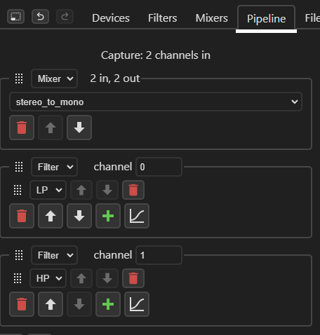

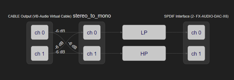

Is it possible to setup in CamillaDSP with Moode audio following configuration?
https://www.diyaudio.com/community/...overs-without-measurement.189847/post-6680665

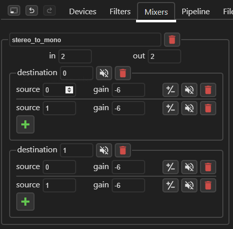

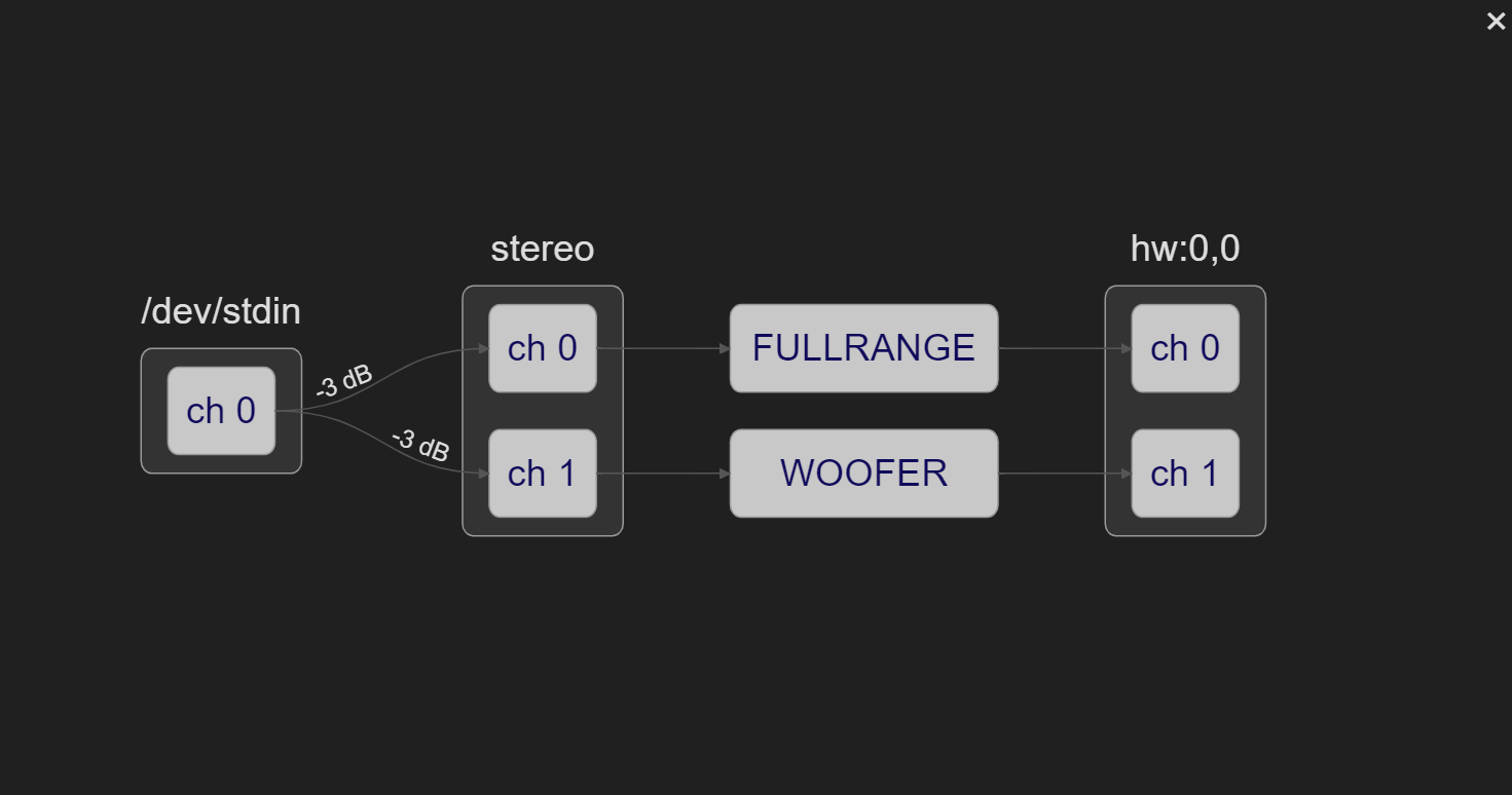

Use the mixer to copy one channel to other for a mono output and then design the crossover within the left and right channels connected to the HF and LF driver of a single speaker.
Propose of this setup will be find best XO for two way speakers. Is it setup bellow OK is it possible to have capture playback channel only 1.

You picture don't do mono. In order to obtain mono, you need to mix channels and then, recombine. I don't get the linked idea...
I have put capture channel 1 but it doesn't work return error and return back to capture channel number 2.You picture don't do mono. In order to obtain mono, you need to mix channels and then, recombine. I don't get the linked idea...
I use UPNP for Tidal in Moode and I would like first 2 channel put in mono and than split to 2 channel
