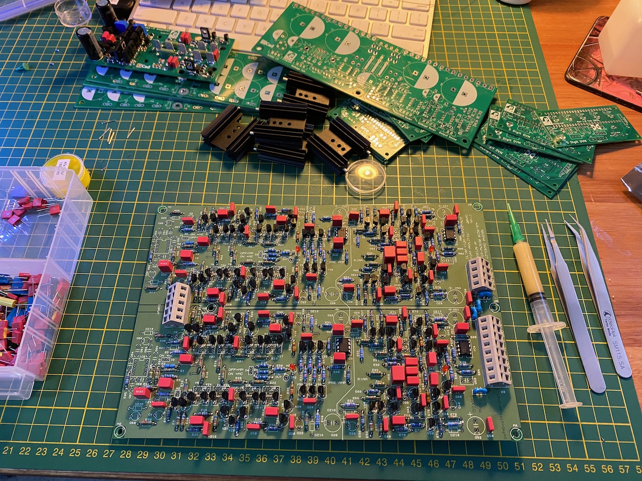

It begins!
It’s a lovely board. I like the use of E12 resistors exclusively. It means I didn’t have to order any in. The caps, are beyond my meager stocks of Wima film caps, and there’s no way I have enough BC550/560’s, so an order to Mouser is going out.
