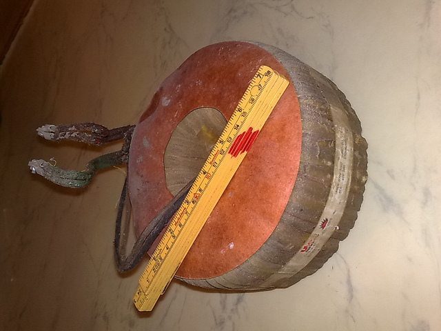

Well. I just have to believe what is written on the label. It is a transformer that I have picked out of a scrapped battery charger. The charger was 24V 50A. It is a Toroid
I go away for a few days. I can post some pictures when I'm home again.

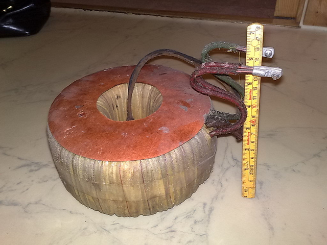

Back again. Well, the transformer is not in 60A, but 58A. It weighs 14.9 kg.
The point is not how large and heavy transformer is, but what kind of amp it is useful to. I have seen many good amplifier projects here, but most will have a voltage of 2x50V and up. Just for fun, just to see what is possible. It could be a future project.
The two secondaries are connected in paralele mode..
So it s surely a 2 X 40V 29A transfo, i.e, 58A as connected.

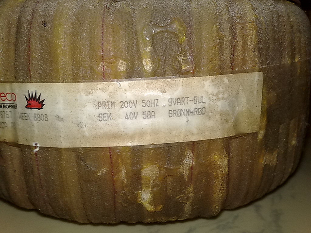

the label says input 200V.
Can it be used on a 220Vac supply?
Impossible to tell, it depends how hard the core is running at 200V.
Connect traffo to a variac (it only need be a 500VA) with a current
monitor on the variac OP. Wind it up slowly from 0 to past 200V, note
the voltage where the current increases quickly (the knee). This will
be the core saturation voltage.
You want to run it less than this voltage.
T
Are you in 50 Hz or 60 Hz territory? The trafo is 50 Hz rated. If you operate at 60 Hz, you could put 220 or 240 on it no problem.
Looks like Norway is 230V / 50Hz
Mains power around the world - Wikipedia, the free encyclopedia
There's certainly a chance it will still work as plenty of traffo winders are quite
conservative WRT the magnetization level they run cores at... but others will
run the core within an inch of it's life to make the traffo physically smaller.
You'll never know till you check it.
