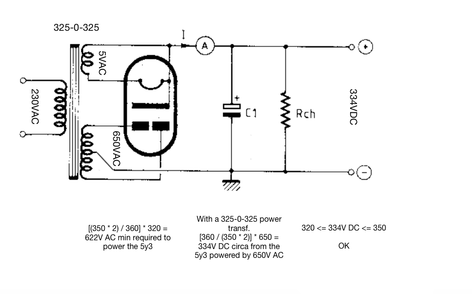

First of all thank you for the reply.
Second, I have a General Electric 5y3-GT tube of which I found copy of the original specification sheet (please see the related attachment).
It is clearly shown that using the tube as Full-Wave rectifier with a apacitor Input filter (respectively - 20uF and 100ohm) and powering its plates with a total of (350*2)V AC it is possible obtain a 360V DC ready to use.
Performing some calculations I obtain that the minimum voltage required to power the tube in order to obtain 320V DC (minimum required by the MONOphono preamplifier) is 622V AC.
So using a 325-0-325 power transformer I can power the tube with a total of 650V AC obtaining circa 334V DC (less than 350V DC which is the maximum voltage usable by MONOphono preamplifier).
Please see the schematic of the PSU (calculations are included).
Do I have to scale the capacitor and the resistor values too? (I think no) Do I still have to use the indicated filter choke (please see the schematic of the top first post) after the capacitor filter input?
If all this is correct can you please provide me a brand and the model of the needed power transformer (it should work whit primary of 230V AC - and what about the mA?; I saw online many 325-0-325 that provides different currents)?

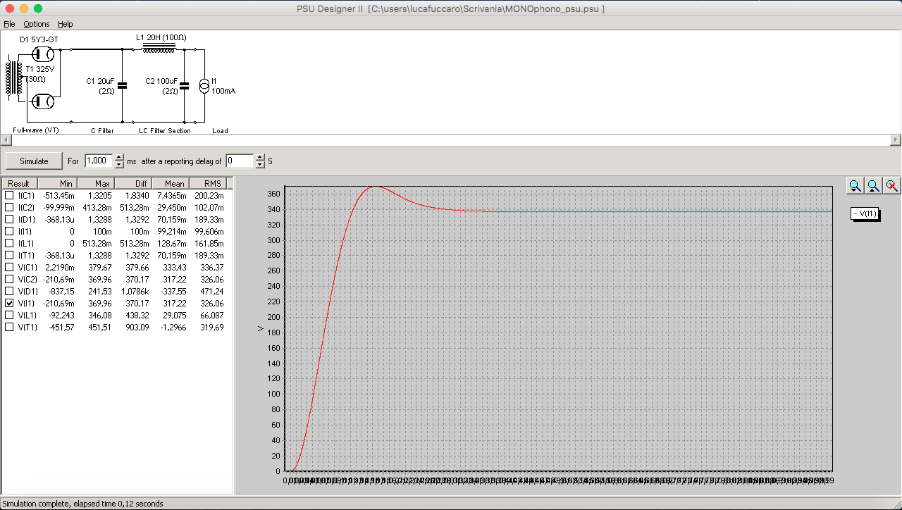

You still need the CLC filter I mentioned in one of my earlier posts, you need to knock the ripple down to very low levels unless you want a lot of buzz.
Don't exceed the maximum input capacitance value for the 5Y3, use something on the order of 15 - 20H with a DCR of a few hundred ohms, and a large electrolytic on the output, perhaps 100uF or more.
Use PSUD to design a supply with well behaved supply voltage ramp up and low ripple.
I'd aim for the middle of the recommended voltage range at a nominal mains supply of 230V.
I can't make specific recommendations on chokes or transformers given you are in Italy and I am in the U.S. There must be local vendors. Look at Lundahl, and perhaps some German or French makers.
Thanks for the reply. See, I'm a novice in the "diy tube amplifiers and preamplifiers" field. Please be patient because I never used PSUD before :dunno:.
Please see the attached result. I obtain a 326V DC but I have doubts about the "source res" value (30ohm) of the power transformer and about the "load amperage" value (100mA). Did I have to change them with other values? If yes which? If this is correct, which amperage value should have the power transformer (a 325-0-325 transformer seems to be right for the purpose but there are many with different amperages)?

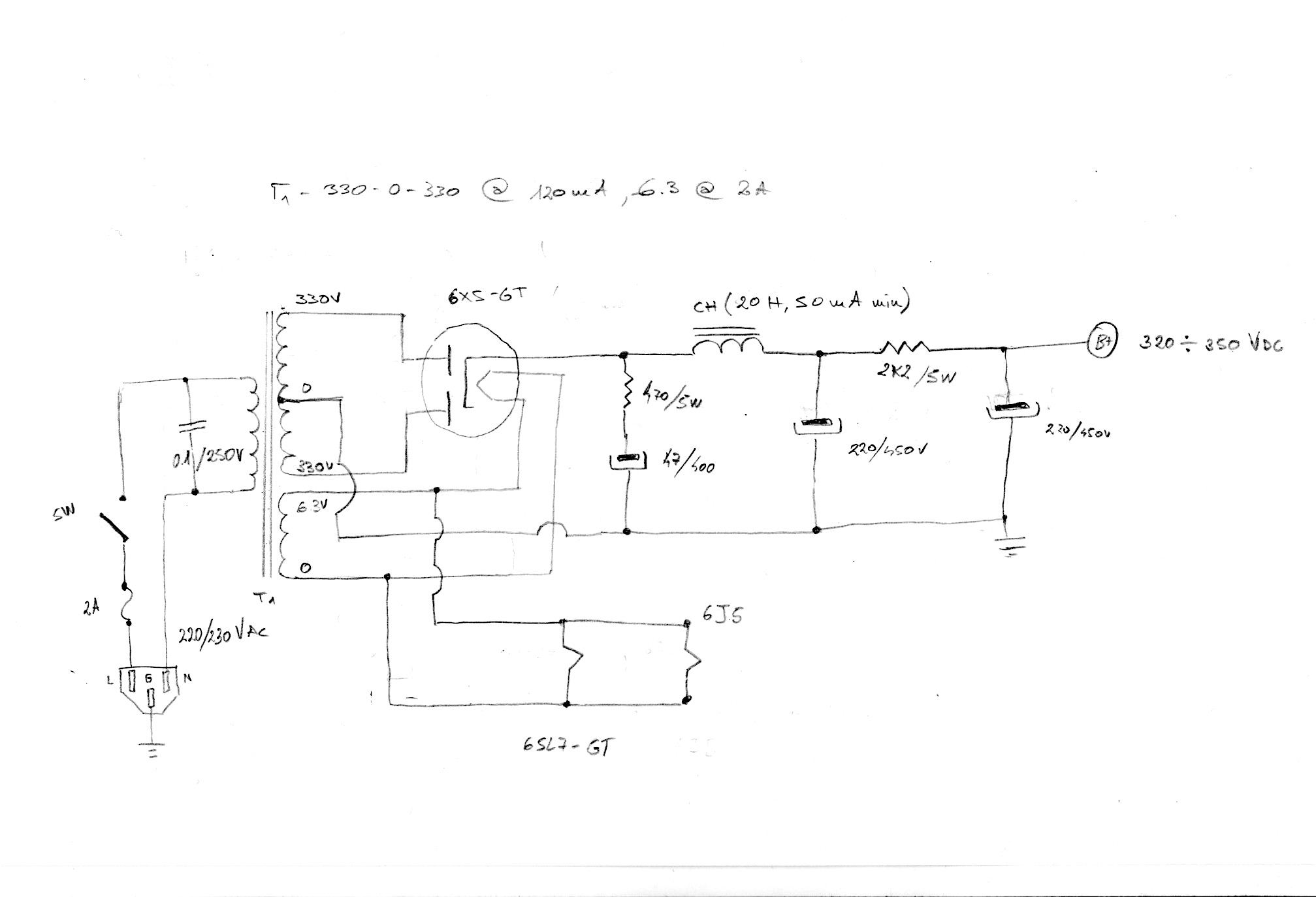

Hello Carter,
following the Diego Nardi's schematic of the PSU for the Phi 42 Phono Preamp (click here) I extract this PSU schematic. Is it adequate for the Monophonic preamp? What do you mean exactly with "a separate, raised heater supply for the 6SL7"?
N.B - I will use all GE tubes. GE 6X5-GT has a separate heater/cathode.

The direct coupled cathode follower output tube is a 6J5, which is half of a 6SN7. The circuit raises the cathode voltage. The peak voltage difference allowed between the heater and the cathode of a 6J5 is 90V. That voltage difference is a source of noise. So Diego uses a separate supply for the 6J5 heater. That supply can be allowed to float or can be raised to a value within the tube limits. The 6X5 allows 450 volts heater/cathode, so it will be ok. Diego also used DC supplies, which are quieter, especially in a low level phono amp. It's all in Issue 14!
