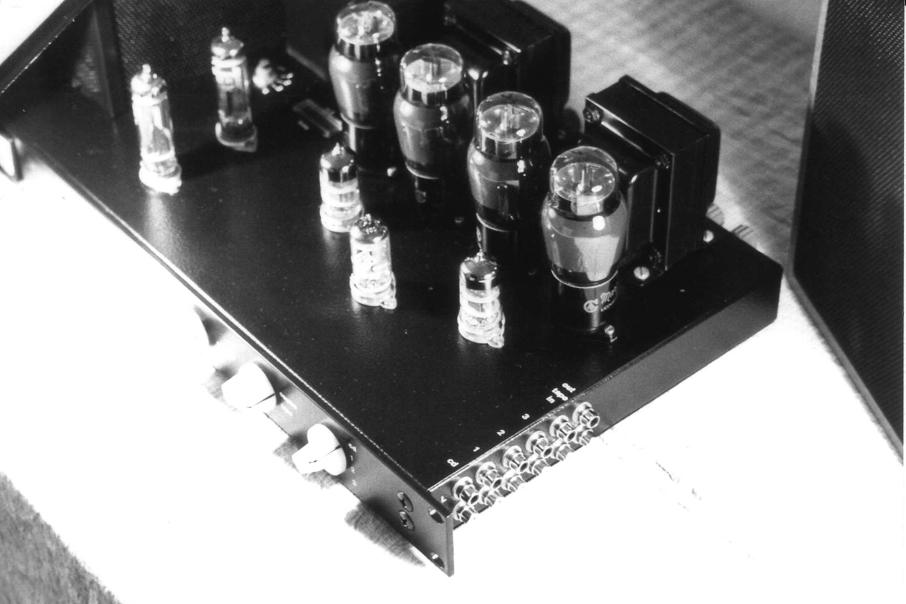

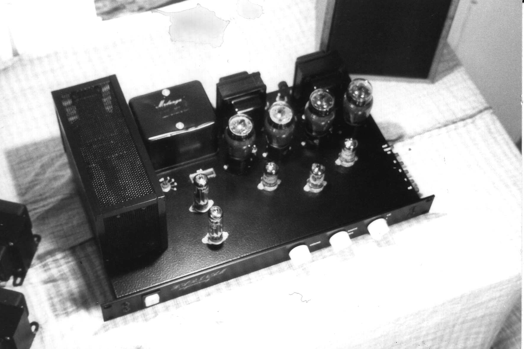

I'm with TG with this one, all in one case but fully separated power supply's for each channel giving the best sound to my ears...
My first tube amp 6V6PP was like that... all line level inputs - just like Audio Innovations 700 I believe... but lower power of course🙂

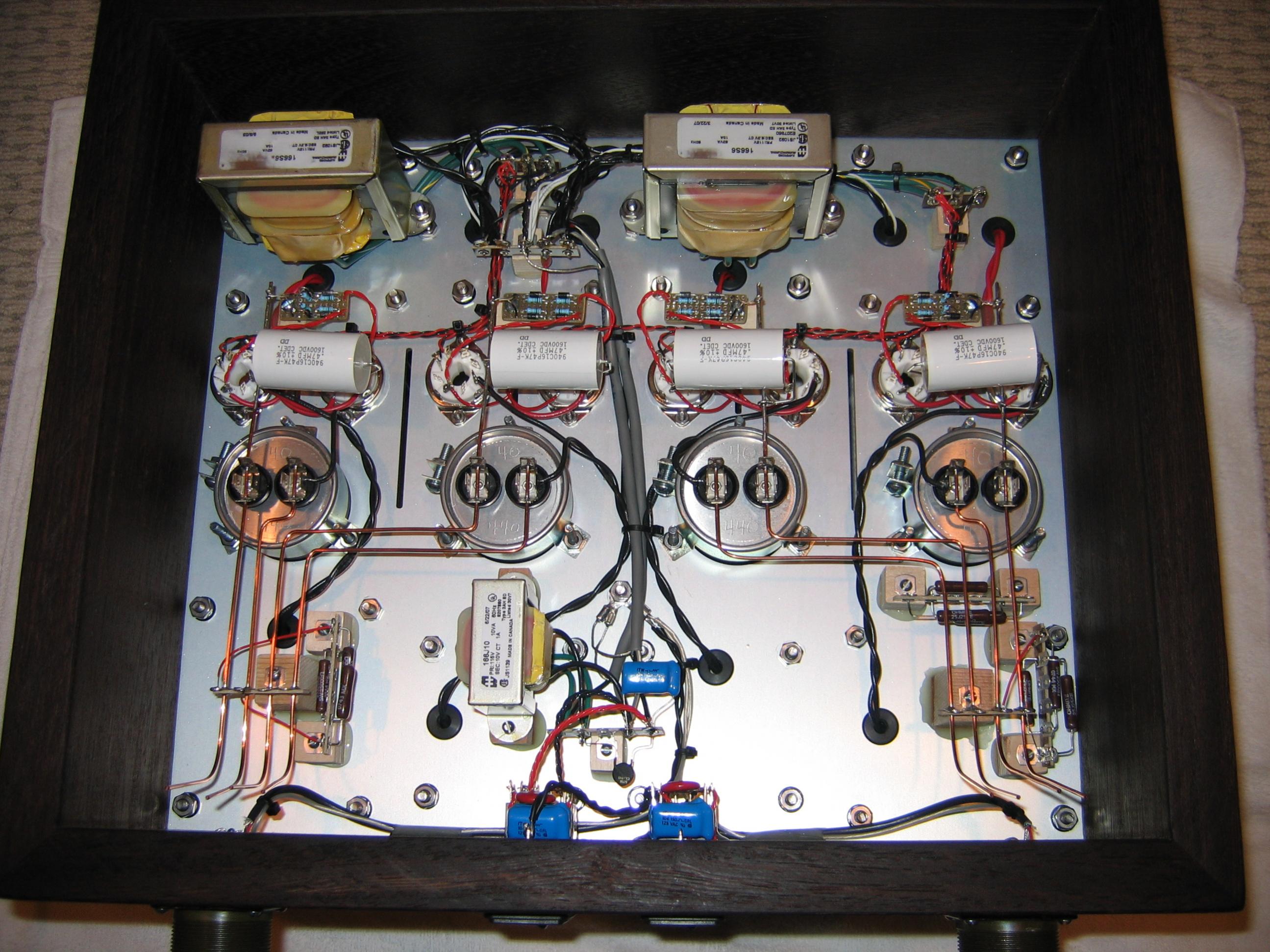

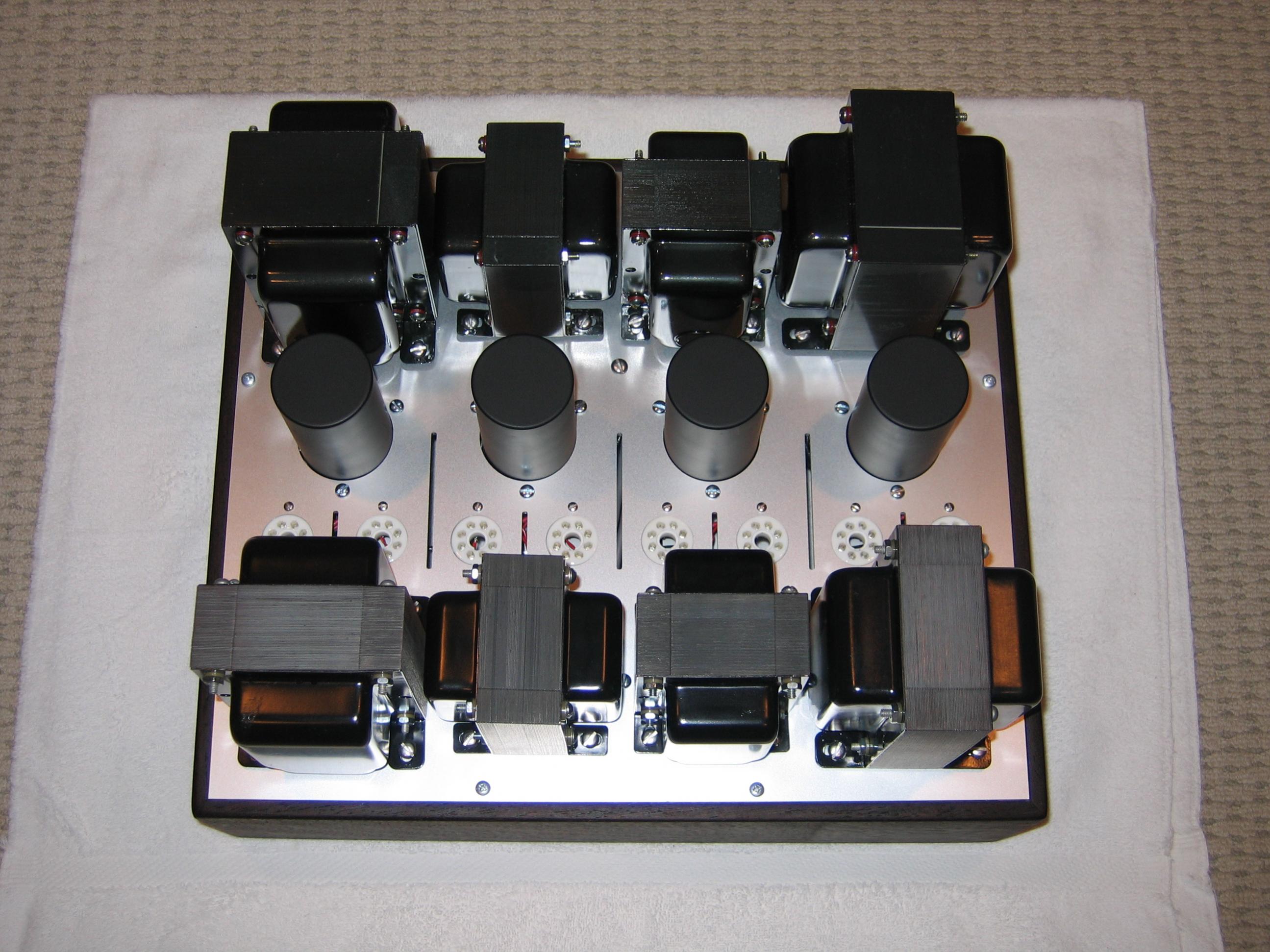

I followed ReinoutdV's example (just a lot smaller than his 833/TB3-1000): mono's with their own separate power supply chassis.
Even so, the PSUs are still backbreakers.
No doubt - this is just the power supply. Left output B+, left input/driver C+, right output B+, right input/driver C+. No way you could squeeze this all on one chassis and still fit it in a rack, much less lift it. If I recall, this power supply was in the neighborhood of 75 lbs.
Really depends on the size/complexity of the build. A flea amp is no challenge for physical build.

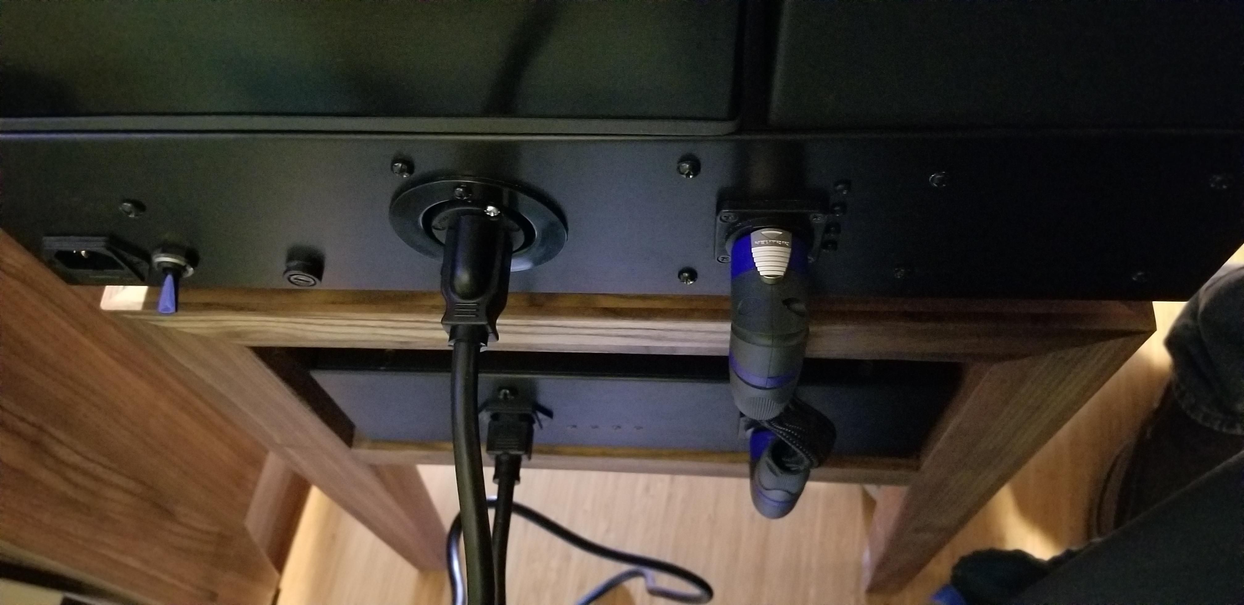

Well, I went the monoblock all-in-one-box route with my Midlife Crisis 833C amps with excellent results for 7 years. 300uV background noise at idle with input shorted, faint buzz if you put your head to the midrange driver. Almost too heavy for two men to carry to my workroom. Dangerously heavy.
Now I'm pulling the 833C filament and 6E5P DC heater supplies into separate boxes, which should save 15lbs or so and allow me to double the amperage rating of the first choke in the LCLC filament supply. One side done and now the amp is absolutely dead silent with ear to the driver and somewhat easier for two men to carry.
Using 4-pole right-angle speakons to connect the boxes, plus a standard IEC power cord.
