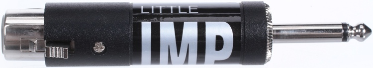

By "mono" do you mean unbalanced? The XLR DI output is not stereo. That is why we call the plugs TRS rather than stereo plugs.
You can't convert an unbalanced signal into a balanced one with just a connector. They do make impedance adaptors though.
A balanced line has value running long lines. Short runs, they don't help you.

Excuse my ignorance please and please would you explain why you can't convert an unbalanced signal into a balanced one with just a connector.
And how is the following of interest?: "They do make impedance adaptors though."
