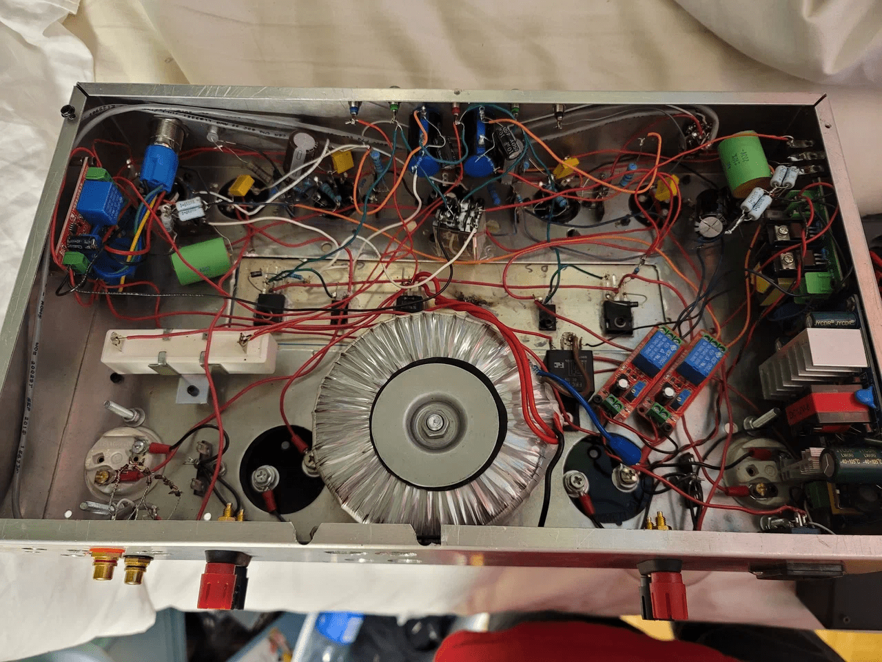

Flying leads you say? I wouldn't worry about it. This ugly mess works perfectly.... and I've read threads where having even short fly-leads between the amp's PCB and output devices was said to compromise the performance (or stability).
Gosh yes, that is quite... busy. It isn't quite the style I was intending, but I'm glad to hear it works for you. Though I suppose that doesn't 'necessarily' mean it would work so well for me; a different design of amp and different circumstances could presumably mean a different result.
Thank you, that makes sense. I can see how it might be possible to at least factor that in to the design now, though with my level of (in)expertise it would probably still be safer not to go there. I suppose there could be additional risks, such as interference picked up by loops, unless it was done quite competently, too.They usually specify 1nH of inductance for 1mm of track/wire.

You have to define “perfectly”. Getting it to work, sure. Getting every last ounce of performance out of the components/topology, probably not.Flying leads you say? I wouldn't worry about it. This ugly mess works perfectly.
I don’t try to get amps to work DC to 2 MHz either, even if it would be theoretically “possible”. I have no beef with 4MHz fT outputs, because I’ve found ”better” ways of minimizing crossover distortion. Some of which are considered sacrilege.
