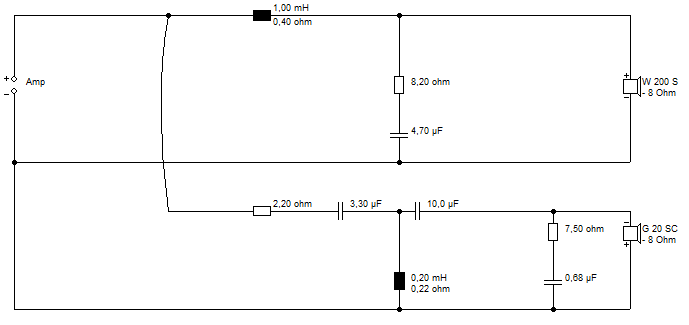

Fenalaar told us what the typical 1" MA tweeter filter is:
http://www.diyaudio.com/forums/multi-way/305080-monitor-audio-r352-crossover-2.html#post5018607
My R300-MD had a second order filter on the 3/4" tweeter, 2.2R, 3.3uF and 0.3MH and a 1.6mH bass coil:
Not rocket science, and guess what, tweeters blow like crazy on all these designs! 😱

I'm using a proper crossover these days. Built it myself. Below:
X/O is one 1.1mH coil, a 2.2 ohm resistor and a 3.3uF cap
