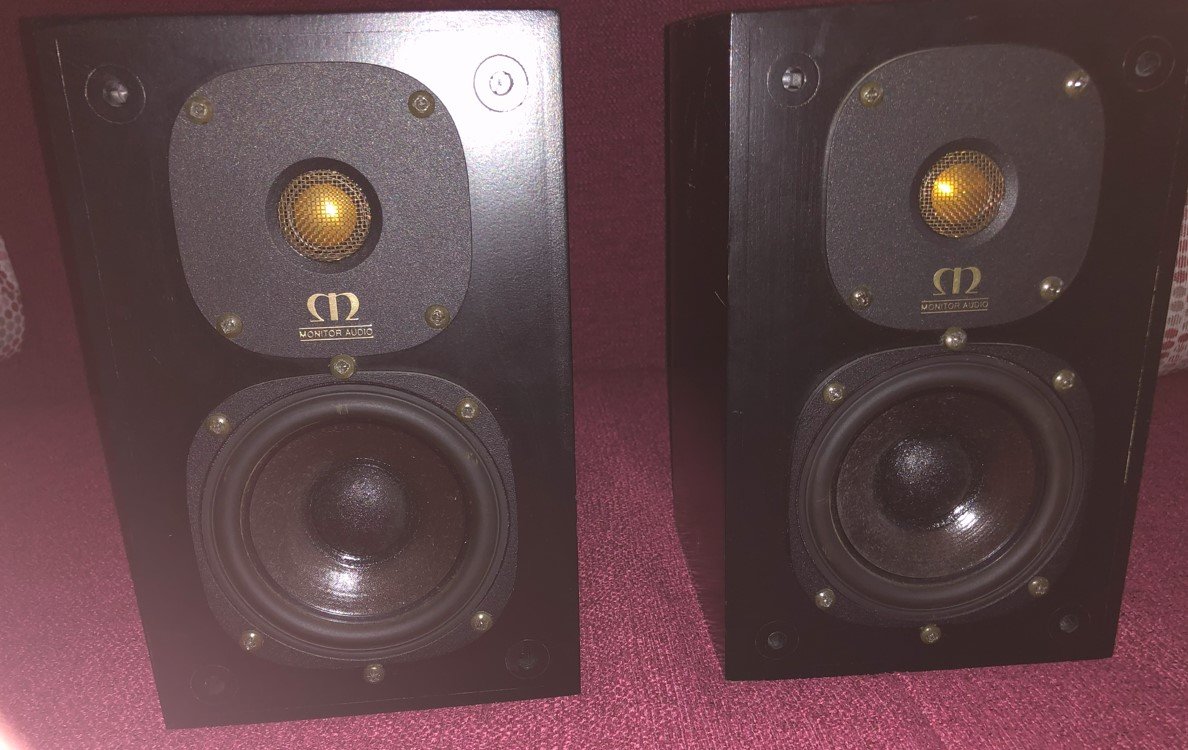

i am thinking about the recycling of a very old pair of Monitor Audio Monitor One speakers
I have some very different chassis already available for the exchange of the old chassis

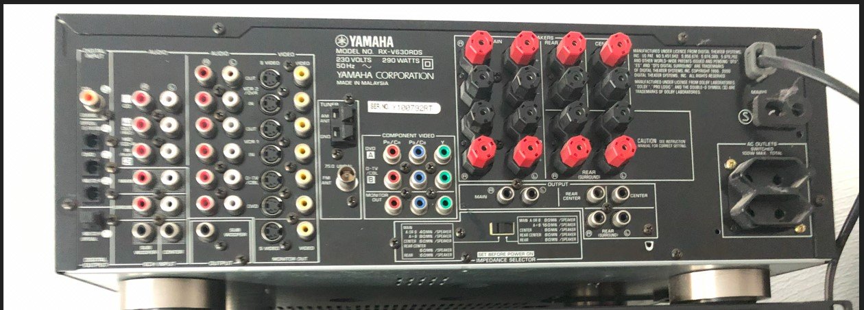

best thing would be to flip to something like Hypex FA122 but for the first development approach i will probably use the power amp section of an old Yamaha AV receiver

These Monitor 1s must be the baby brothers of my Monitor 3s! Mine were bought early 2001 and were from an earlier year, so at least 25 yo. Yours look very similar but not identical. Possibly a bit better drivers?
Fitting a Hypex FA module in an existing box needs checking of the dimensions. Depth can be accommodated outside the back of the existing box, but H and W need to fit within the front profile.
Using a multichannel receiver is a clever and cost efficient way, but as any external box will add cabling and use up lots of space, but will also make the box work much simpler.

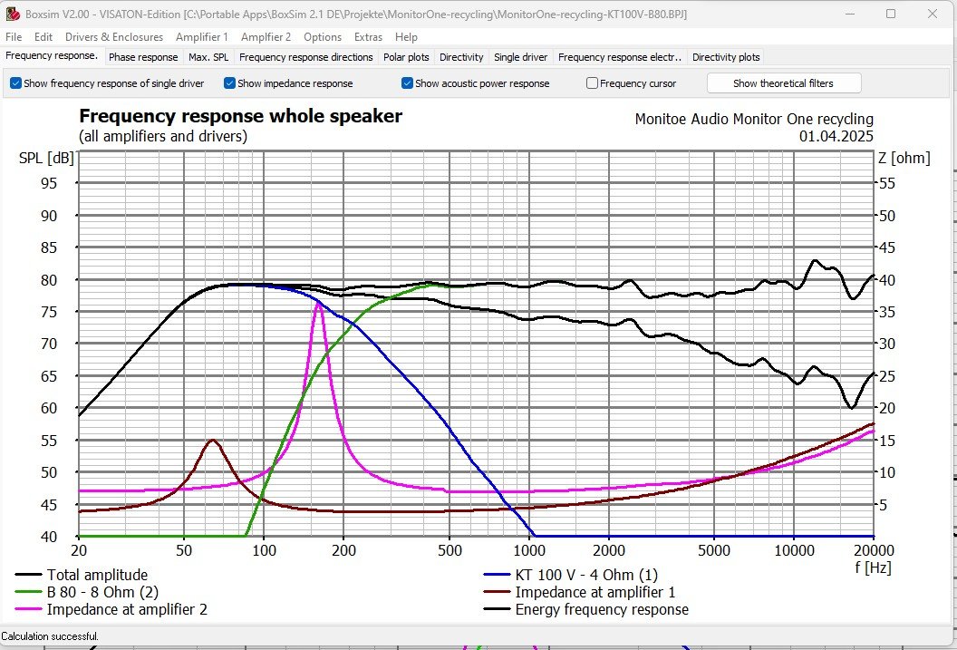

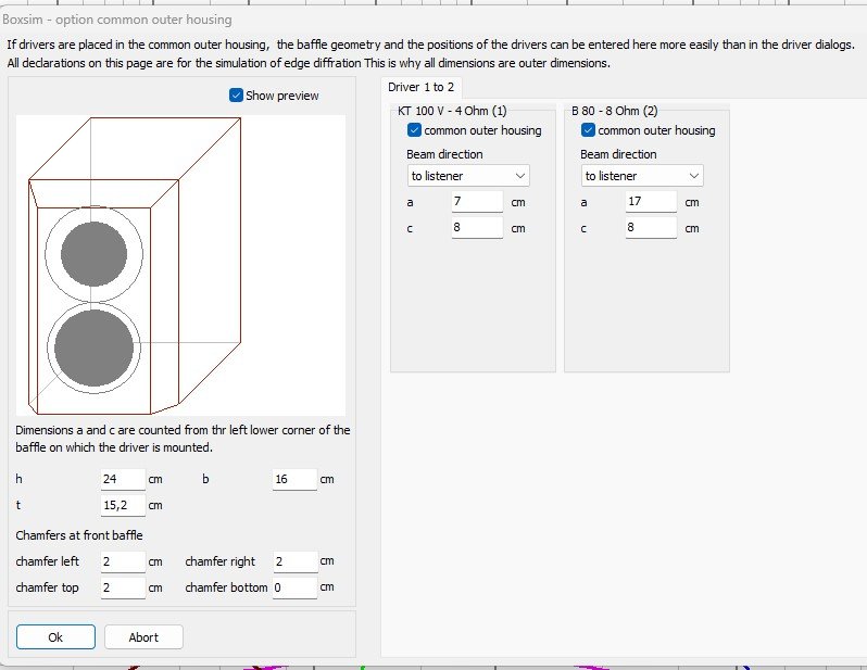

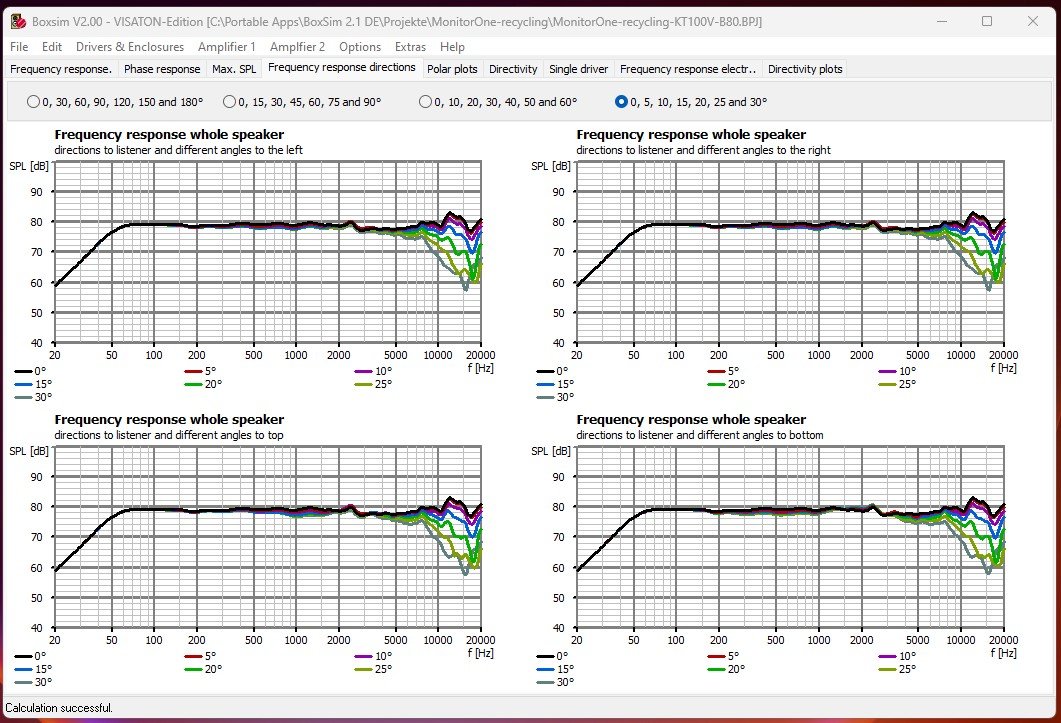

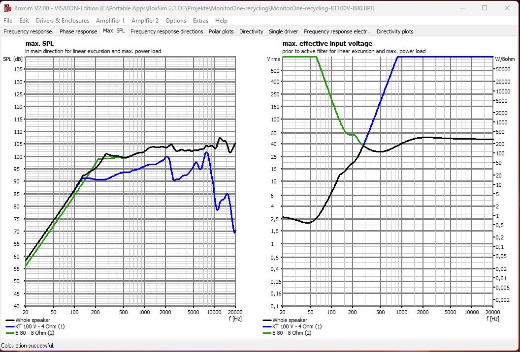

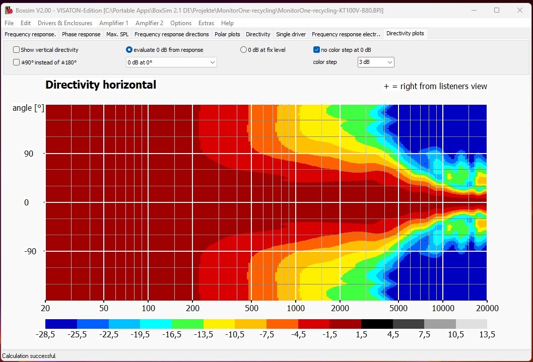

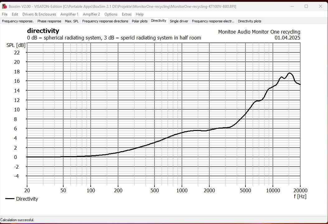

i have 8 Visaton B80 chassis in the drawer and want to use 2 of them, first idea is to add a small SW chassis like the Visaton KT100V or something similar even cheaper that fits in the small Monitor One cabinet - tried first the W130X - does not fit in the cabinet
C ) Visaton simulation screenshots for B )
next post before this post times out anyway
Visaton Boxsim screenshots and project file for KT100V + B80
KT100V-B80-Cabinet.jpgKT100V-B80-FG.jpgKT100V-B80-FG-0-30-degree.jpgKT100V-B80-Max-SPL.jpgKT100V-B80-Drectivity-Graph.jpgKT100V-B80-Drectivity-Plot.jpg
most notably the max SPL in the bass will suffice only for very low listening levels in the low frequency area, this is more something for a near field monitor on the desktop

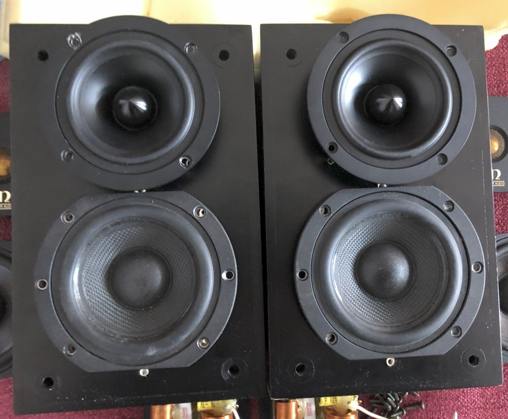

the very first trial could be to keep the Seas bass mid range chassis and flip the tweeter probably very degraded in performance after 30 years with the 3.5 inch full range chassis
so far - so good, Stefano

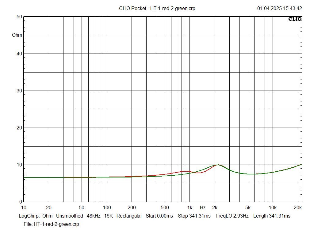

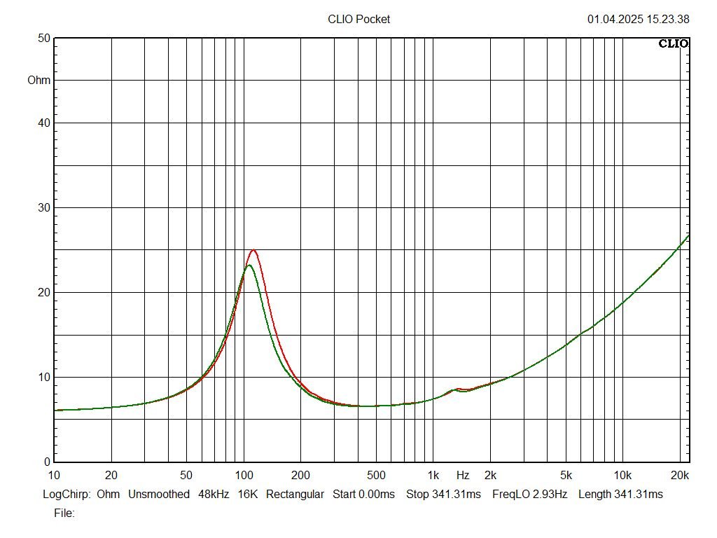

CLIO pocket impedance measurements old chassis
tweeter impedance coincidence red green isn't that good anymore
most likely ferrofluid degradation

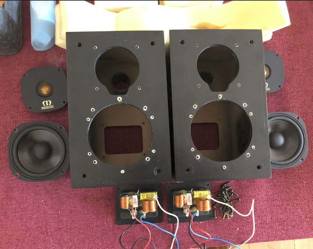

first replacement approach with 2 Visaton B80 FR chassis and two 4 inch woofer replaced with other woofer with better mid range performance in an active near field monitor some years ago - for the low crossover to the FR and active EQ they should be good enough
my problem is that i am a terrible carpenter, but it should be possible even for me to build a new baffle for the old cabinet
in addition to the last post i remember now that some years ago i made some tests with the change of the old Seas woofer with the other one coming from the Adam ARTist 3 active monitor in the 2nd picture for the first replacement approach
in the meantime i am not sure if my post make any sense at all since i doubt that the cabinet build quality and the degradation of the quality with the testing in the past years is worth to keep it
