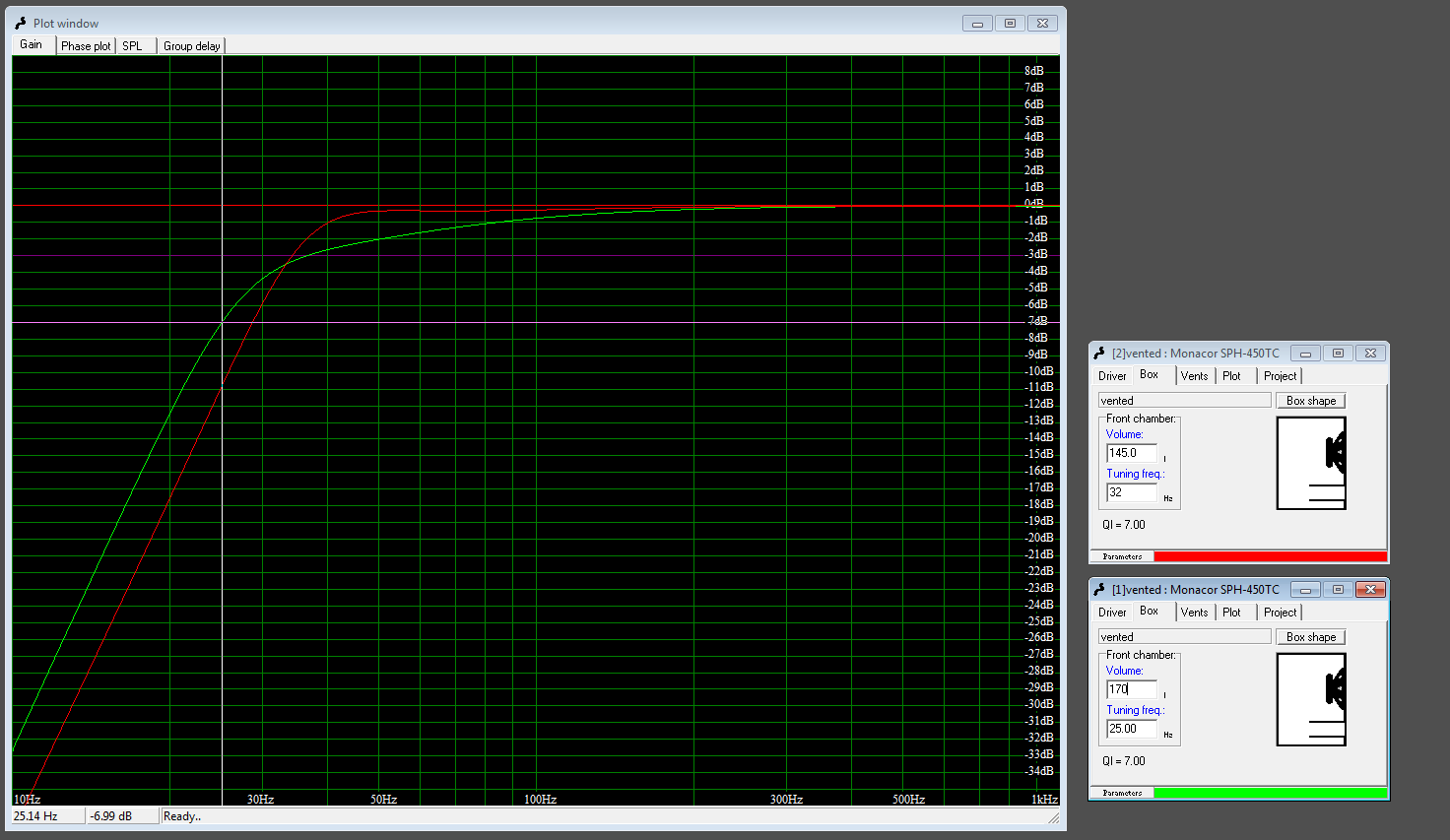

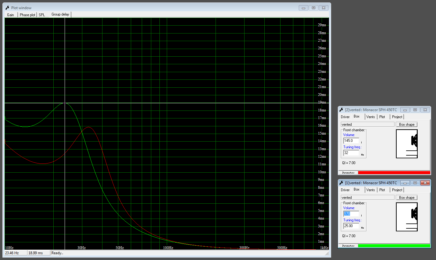

Hey!
Have been playing around in WinISD a bit over the last couple of days and am not really sure about what I should be looking for. Have dropped the tuning down to 25 Hz, however this now gives me a pretty sizeable rolloff... I have found 170L is about the max I can push the box size before it gets lumpy!
With this 170 I’m getting about -7db at 25 Hz, with an f3 of 35.4.... Given I never had the opportunity to actually listen to how different boxes perform and how noticeable that 7db down low is going to be, should I be concerned?
Have done quite a bit of reading about TH's, and I really think that for my level of expertise I would end up getting a worse speaker than if I just want a BR.... (Boring I know!)
Ports at the moment I’m looking 4 at 4*68mm*353mm with a Mach of 0.05. Does that sound alright? Again I’ve never got to play around with differences in port diameter. As I understand it the bigger the port the less velocity, meaning less chuffing?
Felix
