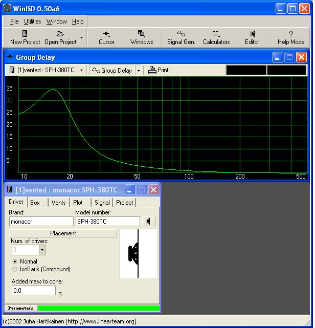

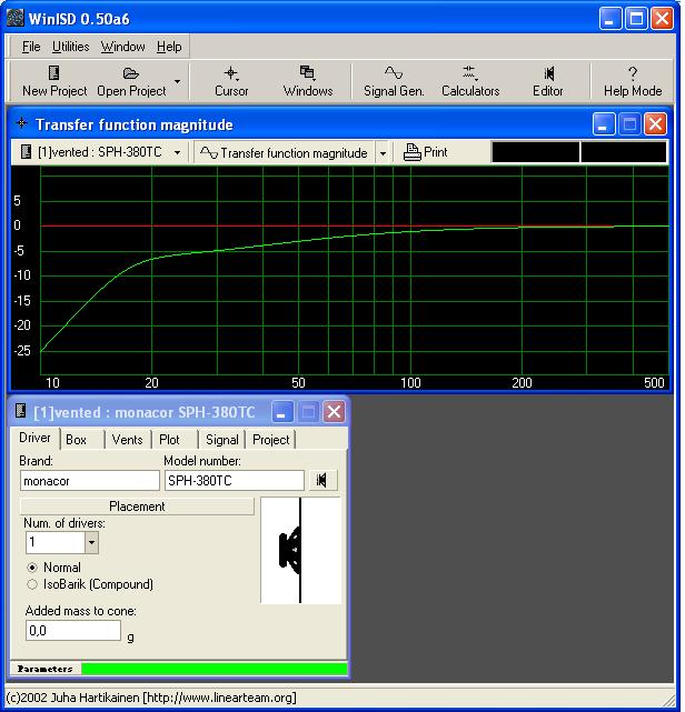

Hi
if you have the time pleas look at my design
T/s
the room is 6x20x3,5 meter
thanks
T/s
thanks
>Can some body help me make a Overdamped cabinet for this woofer : Monacor sph-380tc
An 'Adire' alignment for this driver using published specs appears to be 71.65L/17Hz, but unless you have a lot of room and/or corner loaded gain or live in an apartmemt or condo, I do not believe you will find it adequate for HT, though should be fine for music with some EQ shaping to flatten in-room response.
WRT your extended Fb design, it is OK as is, but considering the intended app and the driver's specs (if reasonably accurate), I would put it in a Vb = Vas/Fb = (0.707*Fs) ML-TL, with the VCs wired in parallel to keep Le low.
