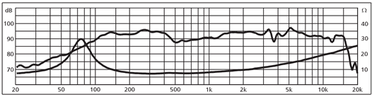

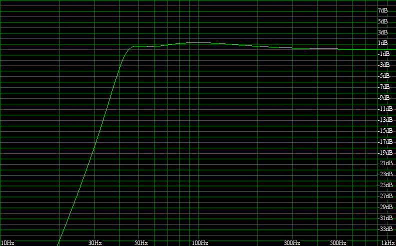

I've been mucking around with BRs in WINisd recentley, and having previously built a stereo closed cabinet for Monacor's SP-155X, as an external speaker for a television to sit on top of (not too critical an application, hence the choice of a rather cheap driver), I decided to see if it could be used in a BR enclosure.
Plugging the values into WINisd and changing the box volume to 50l, tuning at 48Hz it looks pretty good, with an f3 of about 40Hz, although a little bumpy towards the end but I'm guessing that'll help compensate for baffle step error. It also seems to have some degree of this built into it's response making a baffle width of about 25-28cm ideal, which also fits into the golden ratio dimensions using 18mm MDF.
The sensitivity is also decent, about 93dB making it good for use with an SE pentode amp. However, Qts is high (which means bass will be less controlled? 😕) and the Xmax is limited to about 1mm.
It is a very cheap FR, about £40 for a pair, coupled with some MDF cabinets with some faux grain painting (something I'm very proud of being able to do 😀) could make for a cheap pair of speakers.
I'm sure there's a catch to all of this though, go on, tell me how I'm wrong 😛 !

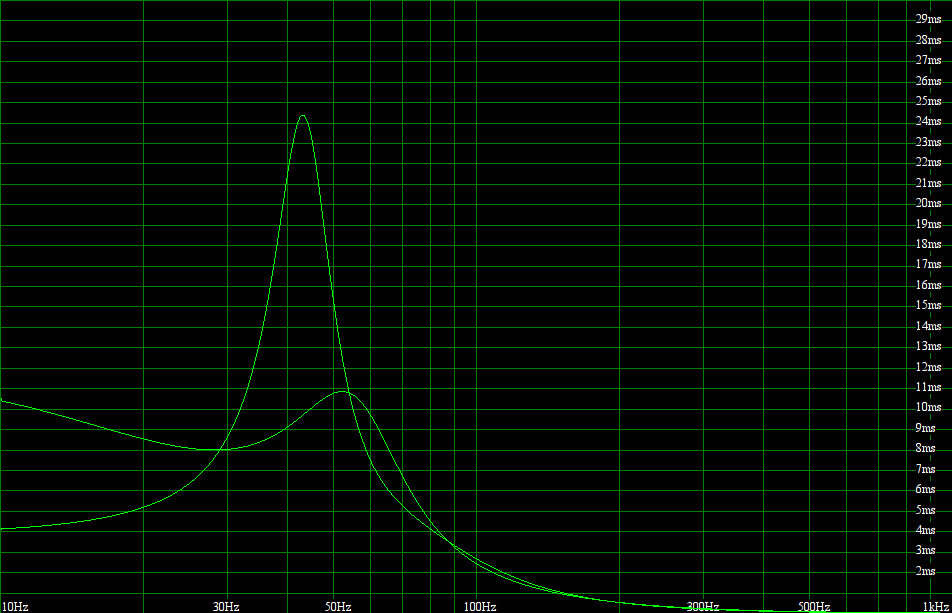

Hmm... The group delay is a little high, peaking at 23ms at 40Hz. Objectively speaking, will I hear this?
Here's the group delay graph, the lower trace is for a pair of MA A10P BRs I'm also rebuilding at the moment for comparison

The catch? It's not that inexpensive. I just think you were lucky. The price is between 40 to 50 pounds where I checked.
At that price I'd much rather get a similar Fostex with lower Qts and better materials overall, at a small extra price increase if any.
The extra dough for a pair of FE166 is well spent considering you could be living with them for a long time.
If not the resale value for Fostex is higher.
Alternatively FE126 is about the same, with likely a little less bottom, but more precision there and better dispersion and no wiz cone.
I'd say you get about what you pay for here.
If they had been something south of 30 it would start to look interesting.

I see. After a little further reading I realise this is a bad idea. I still want to use this driver for something as I heard it in a sealed enclosure in a previous build and it sounded excellent. Thanks for all your input 😀, I learn something new every time I visit this forum!
It seems a bass reflex enclosure is inappropriate for this driver as the Qts is far too high. Would it be suited to a MTLT, or horn?
