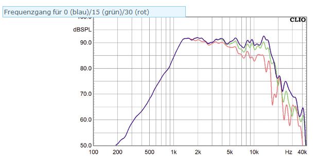

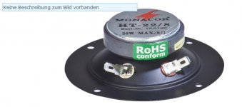

I know it is a bit of a minority interest, but a few of us favour cone tweeters. I like the sound of full range units, and find that a cone tweeter is the best way to emulate this sound, and give the benefit of flexibility and treble extension. I have seen one or two threads on the subject of cone tweeters, but I can find no reference to the one I use; the Monacor HP-22. (with a Monacor 135 AD, in a 8 litre aperiodic box, with a 3.3uF cap.). I consider it to be a really good quality tweeter, that is ridiculously cheap (£4.38). But don't take my word for it, this is what Klang+ Tom say:
"The unit at the most favourable price was the surprise in the test......provides the most balanced frequency response in front of the microphone.....very attractive price, to be used without any problems, offers best measured values."
Has anyone else used these?
Sorry, my typing error; that should have been HT-22. Although it only goes up to 15k, it is very incisive. I am not made too aware of the missing 1/3rd octave.
I'd like to hear more about this Monacor polycone SPH 135/AD and HT-22 cone tweeter setup of yours on first order crosover, midrange, otherwise I wonder what you are saying here.

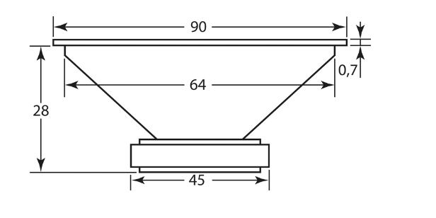

I didn't really like what I saw with the Visaton TW-70 cone tweeter on single capacitor, but the 92mm monacor unit has a commendably better and flatter response and may open up more possibilities. So tell us more. I thank you. 😎

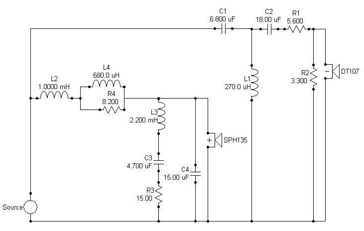

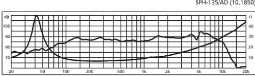

We've had a thread going on LS3/5a mini monitor clones lately, and folks have been looking at the Monacor SPH-135/AD as a possible cheap driver. Problem is deciding on the bass notch required with a higher order filter. In fact 1.5kHz seems right according to THIS THREAD.
Monacor SPH135/AD Qts of 0.37 and Vas of 26L is saying 10L closed box to me, and bigger for aperiodic(damped reflex) and reflex. Certainly 5L is on the boomy smallish side for this driver.
What you have done is probably keep the impedance valve friendly with your minimal filtering and aperiodic box along with high efficiency as noted. All in all, very interesting, though I suspect the cone breakup from the bass unit would annoy me. I'd suspect you've got to know what is good about cone tweeters to appreciate them despite their poorer dispersion. It's going to be a lack of spit and sizzle compared to a soft dome. Perhaps less sibilance?

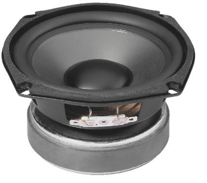

Include my usual heap of pictures of the 5" polycone Monacor bass unit and also some KEF Coda stuff complete with notch for the interested folks. 😎

Although Monacor advise a 10 litre box for a closed box loading with their 135 AD, this is for an system Q of 0.7. Whilst this is theoretically ideal, very few designers use it for a speaker of this size. Somewhere between .8 and 1.0 is more normal.

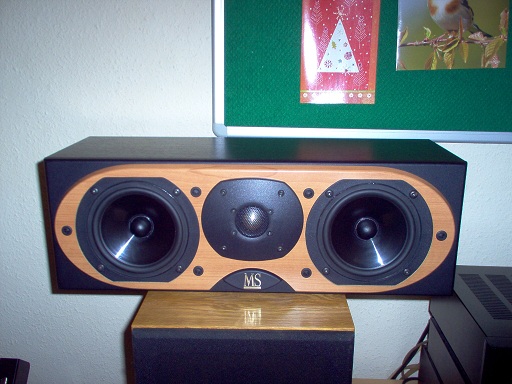

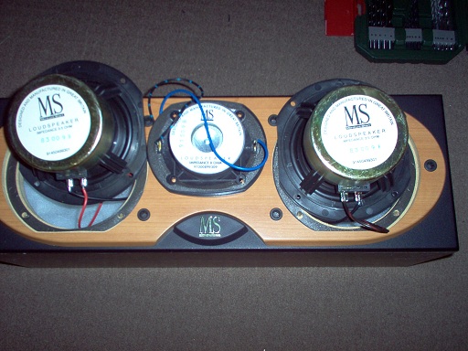

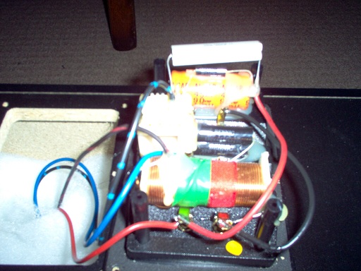

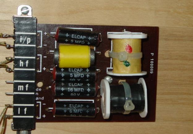

Can I go off-topic for a moment and ask you if you know what the impedance of the bass unit in the MS10 was? Reason being the ones out of the MS821C centre speaker are 3.5 ohms nominal wired in series. Haven't measured the second order crossover coils yet, but it's fairly standard 3.2uF treble capacitor and 45uF bass capacitor which I think I can rejig for single drive units.
IIRC, the MS10i was a single coil bass tilt and 2.2uF tweeter filter capacitor with 50 ohm resistor shunted across the tweeter.

The MS10i classic is rated as 8 ohm and the main drive unit just has a single coil in series with it which suggests to me a first order crossover and a 8 ohm drive unit.
