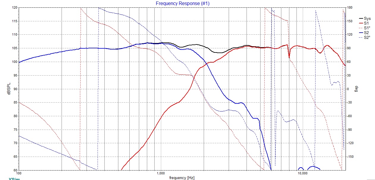

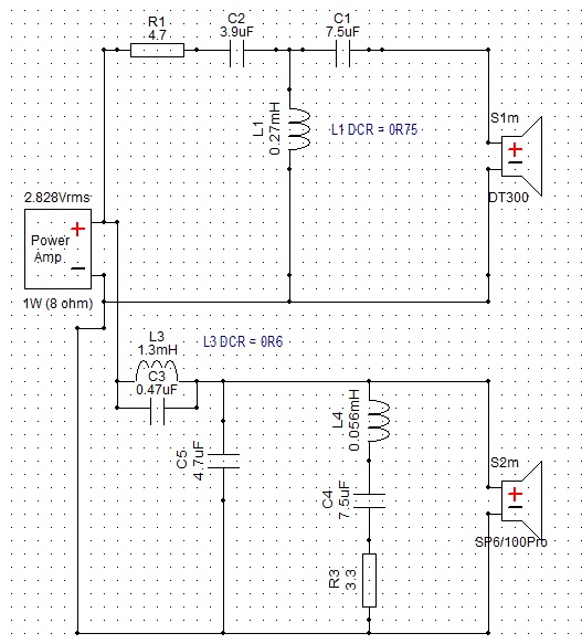

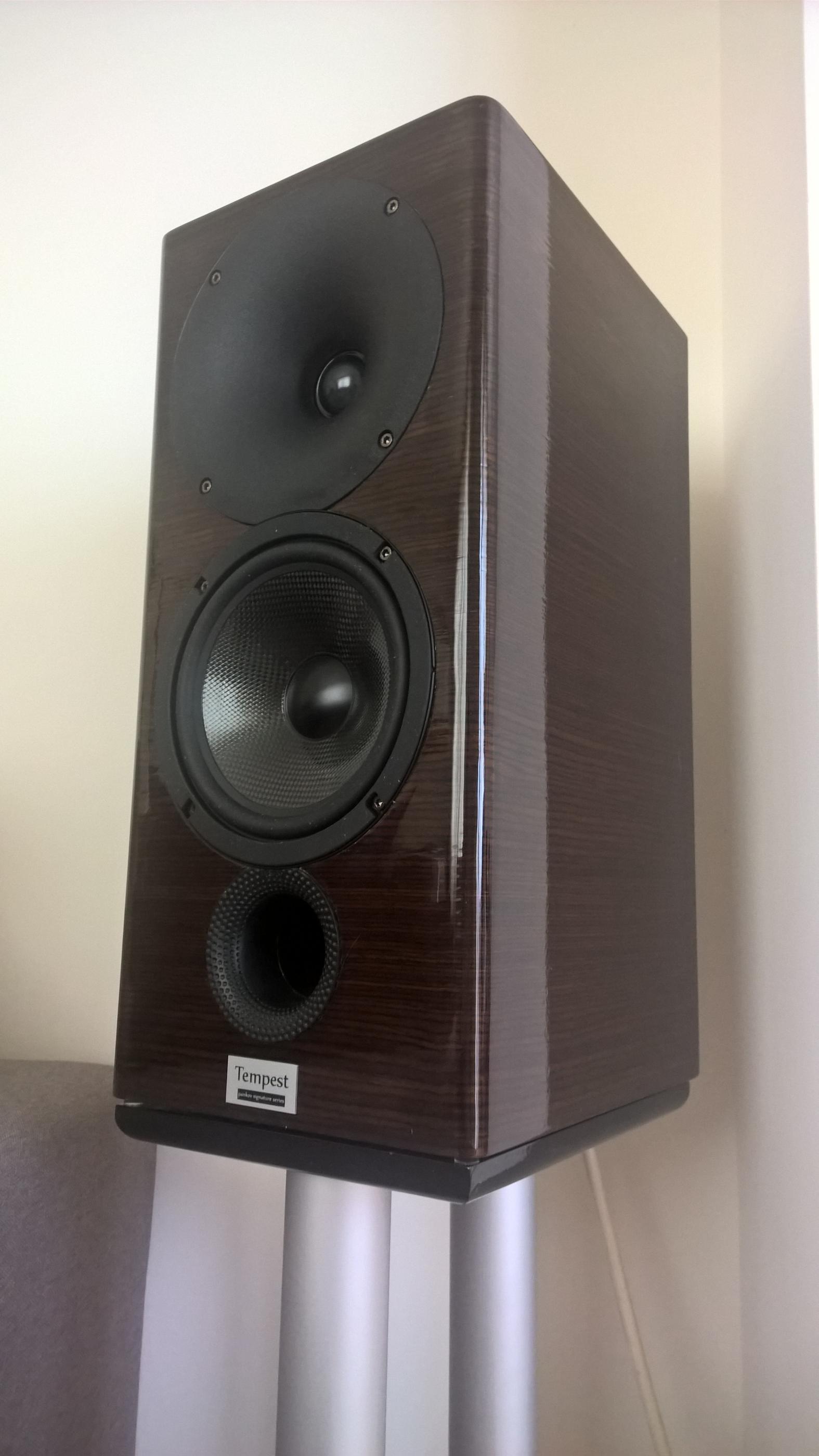

Below is a 2-way bookshelf using the SP6 Pro drivers, a DT300 with WG300. I will not go into further details on this one as I plan on posting it here in greater details, measurements, crossover and the plans but am really short on time and will probably do this during Christmas.
Very nice, Mario. Lot to like there. But really, without the filter, you are being coy.

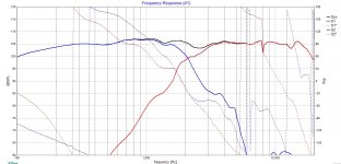

Here's a couple of types of SEAS: The Art Of Sound Perfection drivers that look flat (well, maybe overdamped) and easy enough. These work with simple coil and cap crossovers. But you can do better.
There is NO QUESTION that choosing drivers which are either flat or over-damped (bell-shaped FR) will make your life easier on crossover.

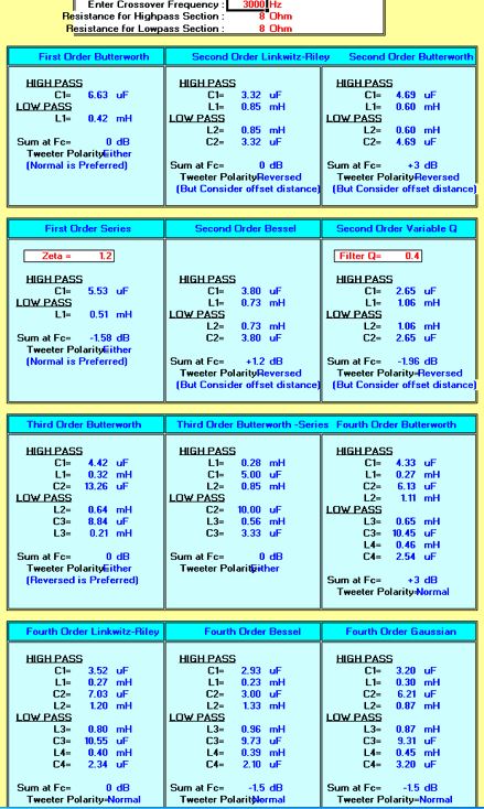

If you are very clever, you can get frequency response, power response AND impedance flattish. Phase is a bit driver dependent. 8" and 5" two-ways tend to be easy. This is one of the great secrets of loudspeaker design IMO. It stems from some very theoretical mathematics. 2-Way Crossover Calculator / Designer
The circuits below are heavily dependent on impedance equalisation, which is easily calculated from the impedance curve. Bafflestep is an extra consideration. I just wall-mount and avoid THAT issue.

Sweet looking enclosures of Mario's!

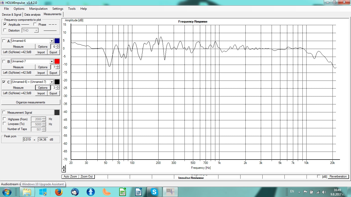

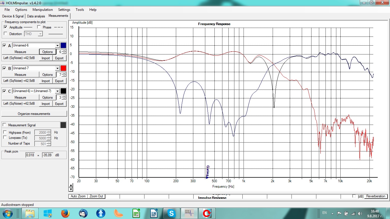

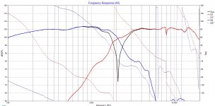

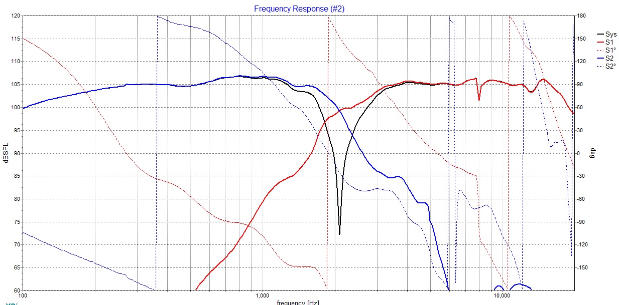

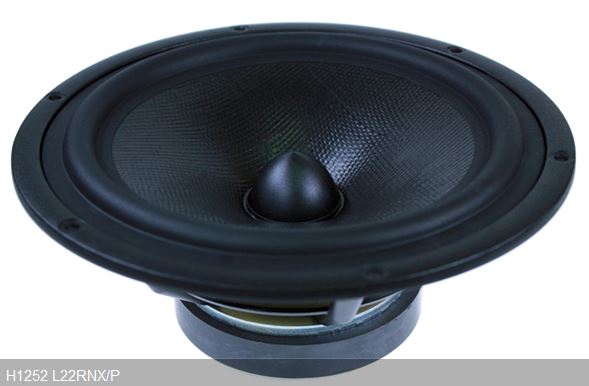

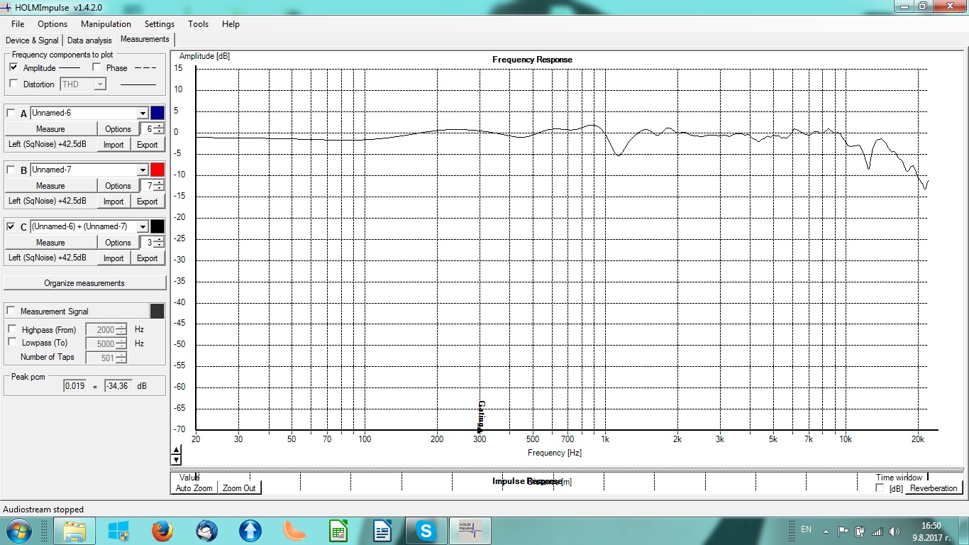

True but not much time these days. Here are some of the measurements but I wll post the real project sometime in January (I hope time will allow) with full set of measurements and data. But for now, at least this might do something in between. Minimum impedance is 4R44 at 183Hz with phase at 9.03 degrees. Enclosure is around 13l effective volume with port tunning at 48Hz. The overall tunning is set for corner placement as there they went and to be used with a subwoofer (I`ll post a photo of it too). The measurements include gated and a 12db smoothed in room response (my room, not the recipients) about 1.4m away from any walls. Crossover (measured) is at around 2.05Khz LR2 with both drivers connected with normal polarity. Measured sensitivity at 2.83V was 92.1db +/- 0.3db accuracy in the 100Hz-14khz band. The dip at 1.4Khz I suspect as suspension related as it is present on Monacor`s own measurements. The carbon-fibre cone has a light resonanse but is really annoying on-axis hence the additional network to address it.
They can actually do without a sub but if in a corner, otherwise sound a bit thin. The guy wanted them asap but will hand me over one to complete the off-axis and impedance measurements in a more digestable format, I hope at the beginning of next year. I don`t like to comment on sound as this is very subjective but the owner likes them.

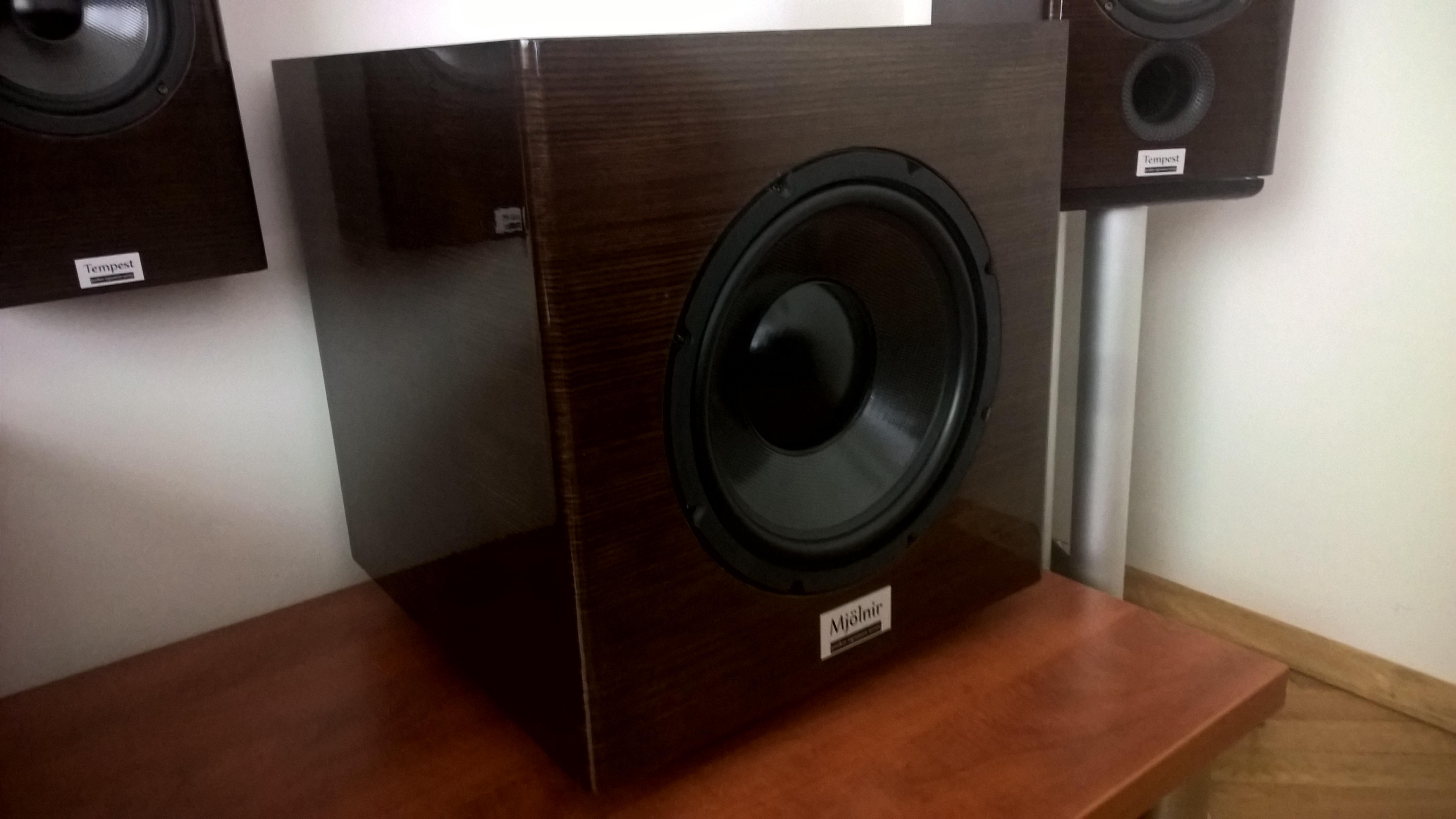

Here`s the sub, Monacor SPH-300CTC in a heavily braced 52l ported enclosure with downfiring ports (3 of them) tuned to 26Hz. It is driven by a Monacor SAM-300D (rebranded chinese amp, Madisound sells them under the Yung brand). Finish on these was a challenge as roundover radius (purely cosmetic in this case) is 12.7mm only but I found a way to bend veneer without cracking it by putting a few strips of paper tape on the outer side where the bend is. The whole cinema is finished in venge veneer and has a few coats of ICA polyurethane coating, a professional did it, was not me.
