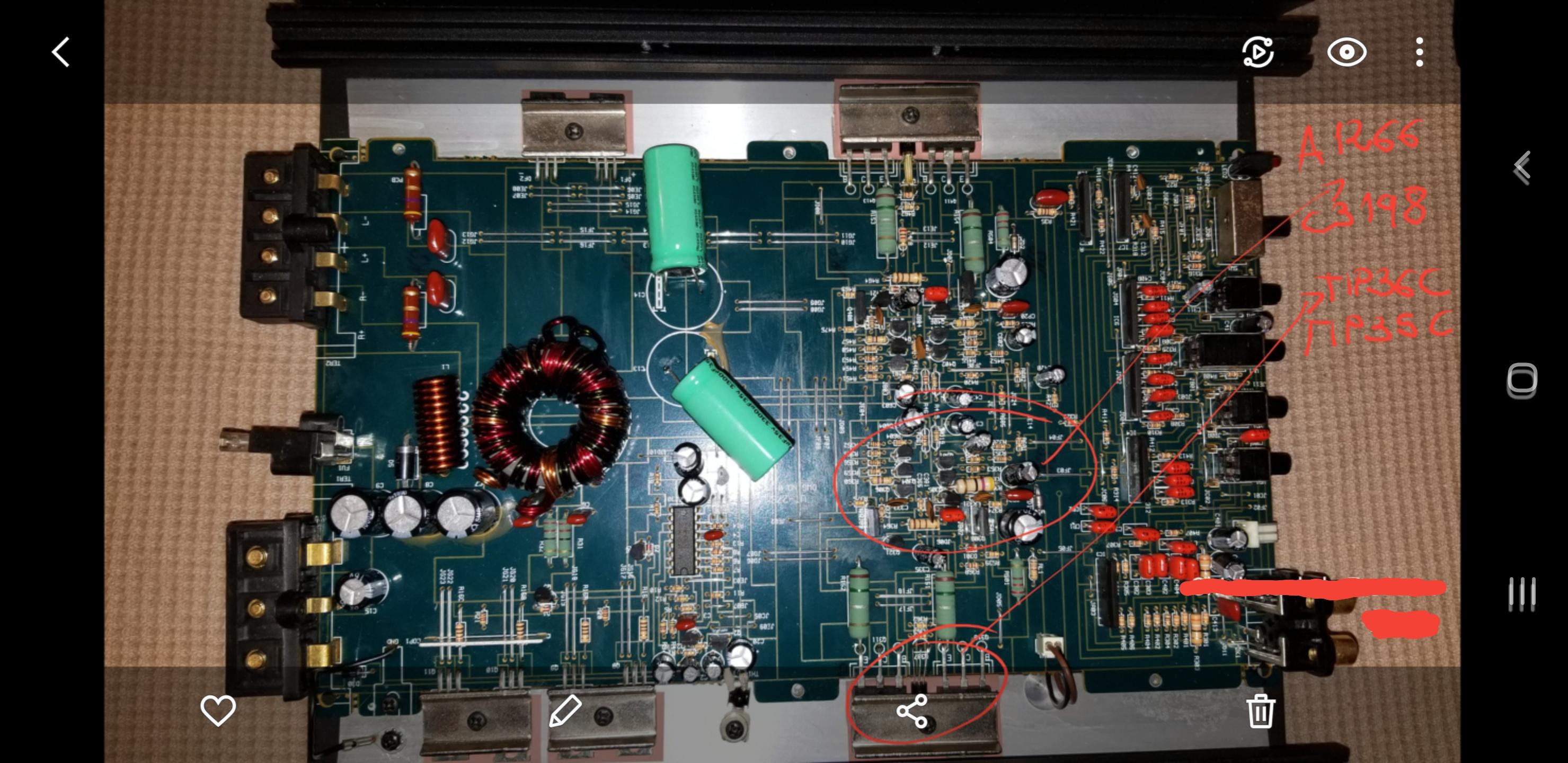

Hi everyone. I'm new to the forum and I don't know if I'm posting on the right site. The fact is that I have a Monacor Carpower Wanted 2/160 amplifier and I need the PCB schematic or a well-detailed photo. I tried to repair it some time ago and removed some components. And now I don't quite remember where they were placed.
Post a good quality photo of the component side of the entire main board and the component side of any driver boards if no one can help.
Hello everyone, I am sorry I could not answer before since I have been very busy and I could not post what I have been doing. I was doing some tests and I have managed to place the components in the correct way. At first the defective channel gave me 25v continuous and smoke came out of the speaker. But surprisingly, the speaker still works. In the end I replaced an A1266 transistor that was shorted and managed to eliminate the 25v. But now, the problem is that the sound sounds distorted. It is very strange because it seems as if it is You will hear only some sounds. I changed all the C3198 transistors and all the A1266 transistors of that channel and the problem continues. I have noticed that one of the amplification transistors, the TIP36C, of that channel is always cold. I have checked it with the multimeter and the readings seem correct right now i'm out of ideas.

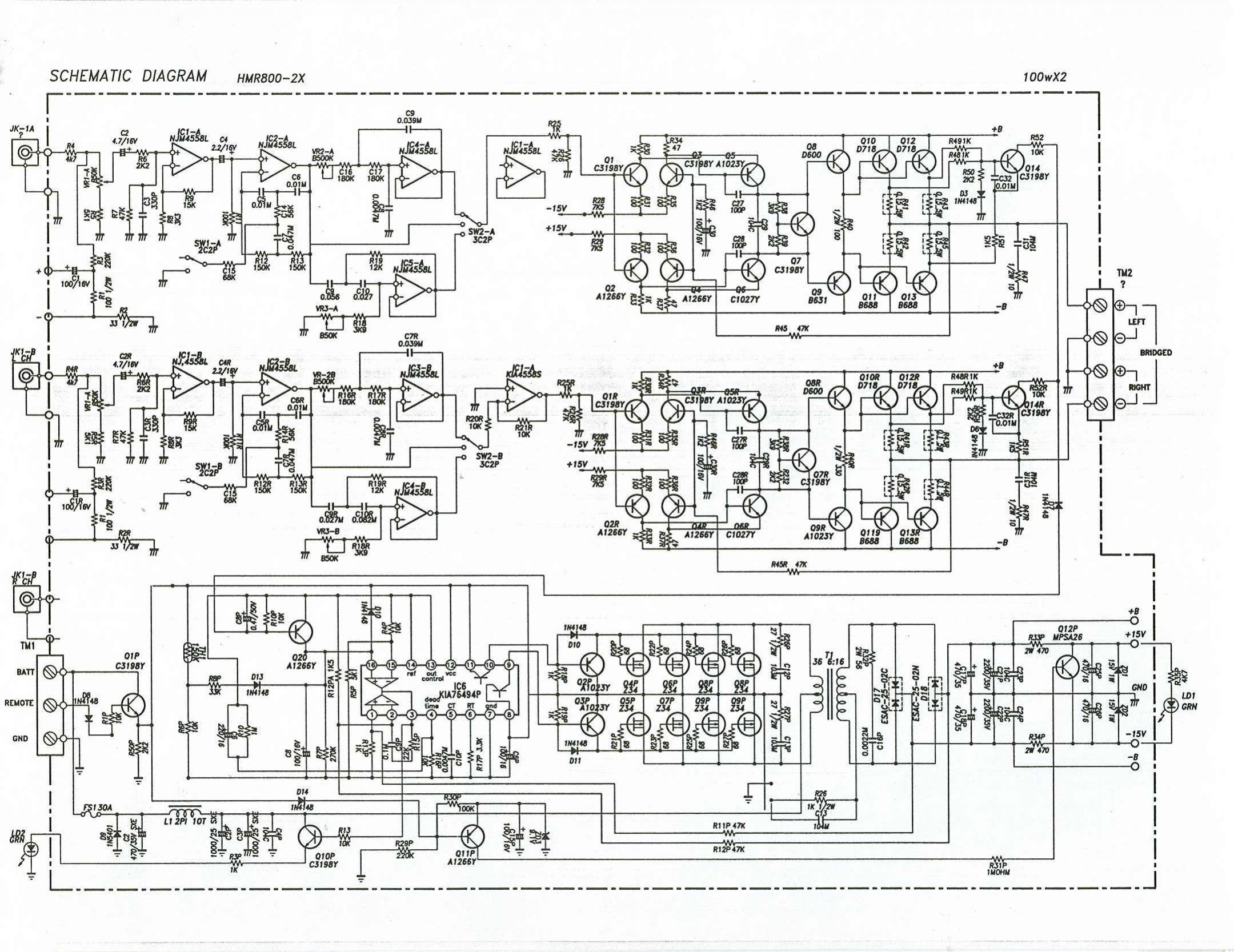

The diagram below is from a larger amp but the basic circuit for the audio section may be similar.
Thank you very much for the scheme. I don't have an oscilloscope. I only have a digital multimeter. What components should I keep checking? Could the fault be in the preamp stage? Could the bad sound be caused by an op amp? I have ordered the NJM4560L transistor just in case, on the other hand it is very rare that the TIP36C is always cold and everyone else is hot.

Hey, here you can find some photos from the amp.
Hope it will help a bit.
