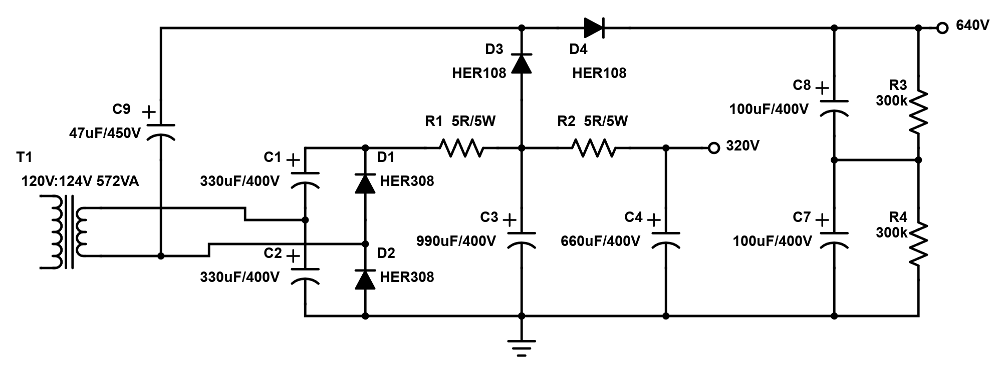

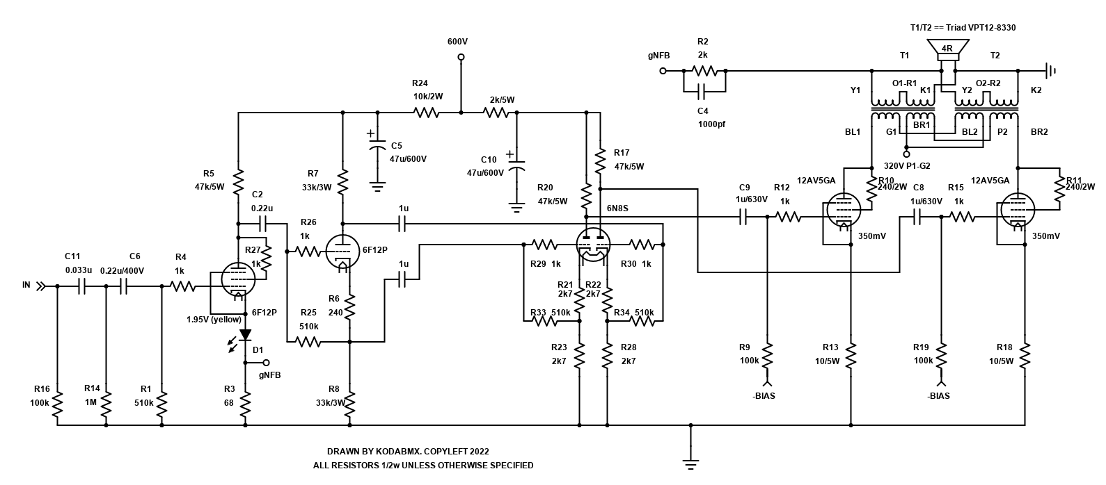

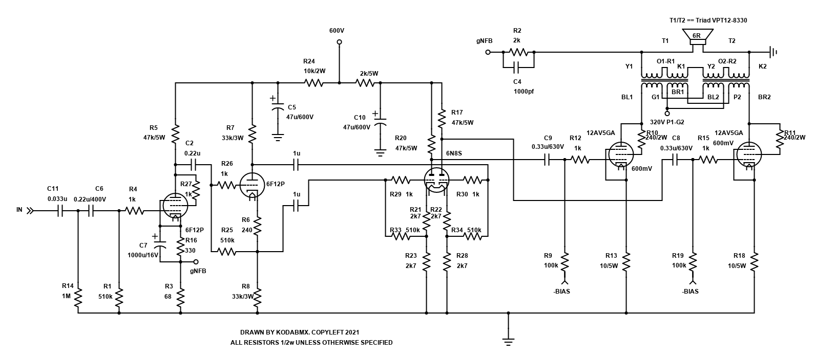

After a long time in testing and development, I present the Modular Amplifier 1.
It uses a 6F12P as VA/PI, and 6N8S or 6SN7 (12SN7) as driver, and your choice of over 100 different triode connected tubes for PP output. Beam/Pentode/Tetrode or UL can be achieved by connecting only one side of the screen resistor, too (the other side being connected to the screen supply/UL tap accordingly).
The tube list is as follows:
Modular because each of the above output boards share the same footprint and so are swappable.
The amplifier is designed to run from a voltage doubler/quadrupler from 120V (or single/double on 230V) using an isolation xfmr, and the output can use my interleaved Triad PT as OPT method.
The result is an amplifier varying from 10WPC to 80WPC depending on tubes and iron choices.

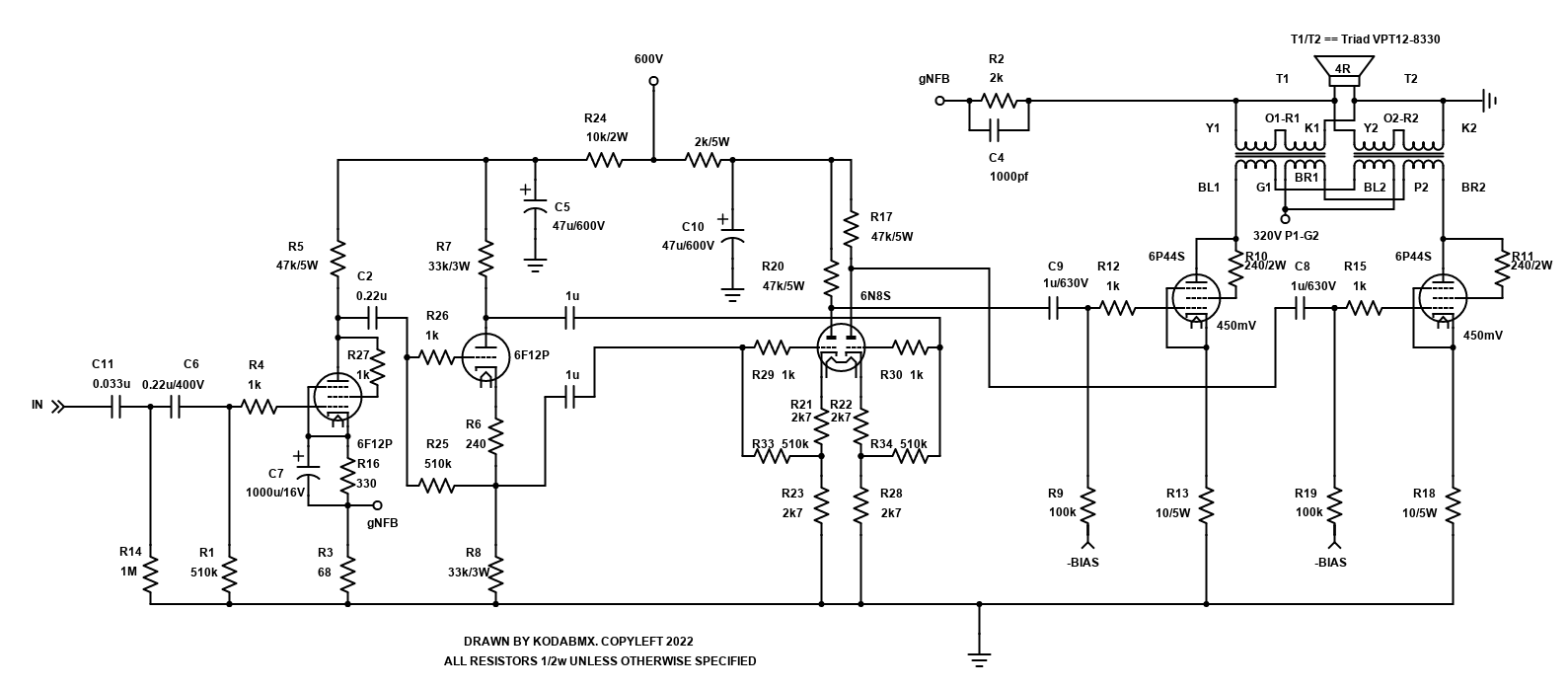

PCBs are available. Schematic attached. The VA/PI now use two 100uF/400V caps in series instead of the 47u/600V in the schematic due to availability and cost.

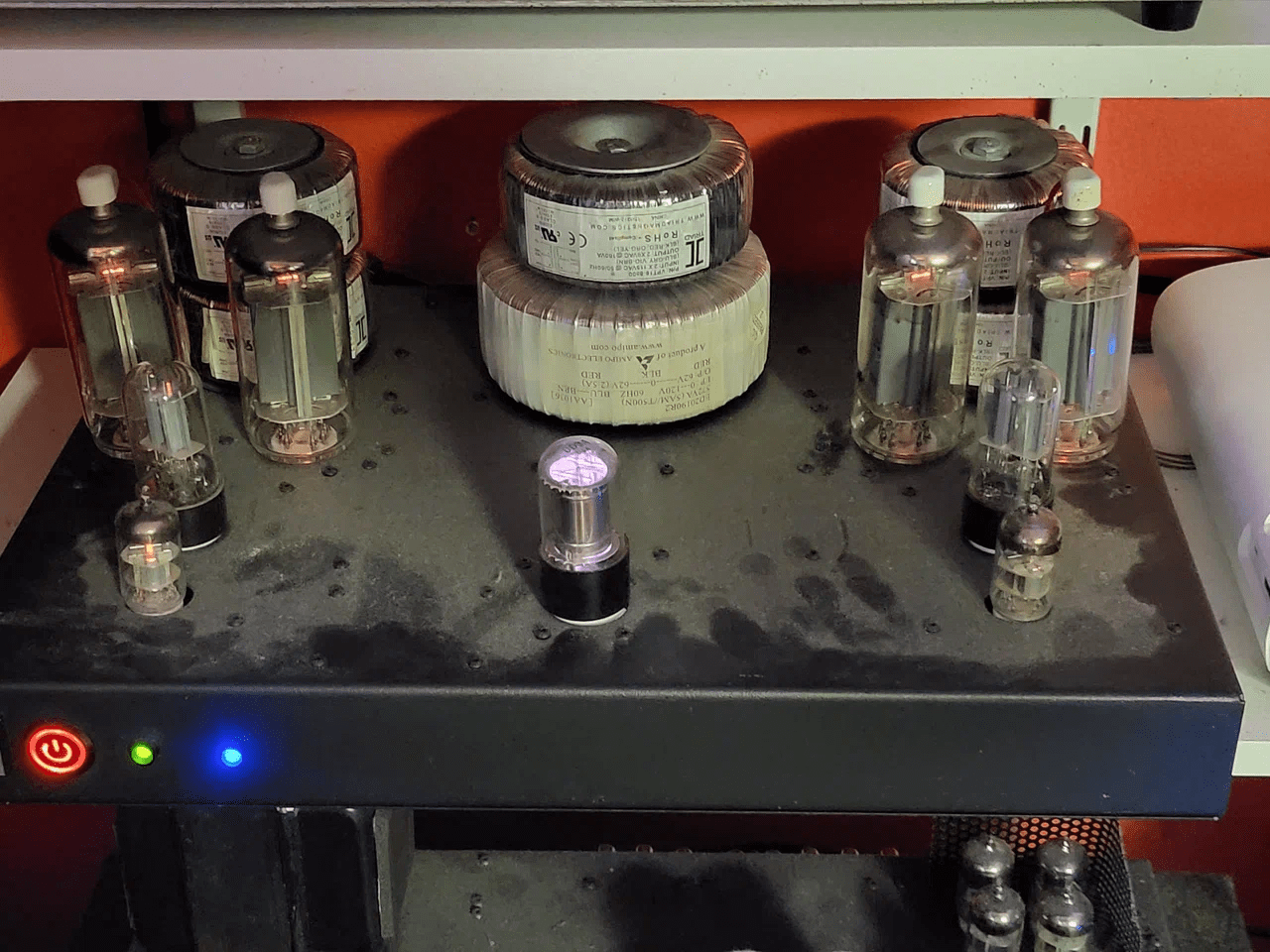

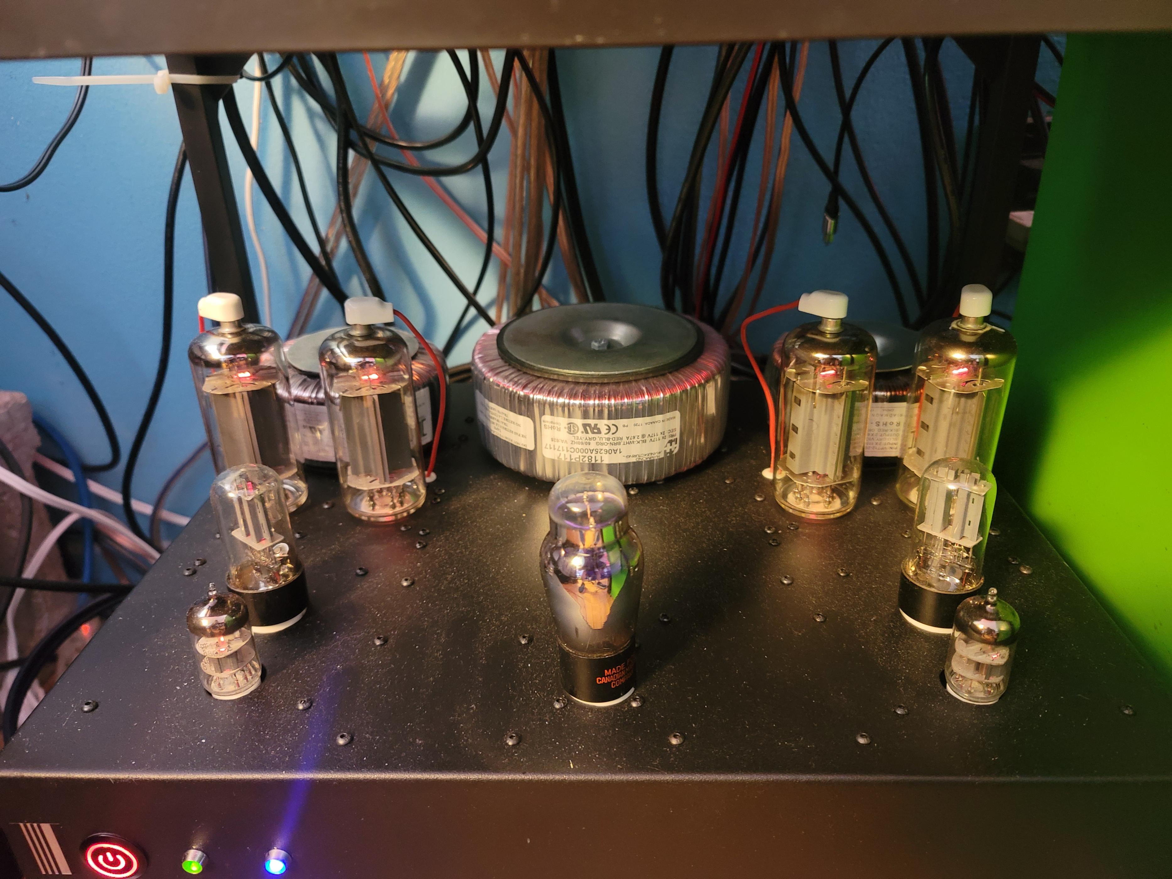

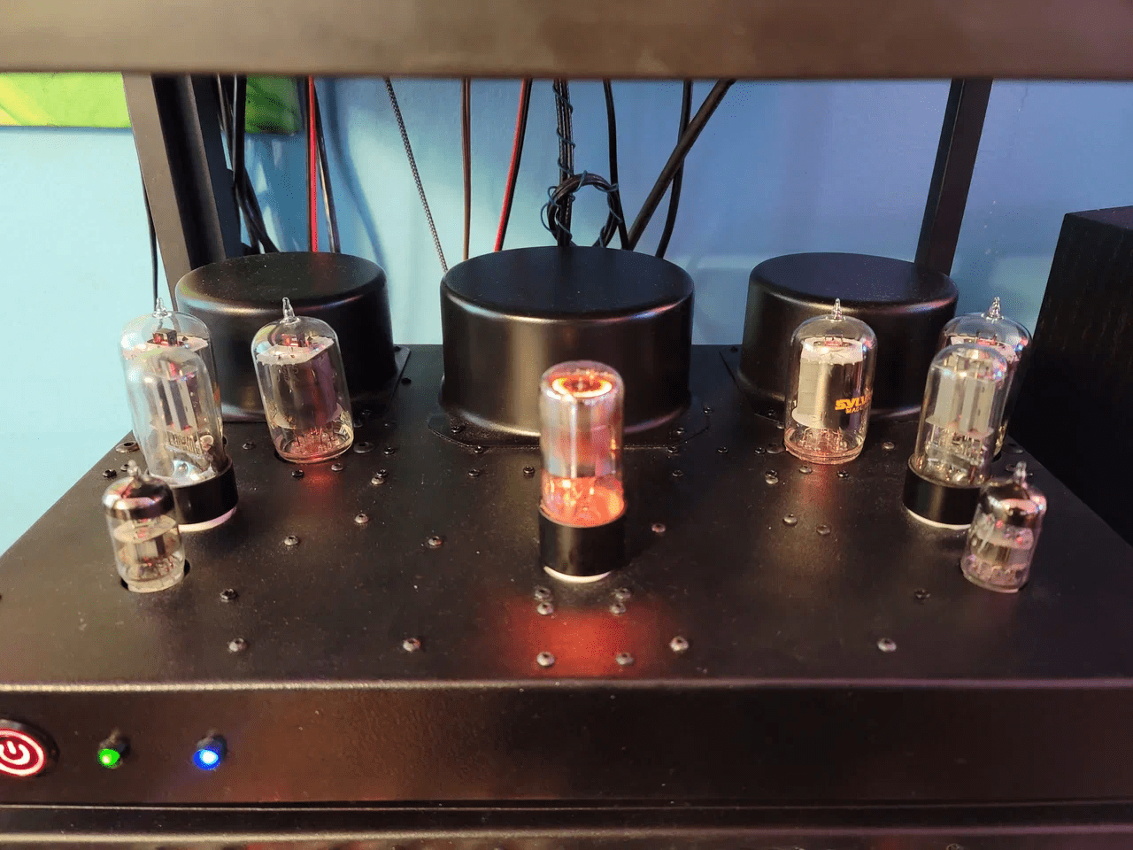

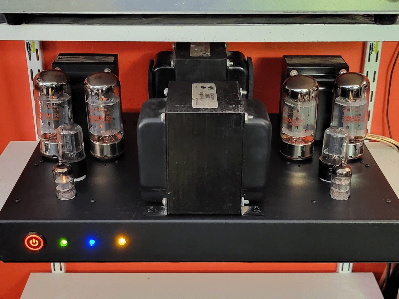

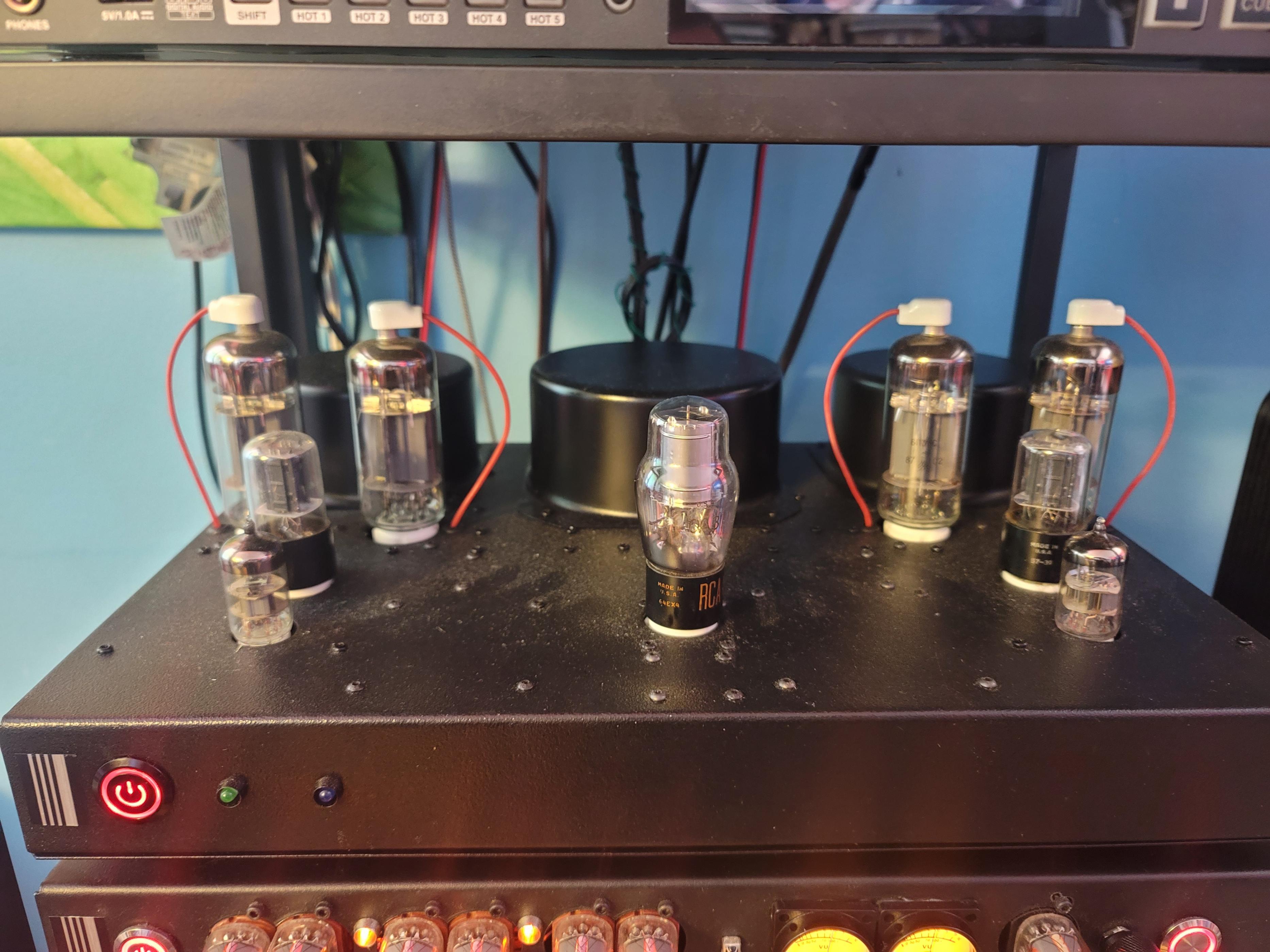

Pictured: 6P36S output and 6P45S output, and 12GE5 output.
6P36S is using a 250VA PT and pairs of 100VA for OPT. 80mA idle
6P45S is using a 625VA PT and pairs of 250VA for OPT. 100mA idle
12GE5 is using a 300VA PT and pairs of 100VA for OPT. 60mA idle (Sold)
Some power numbers (I will update as I continue to run more tests). All tests done with B+ of 320-340V with a 2k2 load unless otherwise specified, 1 kHz sine driving to the point of clipping and backed off 1/10th volt input, triode connection (* audio tubes need higher plate voltage and higher Z loading than sweep tubes):
6DQ6GTB: 24WRMS
6P31S: 37WRMS
6P45S: 113WRMS (1k3 load, 30Hz, 2 tubes parallel)
*EL34: 12WRMS
*KT88/6550: 15WRMS
*6P3S: 6WRMS
12AV5/12GE5/12GT5: 24WRMS

Question 1: What is the tube in the front center of the chassis?
Question 2: In a 6f12p are both the triode and pentode frame grid construction? Is there a data sheet available?

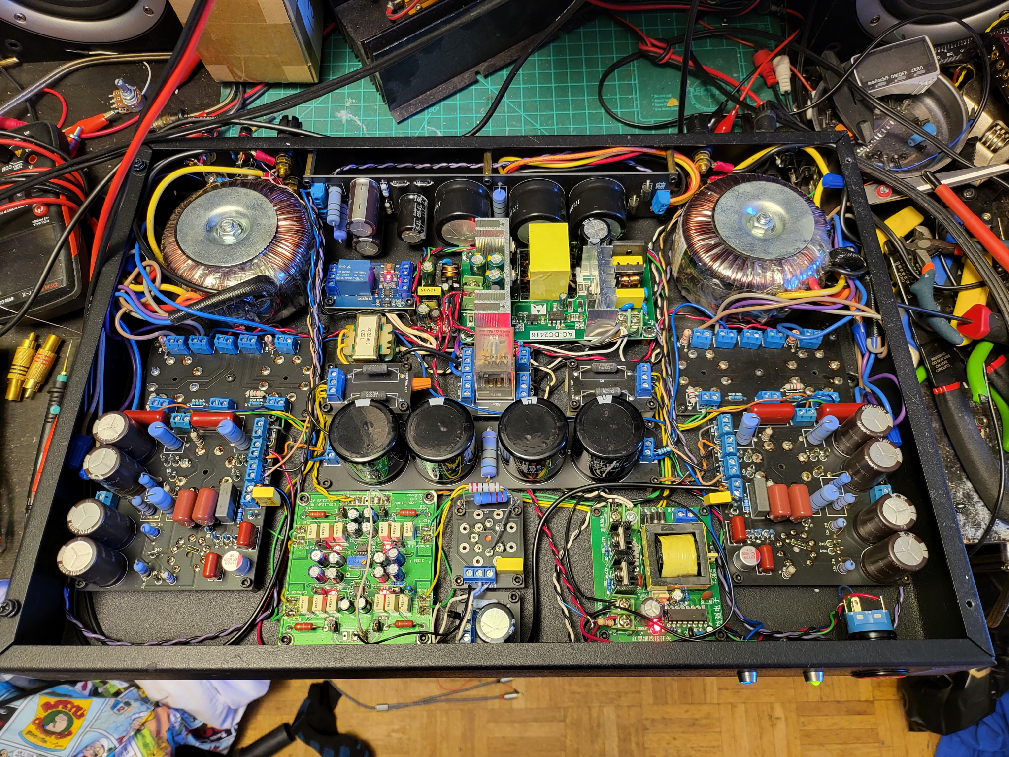

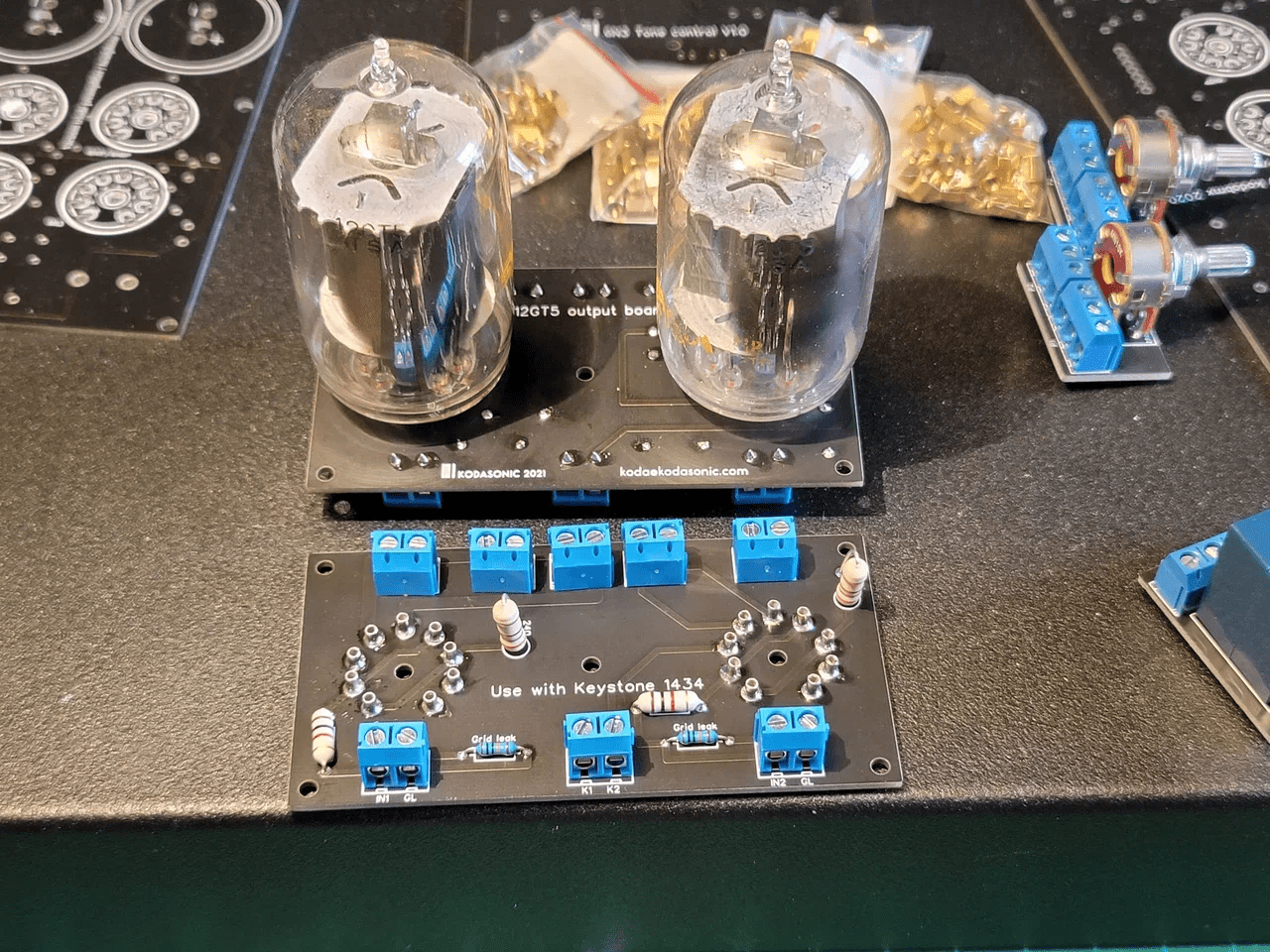

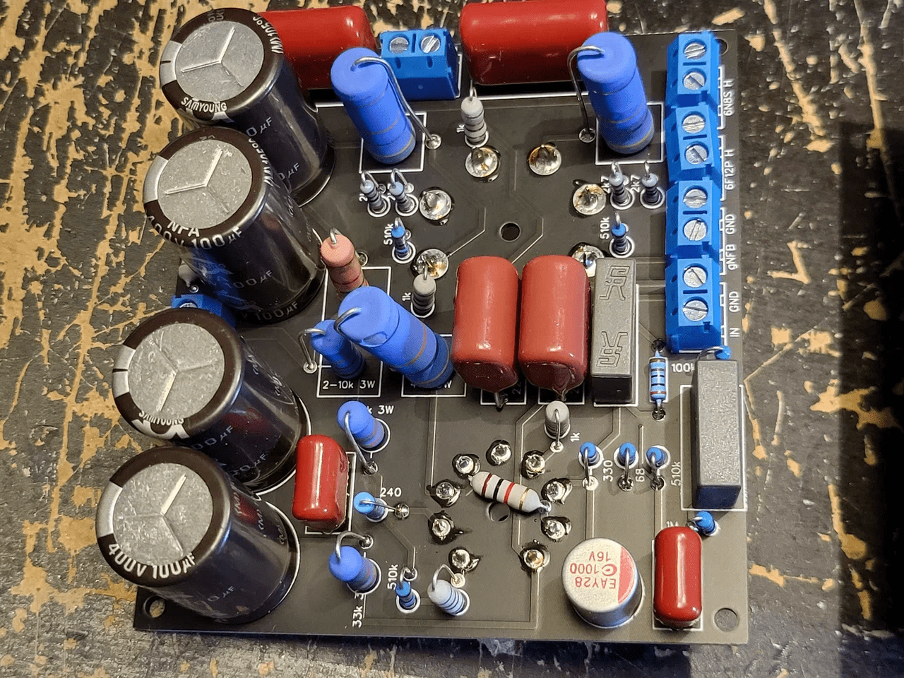

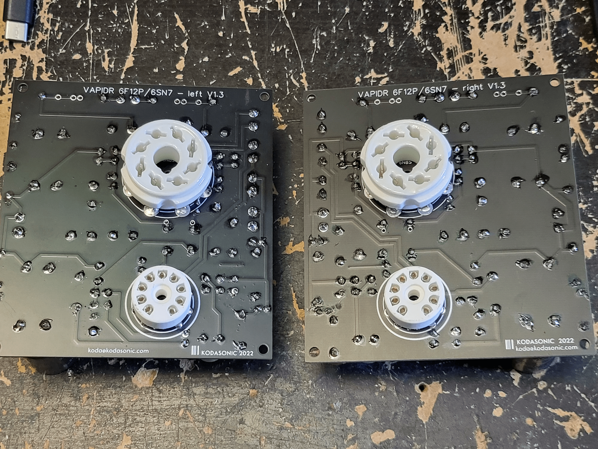

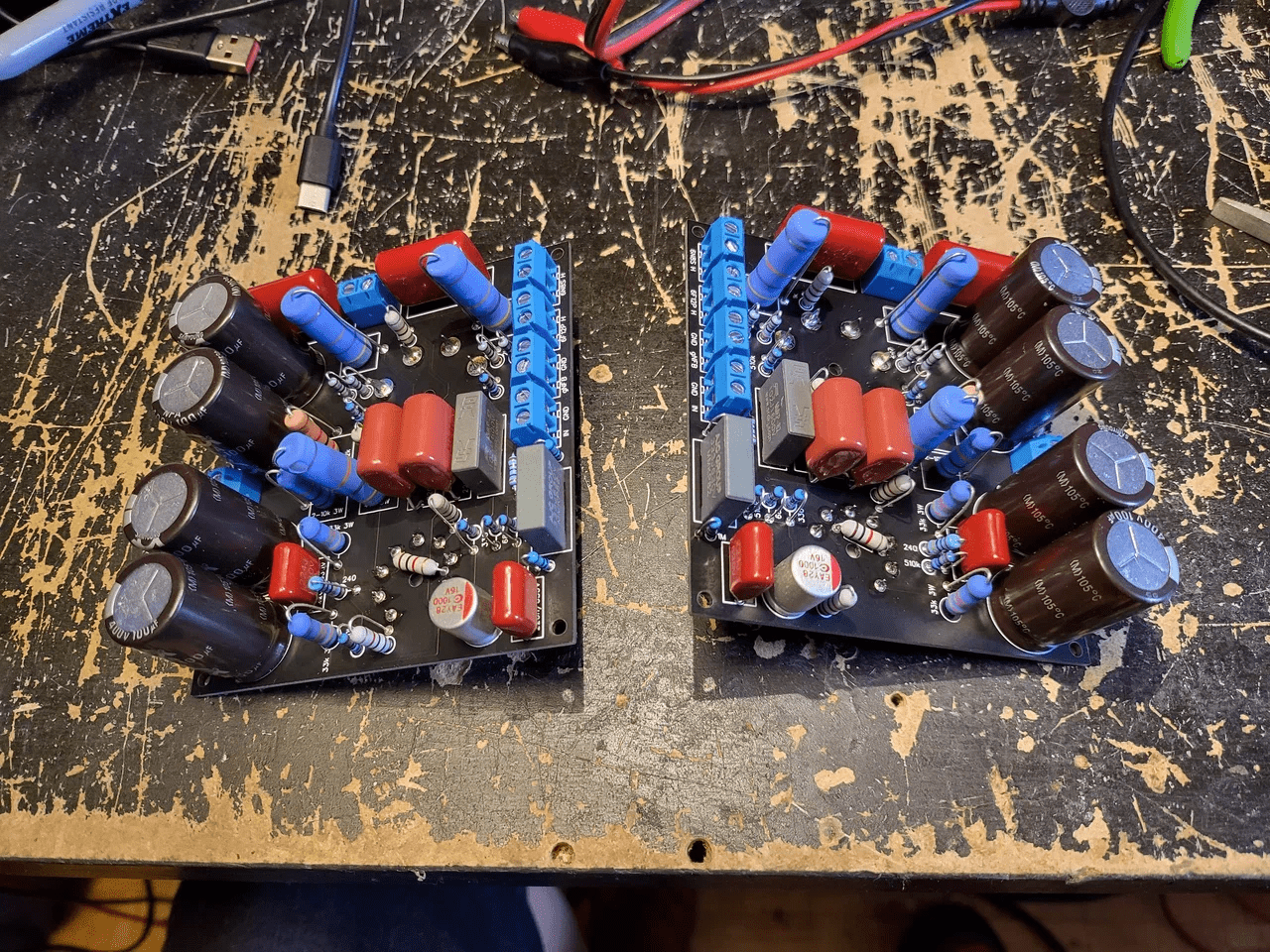

I will post more detailed photos of the boards, but here is a pic of the amp guts.
There is a PSU double/quad board at the back (120V in, 300V/600V out), a filter board in the middle, boards for cathode resistors, a pair of output boards, and a left and right VA/PI/Driver boards.
There is also a board for a VR tube to regulate grid bias., and an RC filter board. There is also a 110VDC relay that turns on main power when the bias voltage is present - if there's a bias failure, the amp won't kill itself.
As you can see, everything is mounted on little modular boards.
All my boards are black. The blue one is soft power on off, there's a 12V SMPS for heaters, and a DC-DC boost module to make -110V from the 12V heater which also powers the main power relay.
A complete set of blank boards is 50$. I can also build kits or complete boards.

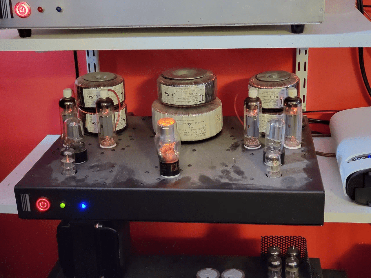

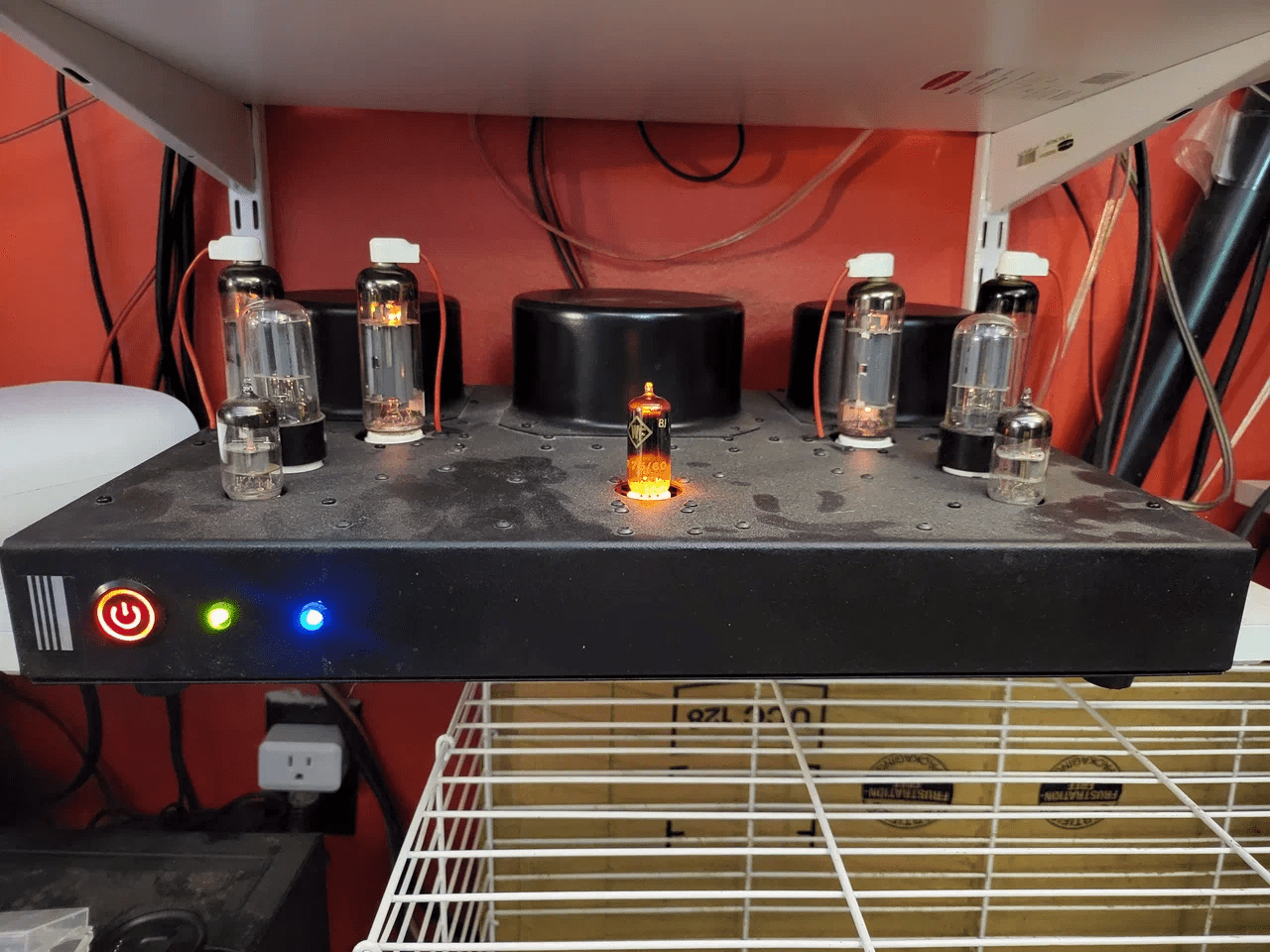

I decided to convert it to 6P45S because I couldn't waste a 572VA power transformer on a 20W amp. I put the secondaries back in series, and changed the VR tube and bias supply from 110V to 200V (jumper setting).
Almost forgot to add a 10k resistor on the interlock relay though -- ok I DID forget but the relay took 200V for minutes (instead of 110V) without burning out. Lucky!

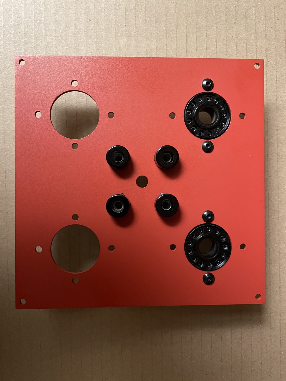

Swapped the boards on the 6P43P amp for 6P44S. I love how simple it is to use different outputs!
OP Triode 320V, 40mA, 2k2:6R loading.
