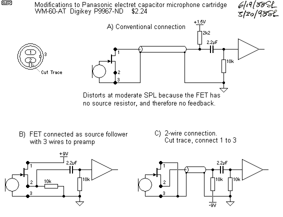

In reality you could do a Linkwitz modification, which results in lower distortion at higher SPL levels like drum and amp miking. There is also a claimed sensitivity increase.
Too much heat in soldering will destroy the capsule. Also, you will have to make a conductive strap or socket to connect the can to a wire, since that cannot be heated at all.
