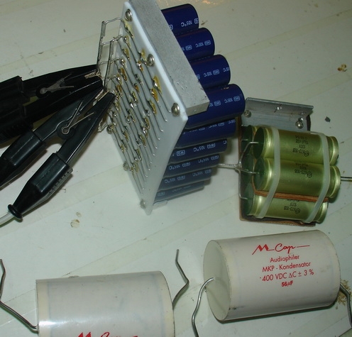

Here is my standard set of important caps for Zen-like SE class A designs. Main output cap is from low-ESR electrolytics (solid electrolyte), 68uF polypropilene shunt to it, 56uF polypropilene shunt at power rail after virtual battery circuit, 50uF mylar shunt for power rail before the virtual battery.
All this makes sense if one intends to get close to tube-like SE sound.
