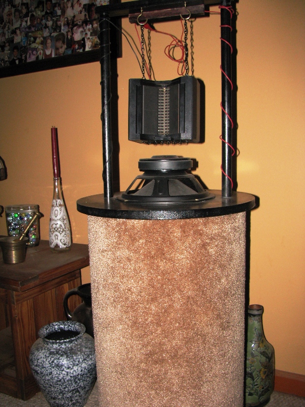

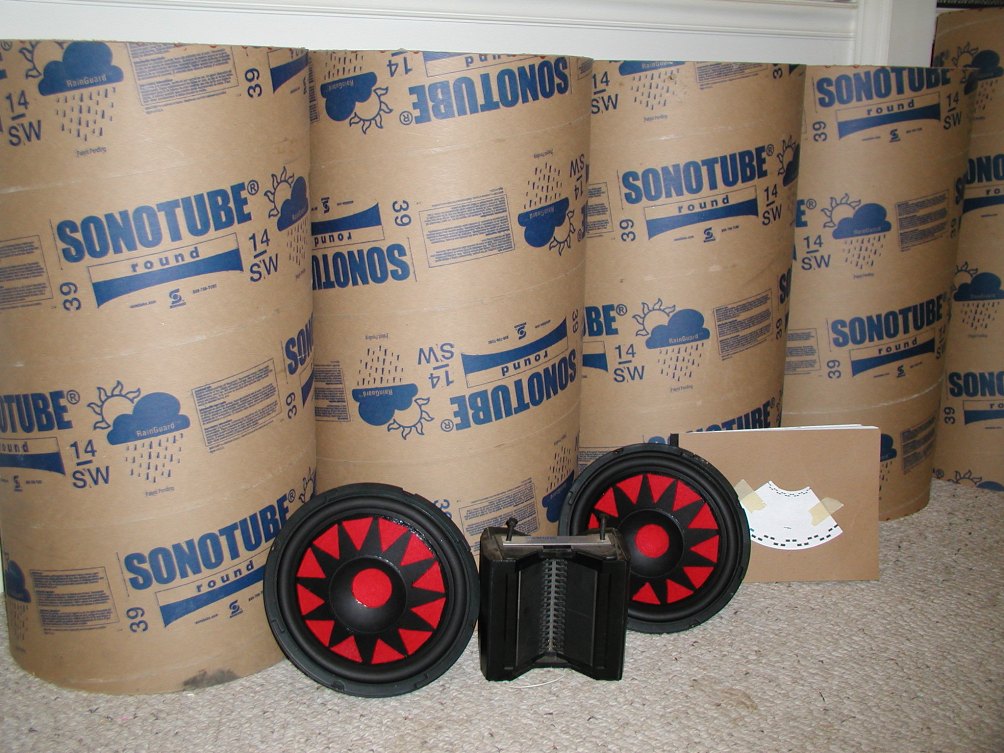

Wow, that is an interesting setup you have there. How does it sound?
Welllllllllllllllllllll - if you are a fan of Omnidirectional speakers I enjoy their sound very much. The AMT1's are clean and crisp without any "shout" that can be a problem with many other types of drivers. If you are new to "ribbon" - ESL - planer magnetic - transducers it will be heaven or hell depending upon your taste. YMMV The AMT's are a very open and free of distortion and allow endless hours of fatigue free listening. One of my final test for an acceptable speaker is how engaged with the music am I after an hour or two of listening. If I start out a listening session with music that I know and enjoy and am still sitting around having a blast after a couple of hours - well I think that I've a pretty good speaker on my hands. Heck - isn't listening to music and enjoying the experience what this hobby is all about???
The trick with the AMT's is finding some mids and woofers that will mate up with them. You need to use a responsive driver for this task and the best advice I can give you there is to look for one where the response curve is able to go a couple of octaves above your desired xover point.
Despite the claims about being able to go down to 800Hz I wouldn't suggest you try using the Heil's below 2kHz - take a look at this link and print out the PDF. http://www.hifisound.de/oxid/oxid.p...937/ESS-1-AIR-MOTION-TRANSFORMER.-SELEKTIERT/
I suggest that you keep your current xover to drive your mid-woofers and come off of your input terminals with a 20uf cap and 4 ohm 10 watt resistor (5 watts might be good) in series to the + terminal of the AMT.
