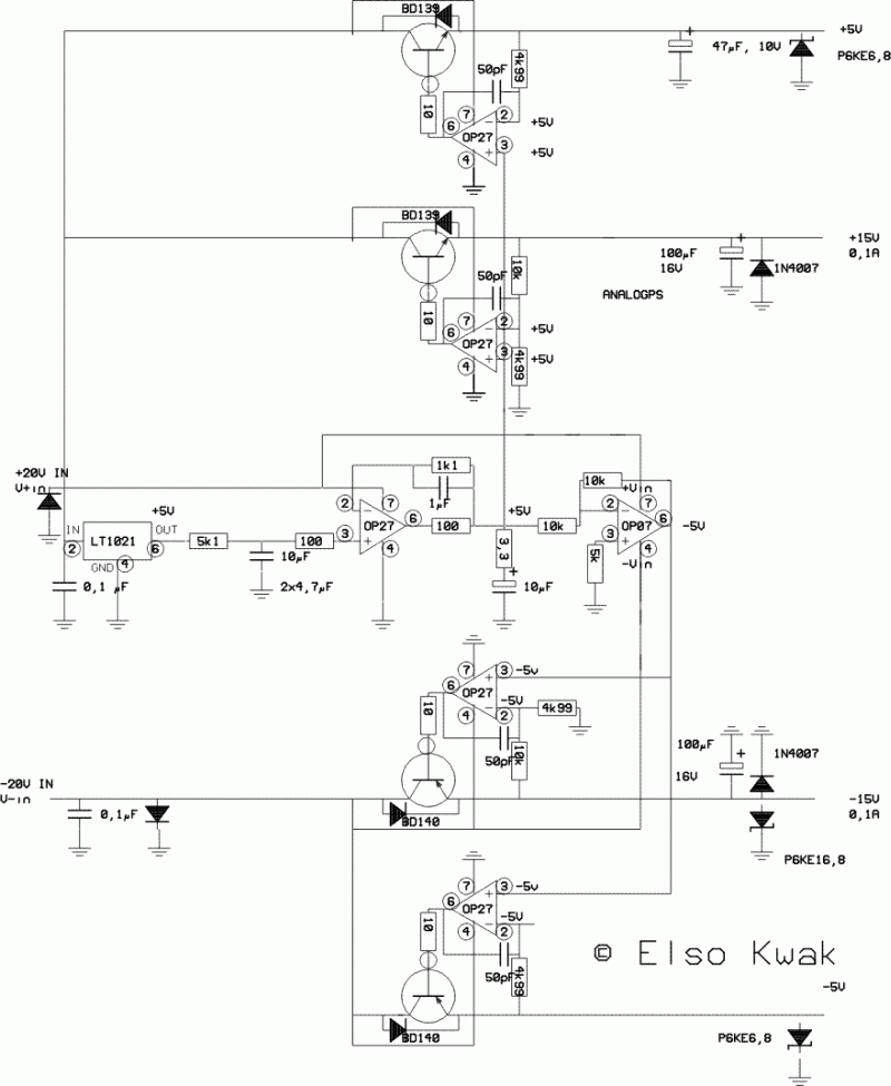

5 V reference
You can use a 5V reference with a gain of 1 amplifier. In other words the regulator must have unity gain then.
LT1021-5, MAX6250, AD586, REF02.
Dear Mr. Kwak, are you really sure?
The inputs will have the same potential as the output. You have common mode limits. I'll say 2-3 volts is better as reference voltage.

Okay, so I got the regulator to output 5V. Thanks moamps for the link... I didn't realize the U3 diode needed to be changed. Since I didn't have a 2.2V-2.7V zener, I improvised with a green LED instead. Would I see improved performance by using another diode in this position? Any suggestions?
Thanks,
Bryan
Thanks,
Bryan
Ideally the diode/zener make the output of the opamp to be at half of it's voltage swing and at least make sure that the output is under it's max value. A Led, any kind will do except for blue and white. 1.5-2 volts is needed.
bryman79 said:...I improvised with a green LED instead. Would I see improved performance by using another diode in this position? Any suggestions?
A green LED is just fine.
Milan
