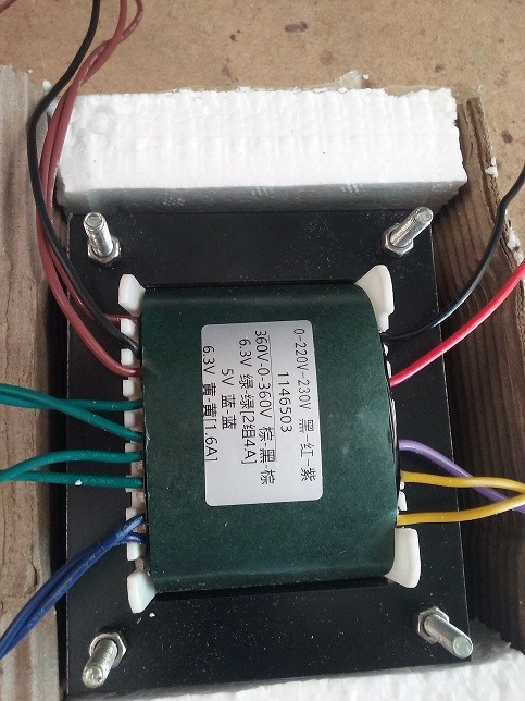

How do you know primary is 230/240V?
Please post a label picture.

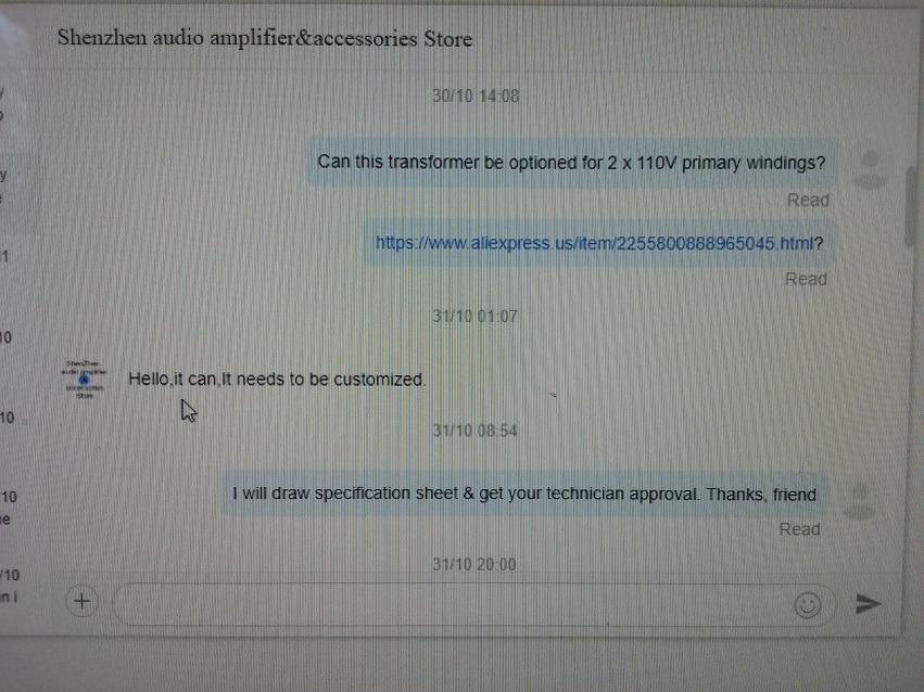

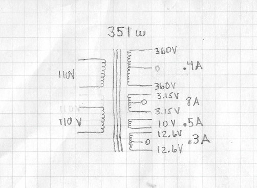

Diagram below was submitted at time of order. Ad said 220/230V 'default' primary, also said can be customized, so I messaged the vendor and asked at time of order- he said 'yes, can be customize'. Trafo came like pic shown- Label shows 220/230V. Ohm'ed out windings and located primary, then measured voltage @ all secondaries. They weren't right either...👎Opened dispute to no avail (so far)👎 Moderator said I need to follow the wiring instructions... of which there were none. It's an ongoing case- promised the vendor I won't flame them if we can come to some type of settlement.

That transformer in NO WAY meets your specs.
- WHERE is the 10V center tapped winding?
- WHERE are the 2 x 110V primaries?
- WHERE is the 6.3V 8A center tapped winding? Label mentions 1.6A
- WHY are all labels in Chinese with NO English ones nor an accompanying sheet?
- WHO asked for a 5V winding?
- WHERE is the centertapped 25.2V winding?
- WHO asked for TWO 6.3 windings? (by the way,of insufficient current).
You have been conned, pure and simple.
To begin with, start a dispute through your credit card bank and STOP that payment.
There is NO "wiring instruction" in the World which allows that ... thing .... to be wired per your drawing design.

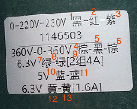

Ok,I had my Polyglot Son translate the Traditional Chinese symbols.
Which does not fully clear the mess, at all, that transformer in no way matches what was ordered:
1 -5 : BLACK
2 : RED
3: VIOLET (PURPLE)
4 - 6 : BROWN
7 - 8 : GREEN
10 - 11 : BLUE
12 - 13 : YELLOW
9 "is not a colour" , it means something like "group/arrangement/set" so it might mean "2 sets of 4A" (each)
I guess it helps know better what they sent, which in my view is NOT what you asked for.
Even worse, Language problems aside, it does NOT match your SCHEMATIC, which is "universal" 🙄

Even WORSE: some colours are repeated in different windings,even opening the path for DEADLY mistakes, such as:
* BLACK is used both in Mains Primary and Secondary, it is both Mains start end and HV center tap.
* Apparently there are two sets of 6V 4A windings, all 4 wires are GREEN, no indication of phase whatsoever, or even belonging to the same winding.
"Wiring diagram" my 4ss.
* The 5V winding for your Tube Rectifier has the proper colours ... pity you din´t order it 🙄
* The 6.3V 1.6A is reasonably well identified, pity you didn´t order it either.
* NO centertap for the 6.3V winding and of course fully missing center tapped 25.2V winding.

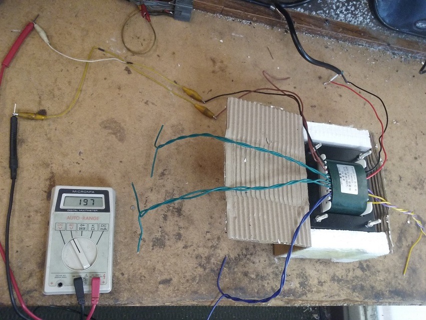

Ohm'ed out the windings and figured out what was what. Tell you son thx for translating-Ok,I had my Polyglot Son translate the Traditional Chinese symbols.

Looks like trafo was not customized in any way- Basically off the shelf chunk- see below screen shot of sales rep's response to my primary winding Q-

on the other side, you ordered and paid for an off the shelf standard pre-made item,
of which there are stillEL34 KT88 6L6 electronic tube push-pull circuit universal EI power transformer, 350W 360V-0-360V 0.4A; 6.3V 4A; 6.3V 4A; 5V 4A
1 order
US $61.66 - 64.66
and they sent exactly that, the label matches above description to a T.391 Pieces available

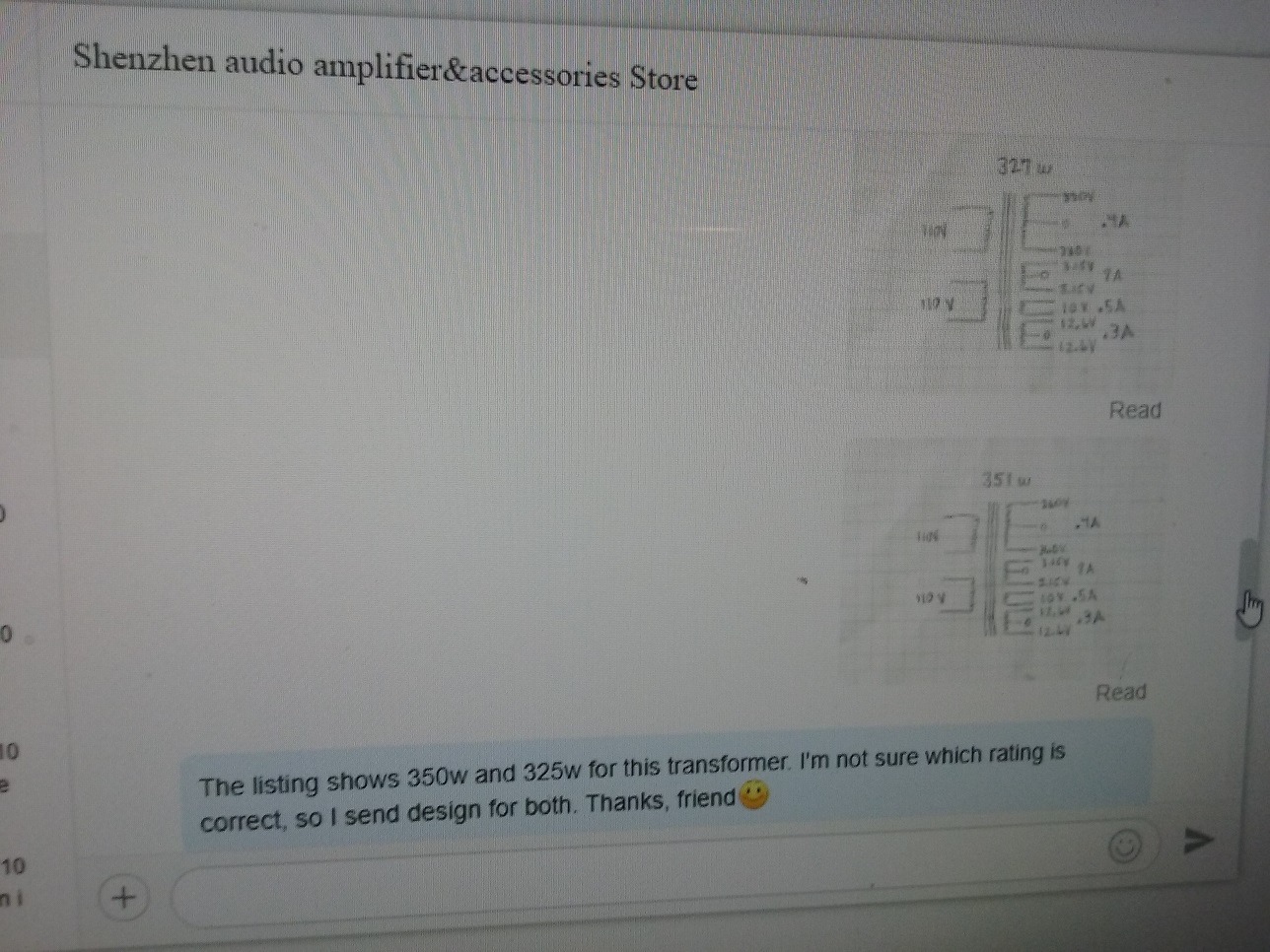

So the problem boils down to: did they clearly acknowledge your custom design drawing or you just assumed they did?

None of that justifies sending the wrong transformer. The OP clearly sent the transformer description in a picture. No language issues.
